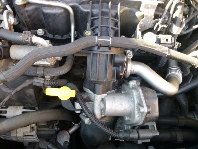

Hi Piph, I wasn't going to block it off completely (CAYB) just fit a gasket that had a smaller hole so the build up was slower, I have seen some looms that cancel/emulate the EGR when you fit a total blank but I don't fancy that, It looks like I will remove the EGR and cooler, split and clean it and look at fitting a separate crankcase/oil filter again to reduce the build up, It looks as though some of the gaskets are the same as my Scout (BMM) so I could buy one with a reduced hole size, I will give TPS a bell and see what they can offer, for clarification what's the device at the front of the engine just before the metal pipe from the EGR enters the inlet manifold -
Removed it to clean and check and its the throttle body !
