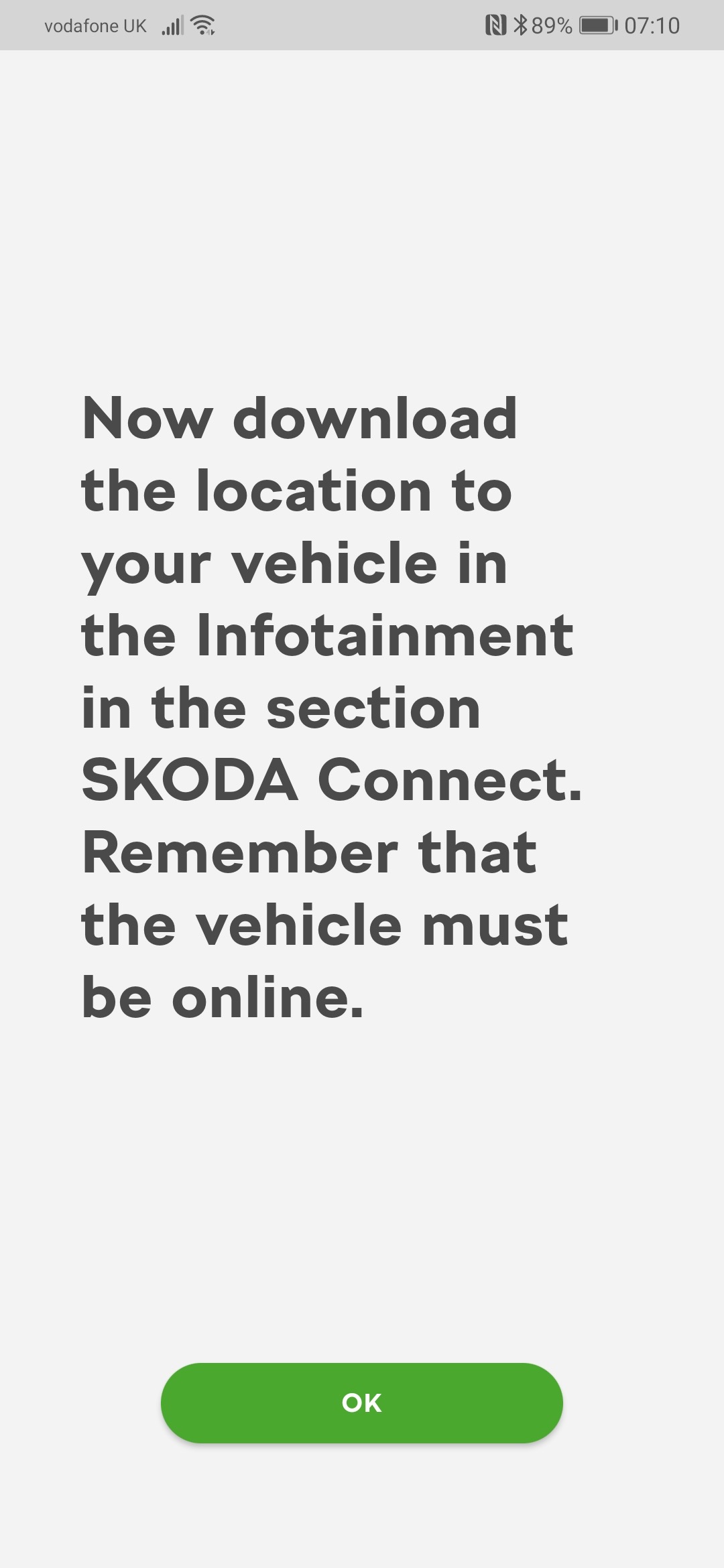

My Skoda app works and I can create the journey there, getting to the option to send it to the vehicle and receive the attached screenshot.
The problem is that there is no “Skoda Connect” section on the Infotainment system (that I can find).

I just tested this on my vehicle and nothing arrives on the Satnav screen you mention, other than the searches I do on the Infotainment directly.
Out of interest, do you have MIB3 too? If so, are you using the on board eSIM or are you tethering to your phone for data?
