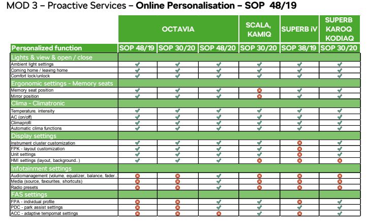

I've now heard back from Skoda UK, but with bad news, as expected.
They have explained that there has/had been a "misprint" in the documentation and website when providing information for customers on Kodiaqs.
Despite what all the documentation said (says), most of the Key Personalisation relating to the Infotainment does not work on the newer models, evidenced by the attached, which they kindly provided me.
I'm not sure how they can claim it as a misprint when my poor dealership invested at least 40 workshop hours trying to get these features working on our MY21, MIB3, Columbus vehicle.
For us, one of the massive benefits of the Personalisation was that we could use our specific keys and return to the car with the Infotainment layout being as we left it, radio settings and all.  Alas, there's little hope of that now.
Probably because the new MIB3 system seems rubbish compared to the older versions as far as I have worked out.
Many things that people with the older version can do don’t seem to work on the newer version, and I don’t think it has been tested that well with all the issues people seem to have with it

manually
■ Automatic - detected vehicle key automatically assigned to a different account
of the active user account
■ Assign vehicle key to current user account - manual assignment of the detected vehicle
key to the active user account - follow the instructions on the Infotainment
screen
Specially the last one!
Reset all keys and assign each key to according user account (you need to hold Unlock buttun when assigning).
