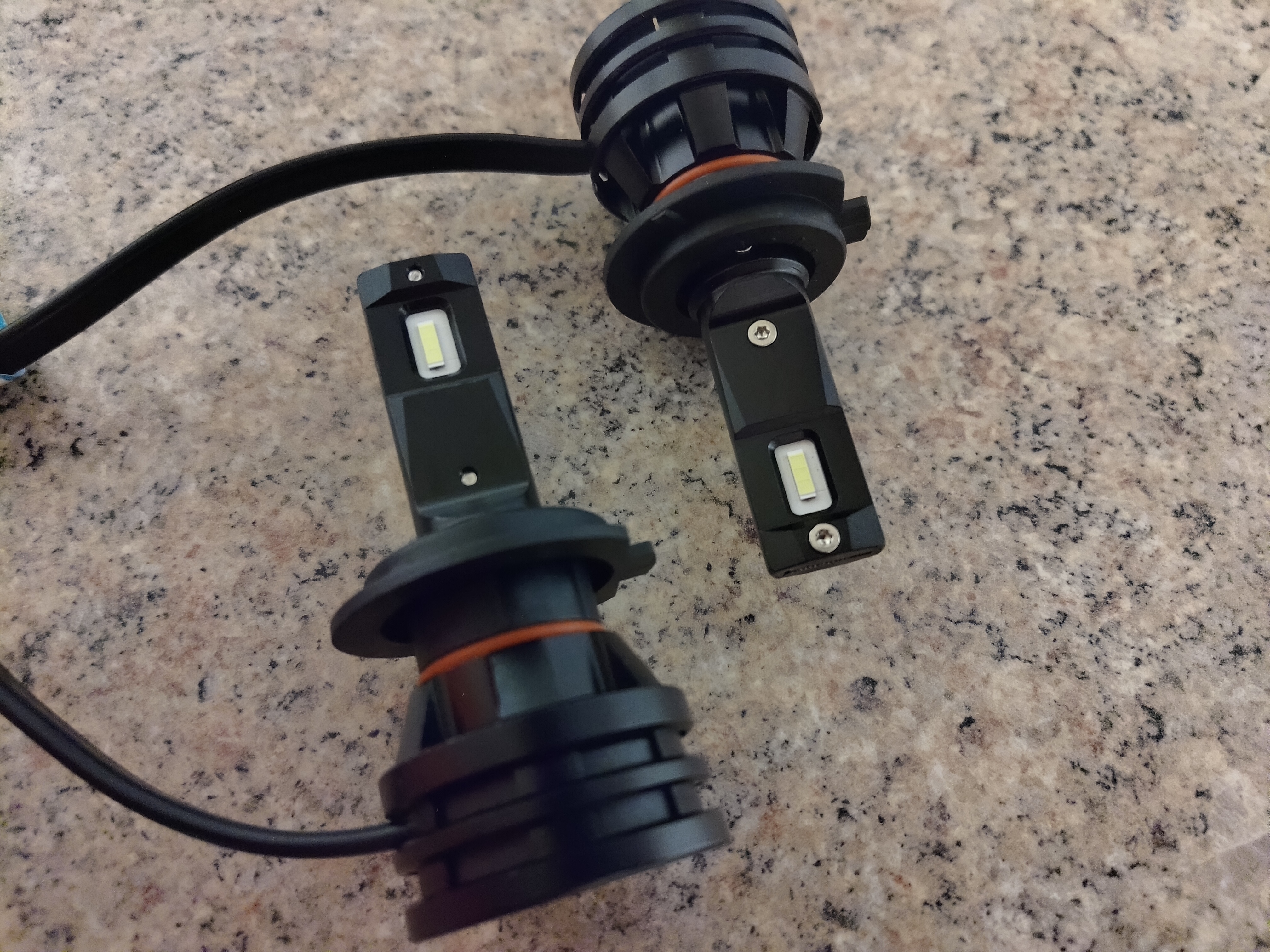

I have these, had them for 2 years passed both mot's, light output is excellent, has a nice flat cutoff point (reflector housing) Just adjust headlight aim and you're good
I have considered some for the main beam (admittedly) more for the quick flash and look....... But always thought they looked bulky to fit
I do alot of night driving and wouldn't be without them. These particular units will fit in place of the factory bulb with any modification.
As easy as normal bulbs to fit, instant off/on. If you can here the tiny fans over an idling engine you've got some magical ears.
