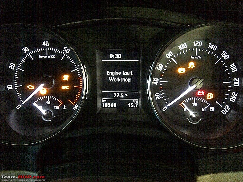

The maxi-dot saying - workshop usually means a fault.
did it look like this?
My display is slightly different from yours. All I can remember was the first line of the message was workshop. Also between the mileage and the trip a light came up. The consumption screen was all over the place that's when after about a minute or so the message came up. It has not affected the driving. When I attached my code reader it did not show any code.
Being a new car I had just bought I was checking out the buttons and switches I just wondered if I set something up wrong. Still not used to everything on the car.
Do you know of a website that helps with getting to understand the computer data. Can you do a factory reset?
