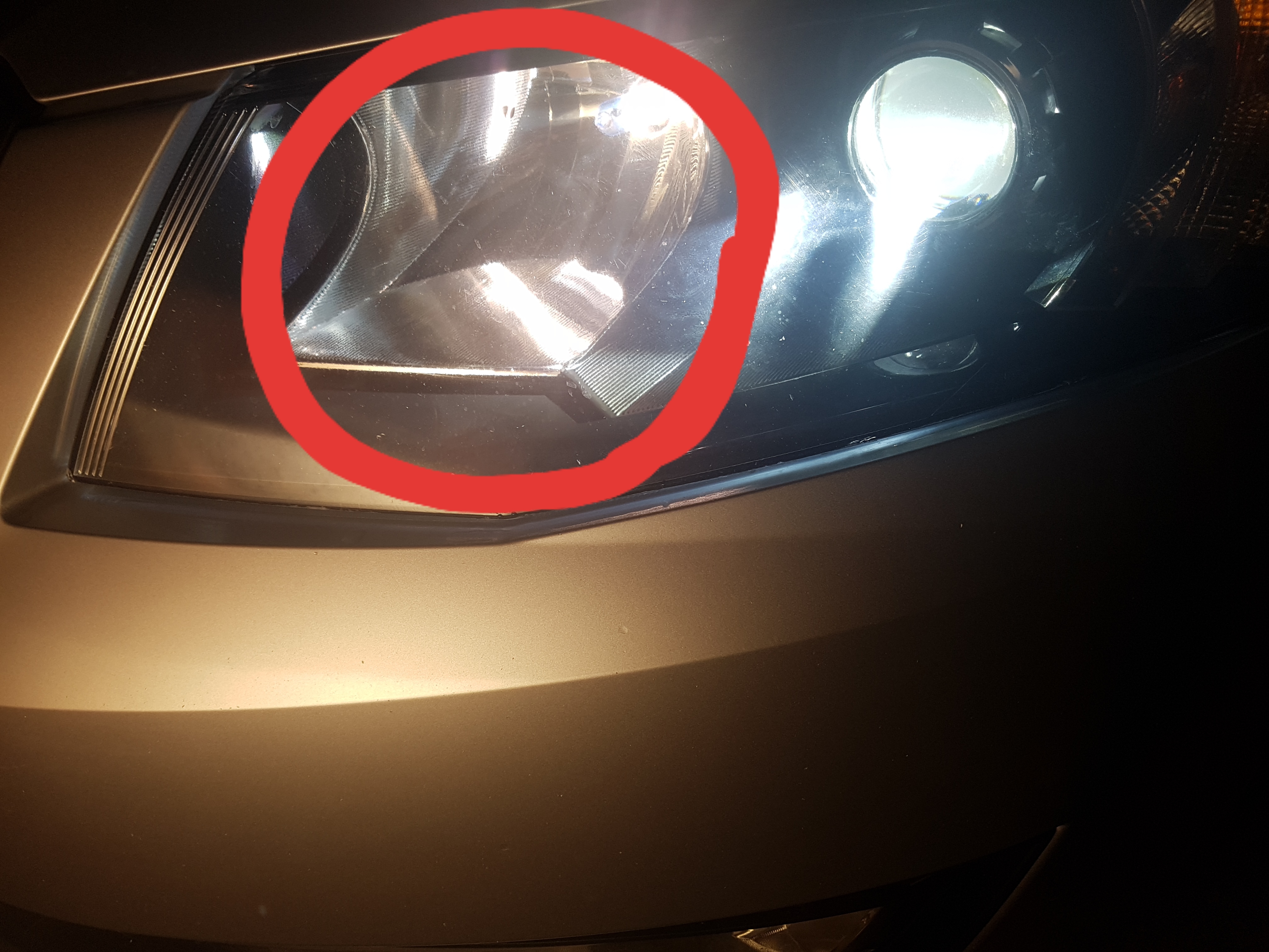

I put the magnifying glass in the headlight and I would like to deactivate the light bulb h15 so that it does not light up when it is short phase does anyone know what needs to be modified in vcds?
The H15 bulb is a dual filament bulb - one used for DRL and the other for high (main) beam - neither for low (dipped) beam unless the BCM leuchte channels have been changed from factory settings.
