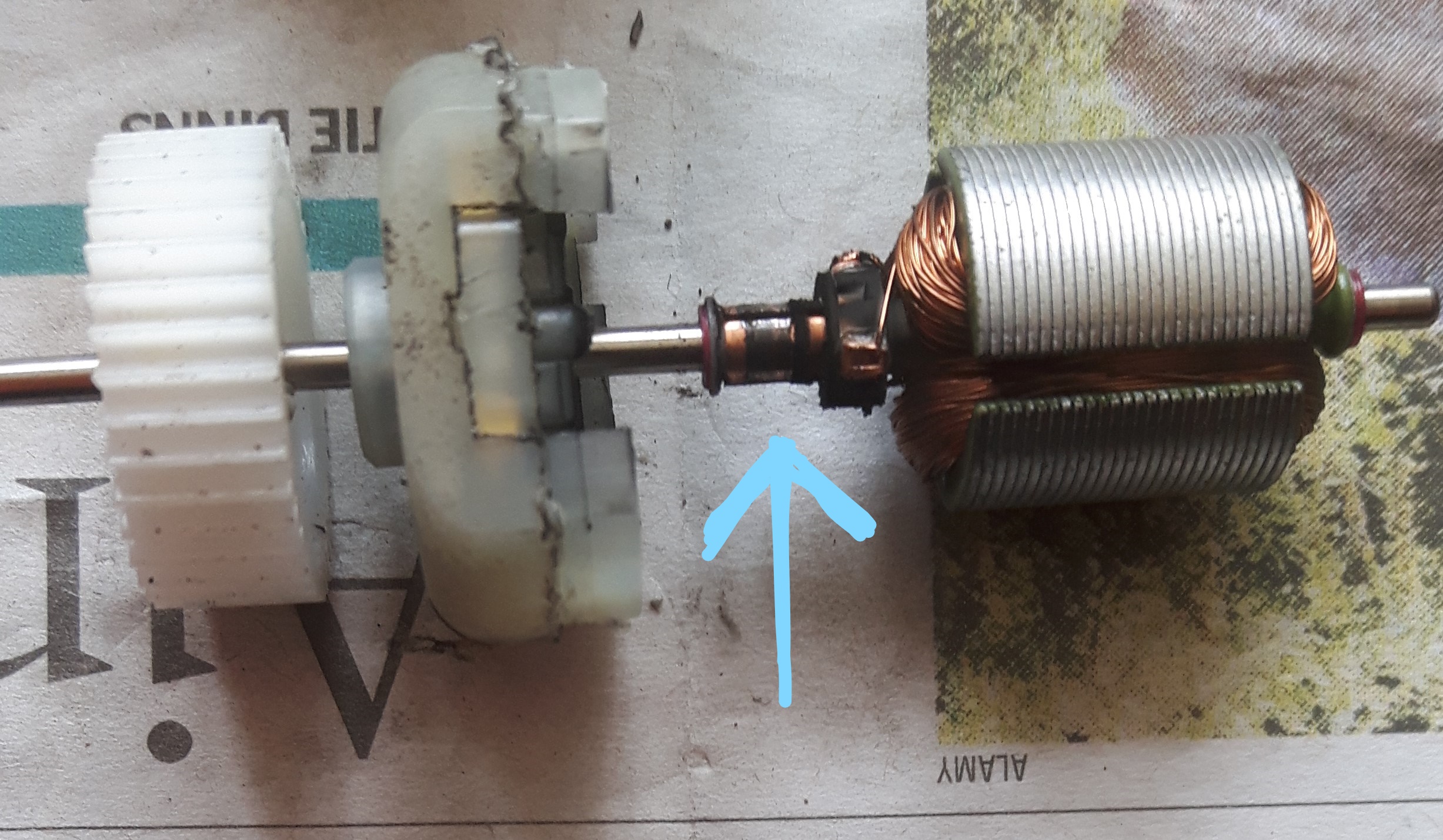

May also be the motor inside the passenger side lock unit. When you unlock the car with the key in that door, it doesn't need to do anything.  When you unlock from the other side it does need to work.
It's not very easy to get into, but on a Polo of mine, cleaning the commutator brought this one back to working properly.
