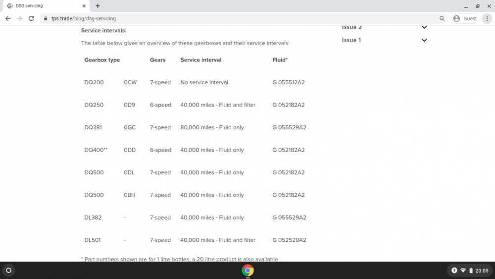

There is no Servicing or oil changes in the manufacturers guidelines or schedule for a DQ200 DSG getting an oil change.  There are 2 oils.
But,
likely the car has had one sometime from May 2014 when a Service Campaign was started in Europe, which was not part of the World Wide Recall not being in the world.
So '34F7' had the Synthetic Oil filled at the factory changed to mineral oil and a software update done.
If done there should be a sticker in the Spare Tyre well with '34F7' on it and a date and a dealers stamp.
The car might well be into D7 by 45 mph or so.
So if no sticker in boot with 34F7 I'm to assume the original synthetic oil is still in the box and a switch to mineral with a software update is prudent?
The 1.8 TSI definitely got the 7 speed gearbox.
It does drive a bit different to the 6 speed since the clutches are basically like standard clutches whereas the 6 speed clutches are multi plate oil lubricated and so tend to slip more to smooth out drive uptake etc.
It's funny how much false information floats around out there. Definitely not dry sump. Lol
They actually have 2 oils in them. One for the gearbox (actually just standard manual gearbox oil) and one for the mechatronics (the green power steering/hydraulic fluid).
It's possible yours needs the oil change but also possible it doesn't. Was a bit hit and miss!
I just did a precautionary change on mine. Oil was fairly grotty and it's definitely driving super smooth (did before the change to be honest).
@Andy9-5. If no sticker in the boot assume nothing.   A Skoda Dealership or Skoda might have said no Service Campaign action required as happened with some cars.  There could have been mineral oil in at the factory at that particular build time. Or there was no sticker put in, as happened quite a lot.  Or they were just wrong as has proven to be common.   So basically you ask at a dealer of with Skoda. Was it done or should it have been done.     Now if not done then leave well alone if the car drives well. The issue that required the world wide recall was known 9 years ago....
