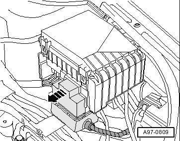

You can forget about the defective glow plug warning, save yourself a few seconds and just turn the key as you would a petrol engined car.  The preheat isn't doing anything and the car starts just fine.
If you wish to test each plug, remove the plug caps and test continuity between each plug and ground, you should see <2 Ohms for a good plug.
You can also check for power to the plugs by measuring voltage between the plug caps and ground.  You should see battery voltage when the preheat lamp is lit and probably for a short while after it extinguishes.
Since all 4 are showing a fault and they didn't before I suspect you have a broken connection somewhere in the preheat circuit (as a result of recent electrical disturbances) rather than dud plugs.
Assuming all the relays are good I can only suggest a painstaking continuity check between each end of the affected system's wiring especially as some show as intermittent possibly indicating connectivity issues rather than faulty components.
cheers MicMac do you know where the relay for them are maybe a good spray of contact cleaner might help
My manual doesn't cover your model but indicates 2 relays in the engine fusebox for the 1.9 & 2.0 PD/CR.
It shows an on-board power supply unit/Vehicle Voltage Control Unit (CCM?).
I believe that is what you previously disturbed and should probably look at again, clear all DTCs and rescan.
having read up a bit I think they may be a relay module under the battery
You didn't disturb that recently so don't go looking for problems, as I said non functioning glow plugs don't affect starting, at least not on my car down to at least -8C.

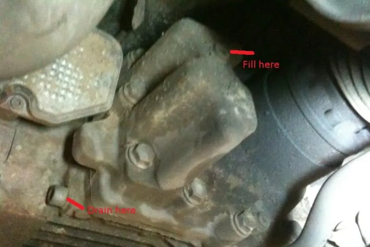

Useful picture of it here:
Has your haldex ever been serviced? It should have fresh fluid every 40k miles if I remember correctly.
If it hasn't, it could just be full of gunk which is stopping the valve working properly...

I will have to check the service history, it had a full service history when I bought it and I dont do a lot of miles and had it nearly 2 years

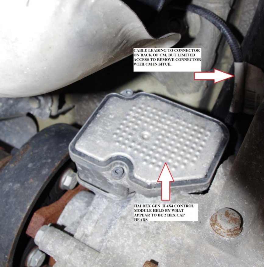

There is a very good chance the PCB has got corrosion on it as the faults match this thread:
been looking it all up and found these photos and the vid on how to change the haldex oil and filter, nothing in the service book to say if it has been done or not, I could maybe let a few drops out and see how clean or dark it is?
No Ideal what Gen my Haldex would be
also take a look at this for corrosion
https://www.audi-sport.net/xf/threads/haldex-not-working-no-communication-etc-look-inside.142194/
