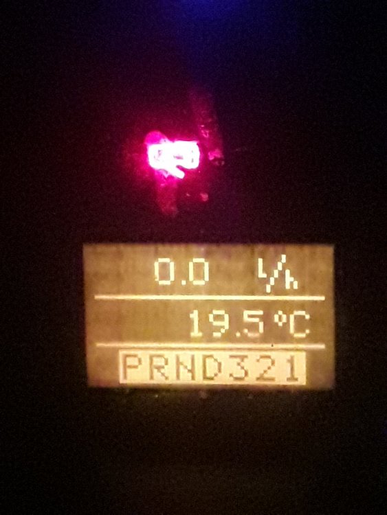

I have a scoda octavia 2008 automatic transmission
Suddnly all gear shift indicators on the dashboard turned on.
Everything is working well
Tried all the gears
No change in the performance.
Any idea about this issue??
Thank you in advance for ur assistance.
That means there is a fault code logged in the automatic transmission control module, you need to get it read with a fault code scanner to see what the problem is.
