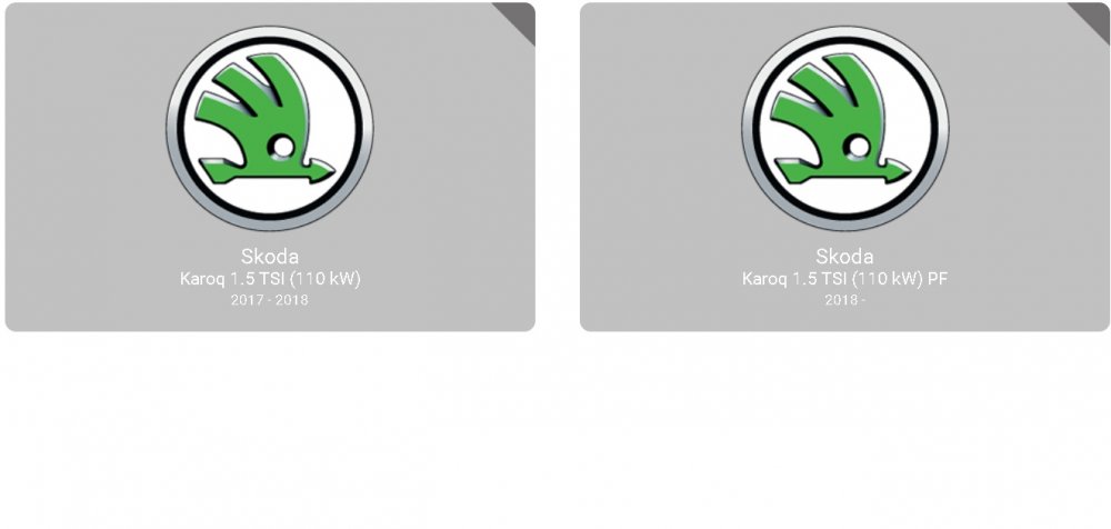

I was looking on the TPS site for the recommended engine oil for my 2018 Karoc 1.5TSI DSG.  After entering the reg no. I was faced with two choices :
Sorry pressed wrong key !  From the attached picture can anyone tell me what PF stands for in the selection on the RHS ?
The recommended oil for the LHS model is 5w-40, which is what the dealer says they used on the first 2 services.  For the the RHS model the recommendation is 0W-20 - quite a marked difference so I am keen to know what the PF means on the model on RHS.

PF could be particulate filter - are they fitted to petrol cars ?
non-long life (fixed servicing intervals) oil seems to be  recommended if you do less than 25 miles a day which is definitely me.
They are fitted to Petrol Engines in Skoda from 2018.
So that is what TPS is showing.
