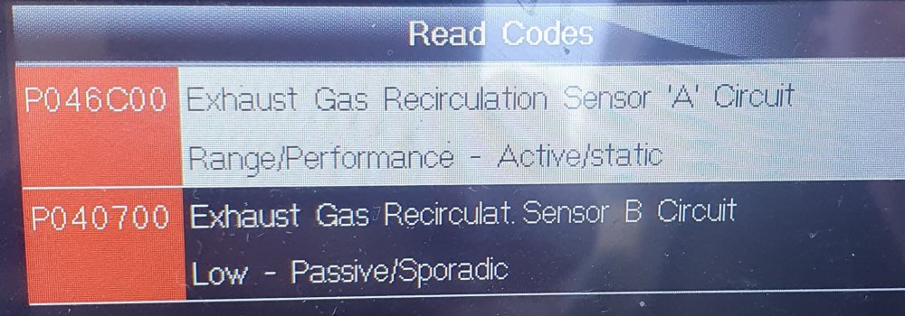

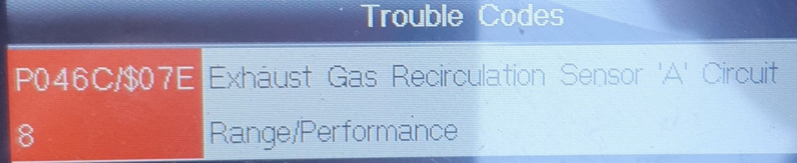

So I had the car read to day.
And this is what I got.
It had a little rough idle this morning and I suspect it might be a carbon buildup in the EGR module's pintle. So it does not close properly.
I don't know what the last code reports but I'm reading trough the interwebs for answers.
Any tips?
