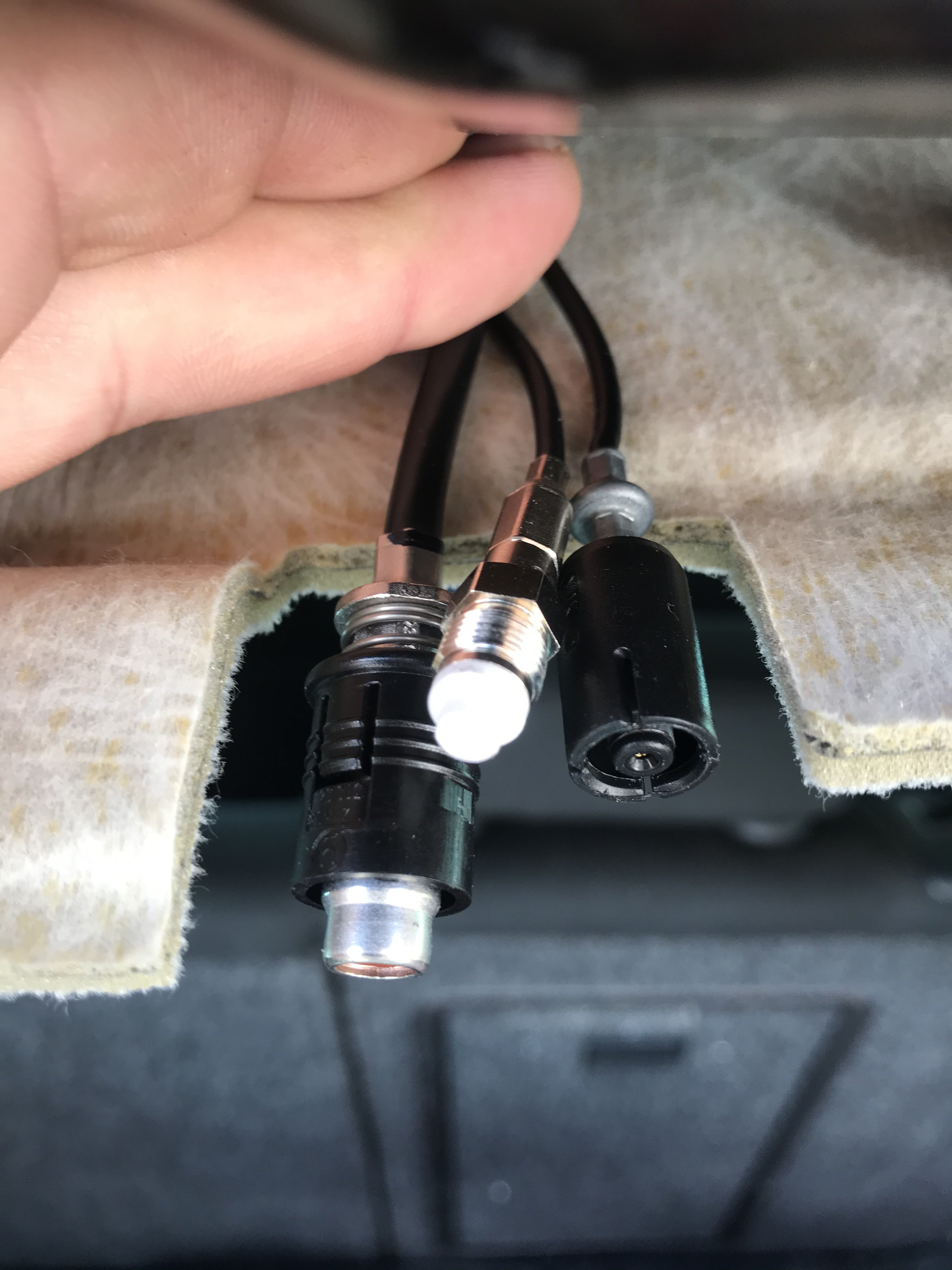

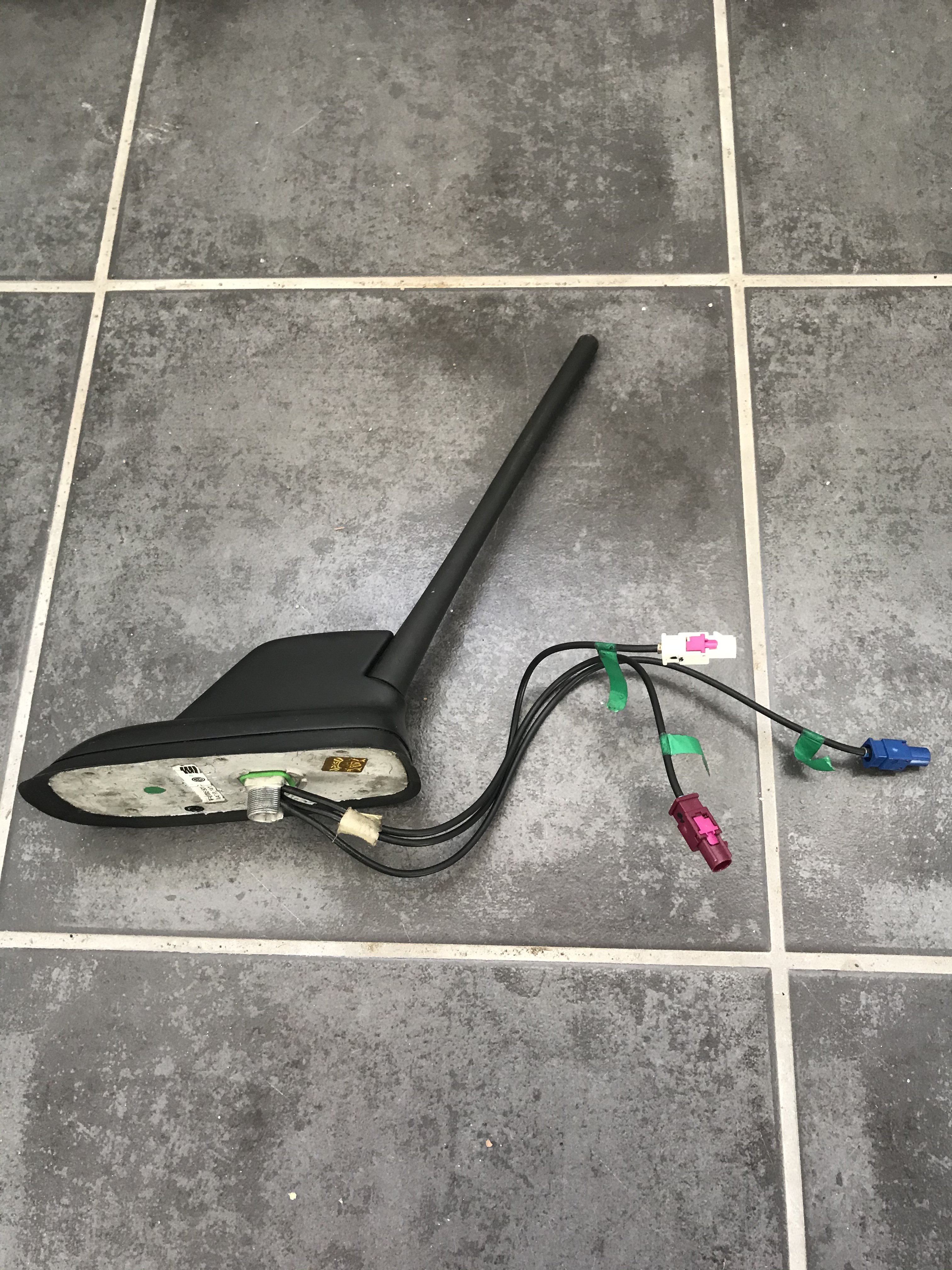

Bought a replacement aerial base for my 2007 pre-fl Octavia, but when i pulled the headliner down, I discovered that, the connectors was not fakra.
Any idea what type of connectors they are and how i can convert them to fit the new aerial?

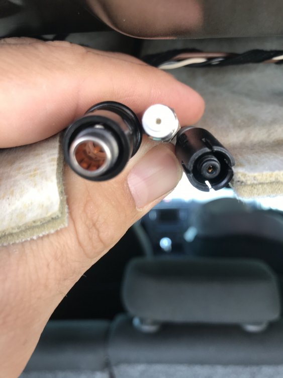

The one on the left with the copper pin inside looks like a female RAKU 2
The centre looks to be FME female
The one on the right pretty much looks like a male RAKU 2
With your adapters, to make it easy go for Z-type fakra, which are a turquoise colour, as the other colours all have their pegs in a different place around the body of the connector to only accept its same coloured male/female counterpart. However z-type is universal and accepts all colour fakras to the opposite type

I’ve searched the internet for adapters, but can’t find them anywhere in stock.
Decided to ask local electric workshop, to fix it, they fixed it by mounting new fakra connectors to the car
