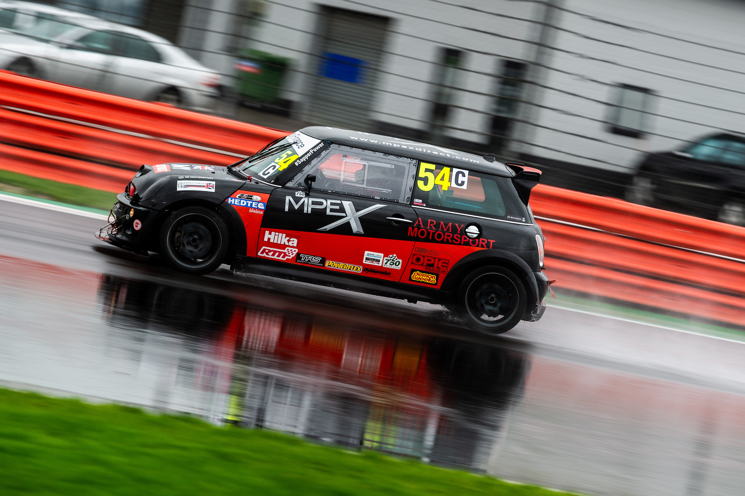

This is the current race car

The problem is the Mini is really highly strung (252hp) and one mis-shift and its 2 grand to replace the head.  I could replace the engine on a vRS for 500 lol and it will run 360hp with minimal work, cost and wear.
I'm currently sat in the middle of  power class at 225hp/ton where the limit is 240hp/ton.  I can't get to that value without a turbo conversion, at which point t I'm in the next class and having to put ballast in the car.
The Mini is quality though, it's just worth more in parts, hence the strip.
