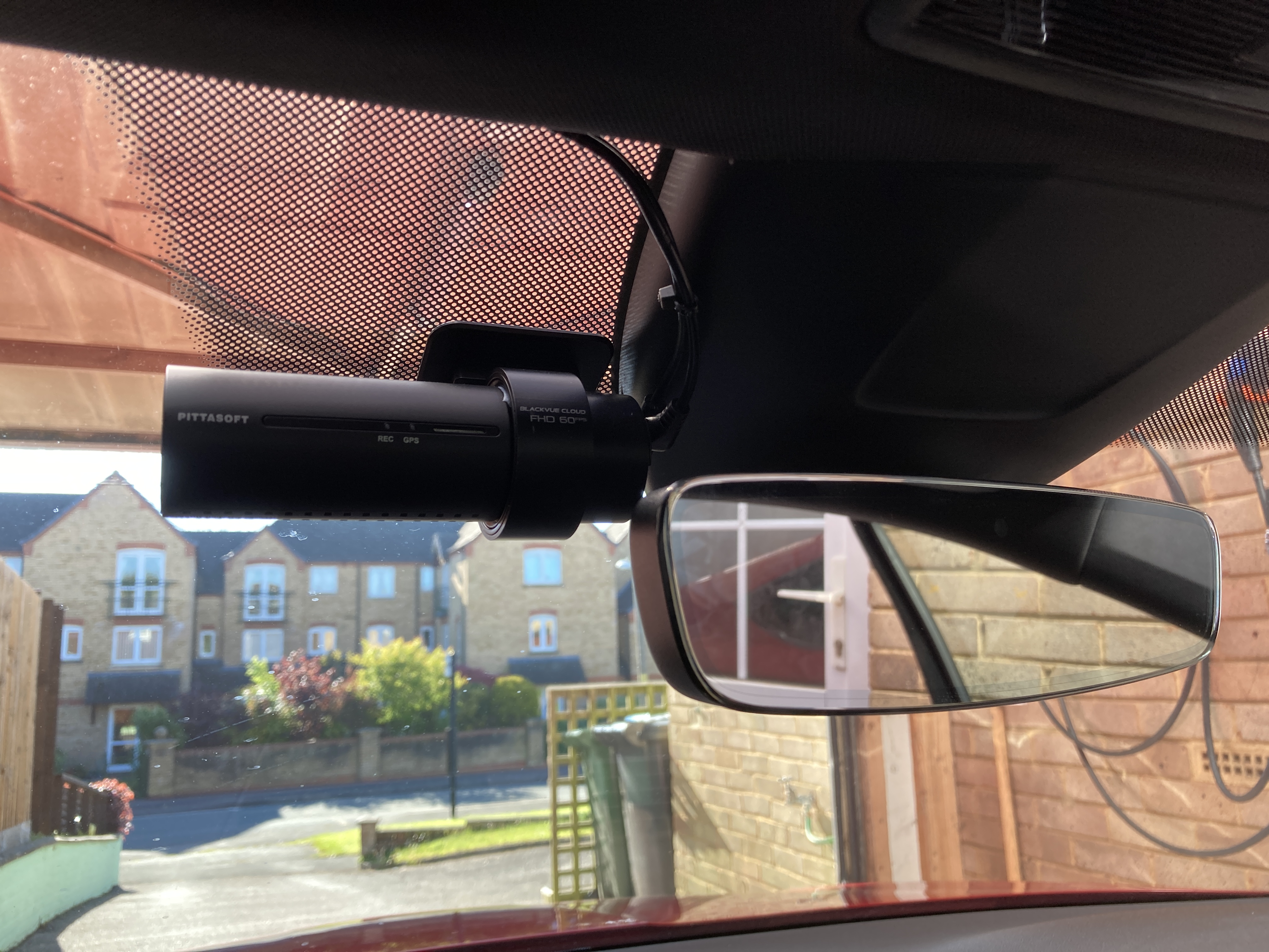

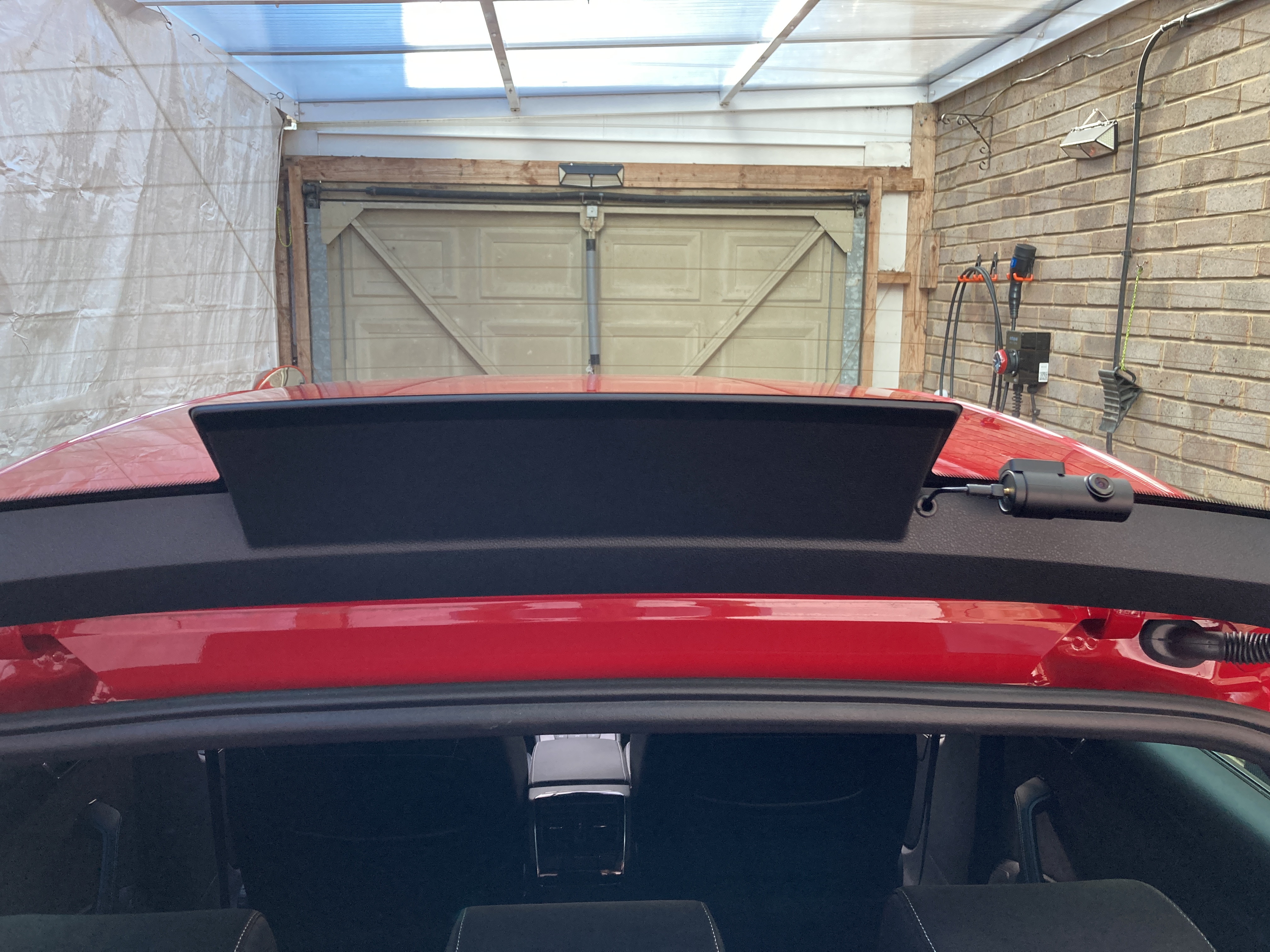

I installed front and rear Blackvue dashcams into my 2020 Superb iV.
The front camera is mounted just to the left of the interior mirror/camera/sensor 'pod' and the rear camera to the righthand side of the high-level brake light.
The wiring runs down the left hand A pillar, under the left hand door sill interior covers then up to the left hand C pillar, though the rubber wiring conduit into the tailgate. Mains power is provided by a piggyback fuse connector in the fusebox behind the glovebox (I can't remember which circuit!).
It doesn't appear to have affected any of the electronics and the dashcams work fine, wifi to the iPhone as they should.

I was very pleased how it looks at the end (practice was on my previous Yeti and Citigo!) and it wasn't too much of a faff getting the wire through.
The front camera wires are actually neater than it looks in the picture and the camera doesn't restrict vision at all (not of anywhere you need to look!). The rear camera can't be seen in the rear view mirror which is one of the reasons I put it to one side.

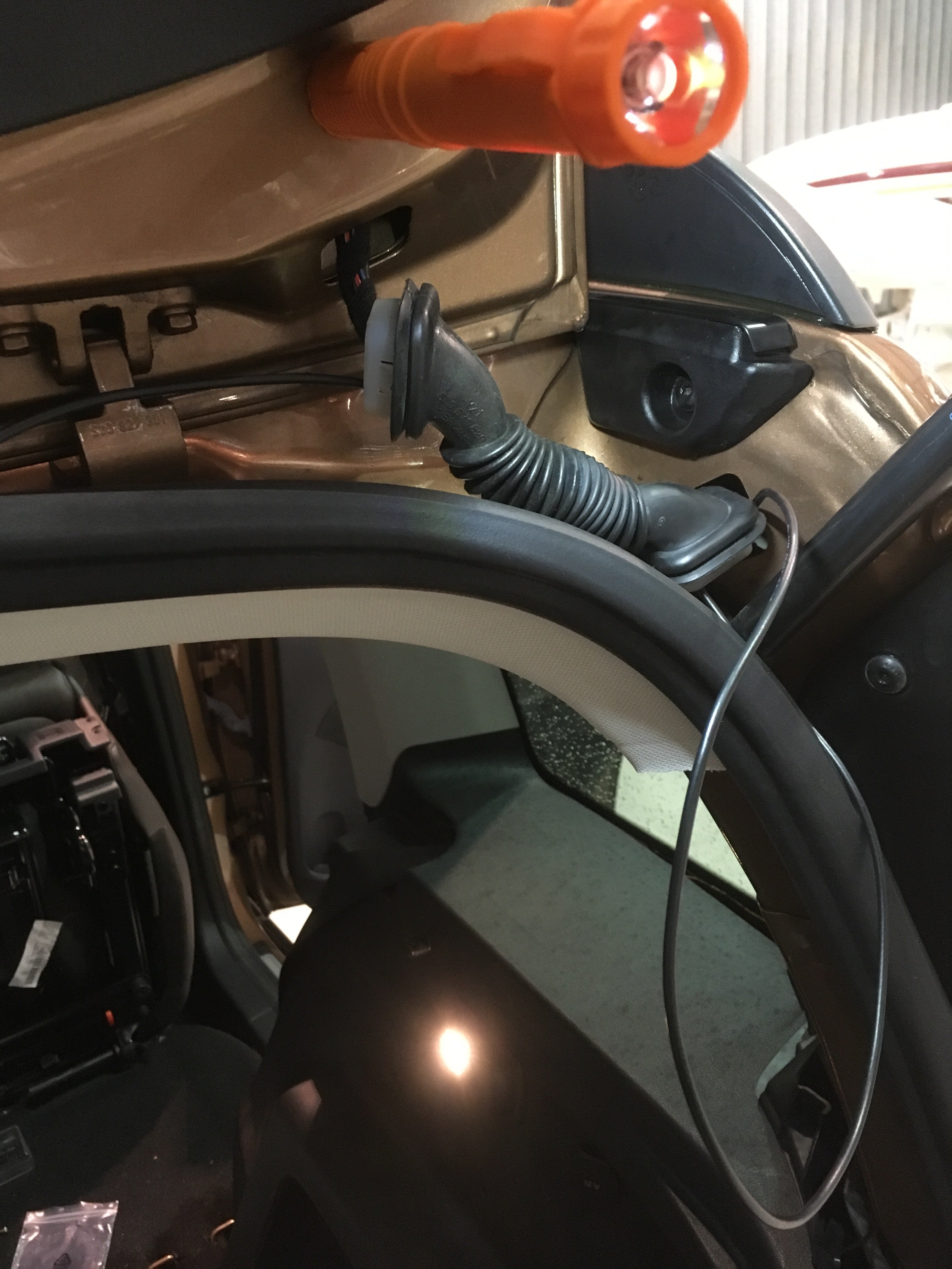

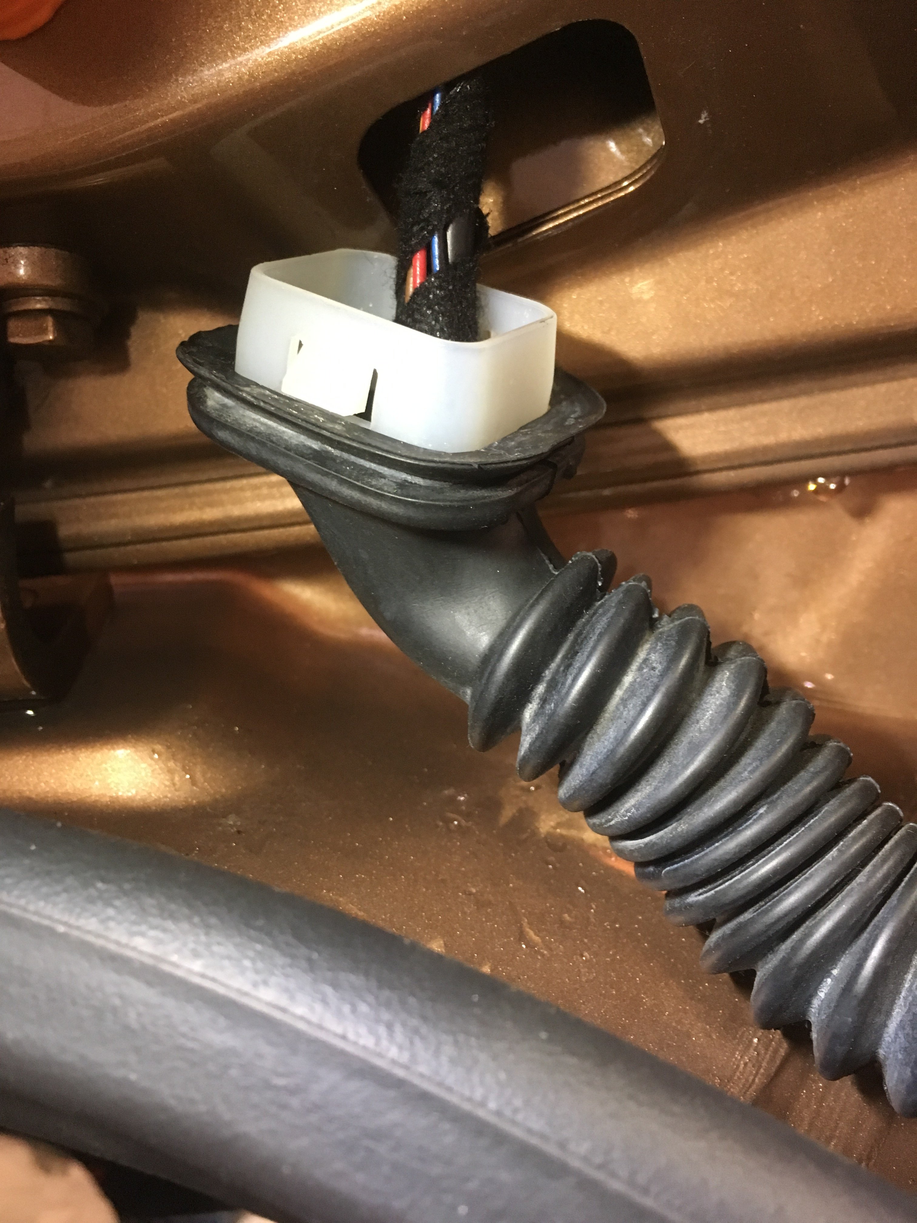

How could you manage to run the back cam cable though the rubber wiring conduit into the tailgate? How could you loosen the conduit? Thanks!
The rubber wiring conduit should pull pretty easily from the plastic clip that holds in place.
I used a medium sized cable-tie with the dashcam cable held to it with insulation tape to take the dashcam cable through the rubber wiring conduit. Then a bit of jiggery-pokery will get the cable to sit nicely in the conduit and the conduit should then go back into place.
Pictures attached of when I did it previously on my Yeti. They should give you an idea of what holds the rubber conduit in place. Hope that helps.
