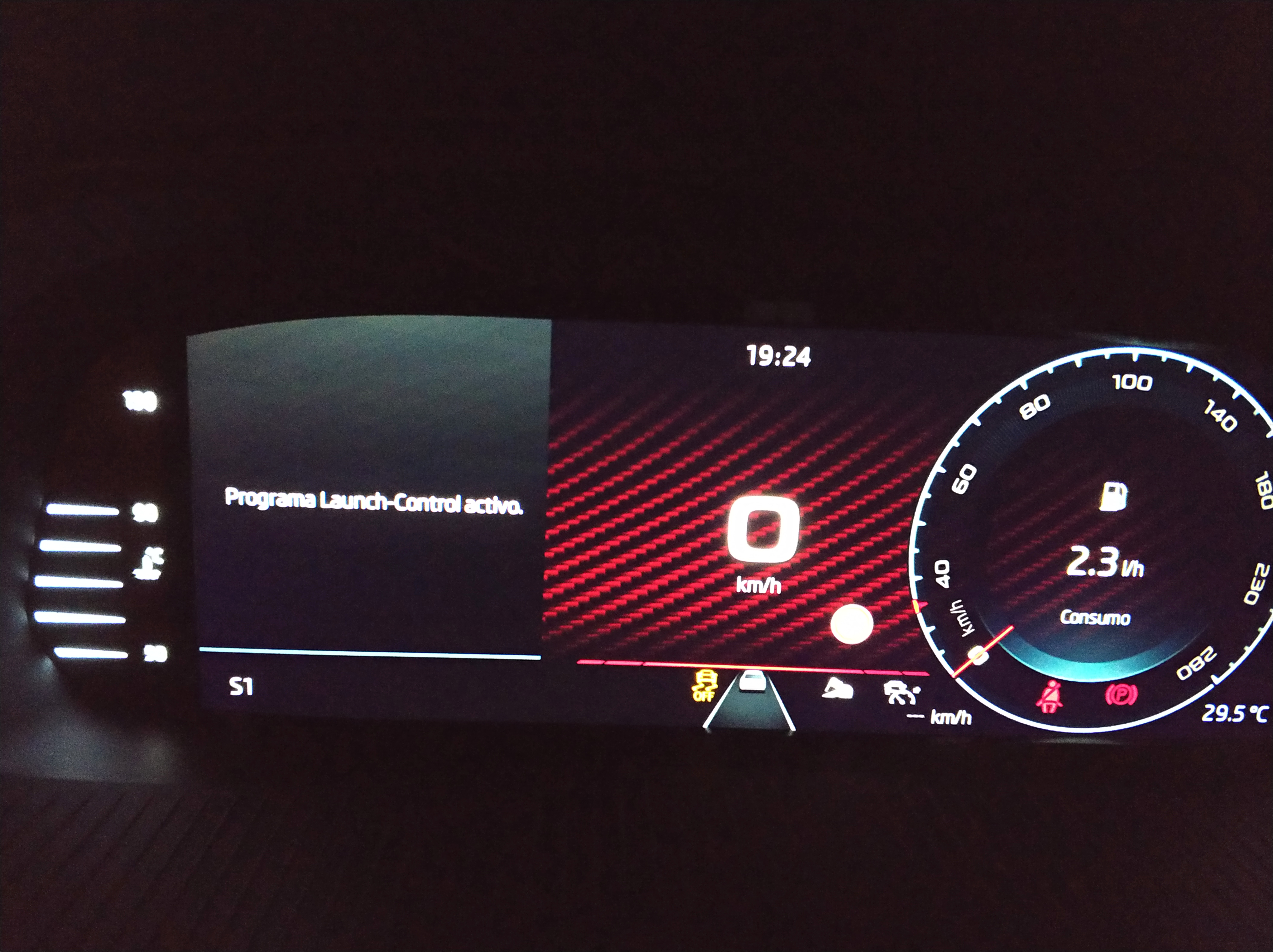

Hello!
I found the esc option and lauch control is "active"
But, i Will try It when the car have arround 15.000km
The steps:
Turn off the "Start Stop"
Mode -> Sport
Vehicle -> go to brakes -> set value to ESC Sport
Now, you will press the brake with the left foot, and starts acelerate with the right foot and you have to see a message in the display with "some words... Launch Control"
Thanks everybody!
