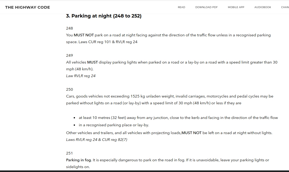

The Parking Lights on the roadside front and rear of the vehicle (& one reg plate light.)  Is legal in the UK where you are required to have Parking Lights displayed.
Side / Position Lights are not 'Parking Lights' for having a car at a roadside stationary where 'Parking Lights' are required.
They can function as Parking Lights, and that will be when the ignition is off.  Lots of cars can not have 'Sidelights' on if the keys are out and the car locked,
but they can and do have 'Parking Lights' which can be on, this is all part of Construction & Use, & meeting EU / UK legislation etc.
The RAC so then The Sun and others keep going on about it being illegal to park without having 'Sidelights on'.
Then they go on about Low Energy Use etc etc and how they will not flatten a battery.  Well just Front & Rear & Reg Plate lights on can have a Fabia Battery flat if on from Lighting Up time / Darkness until dawn / Day Light time.
