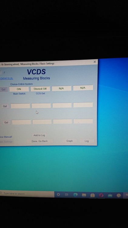

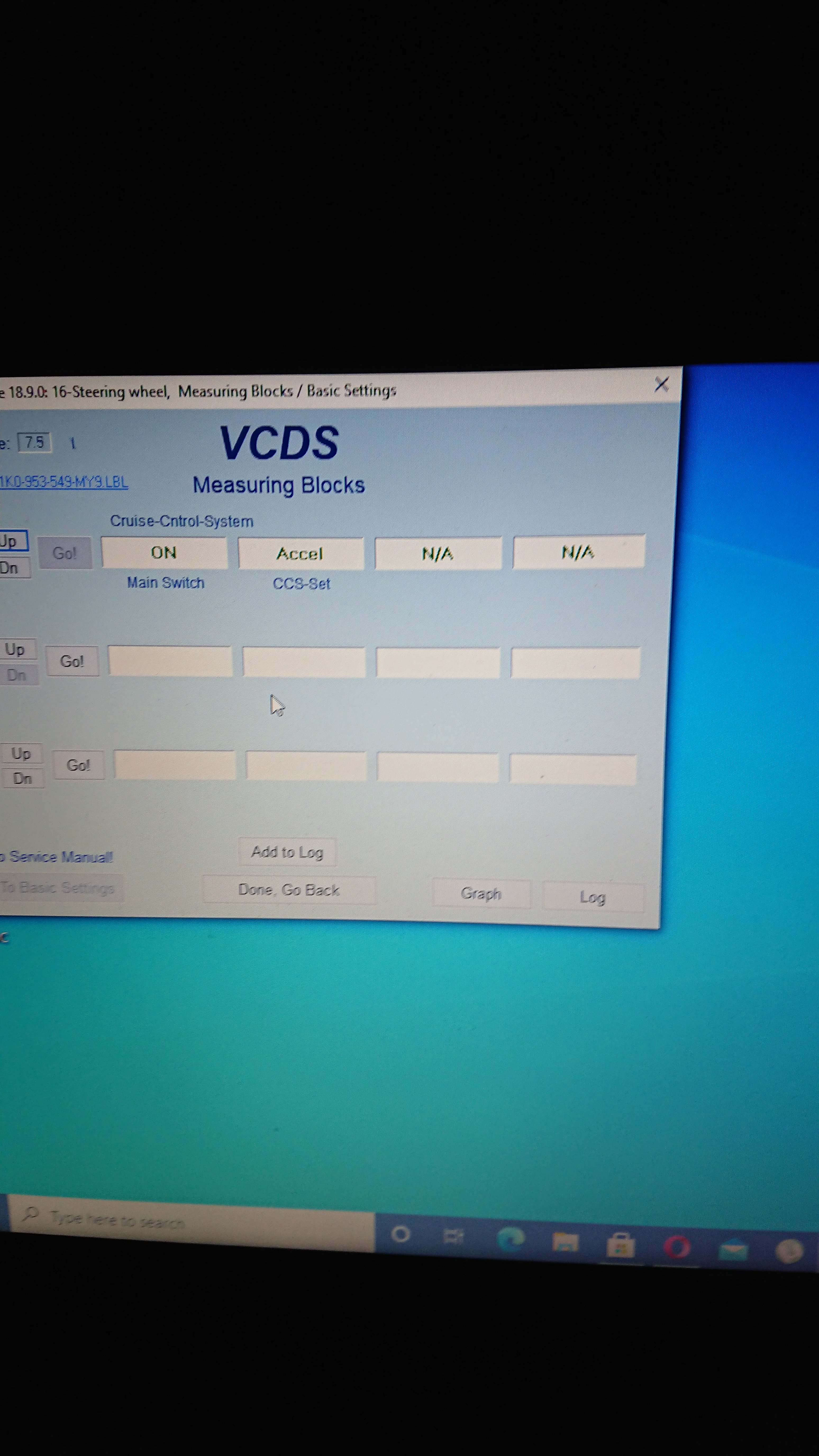

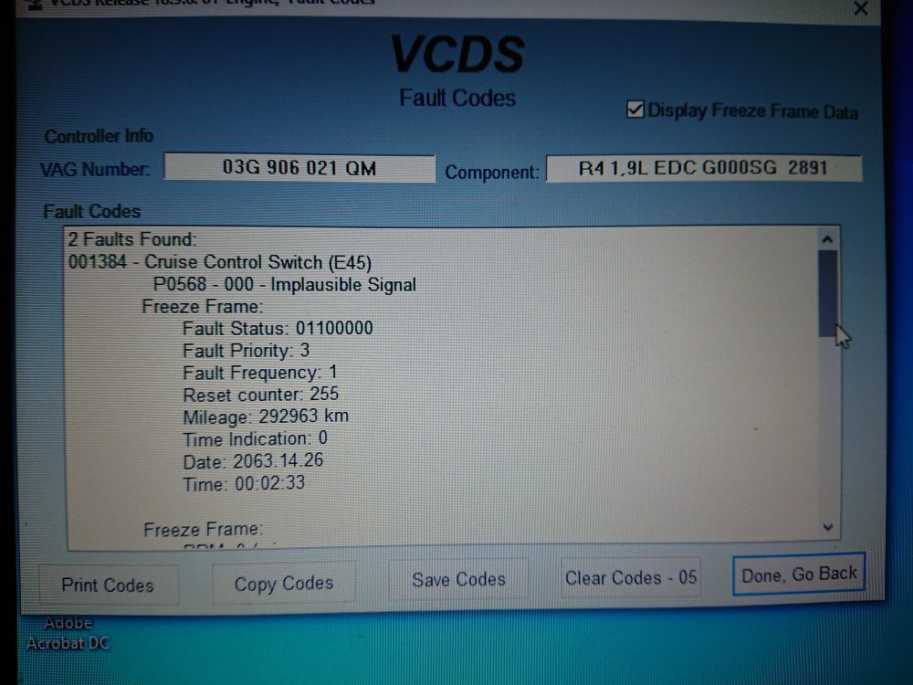

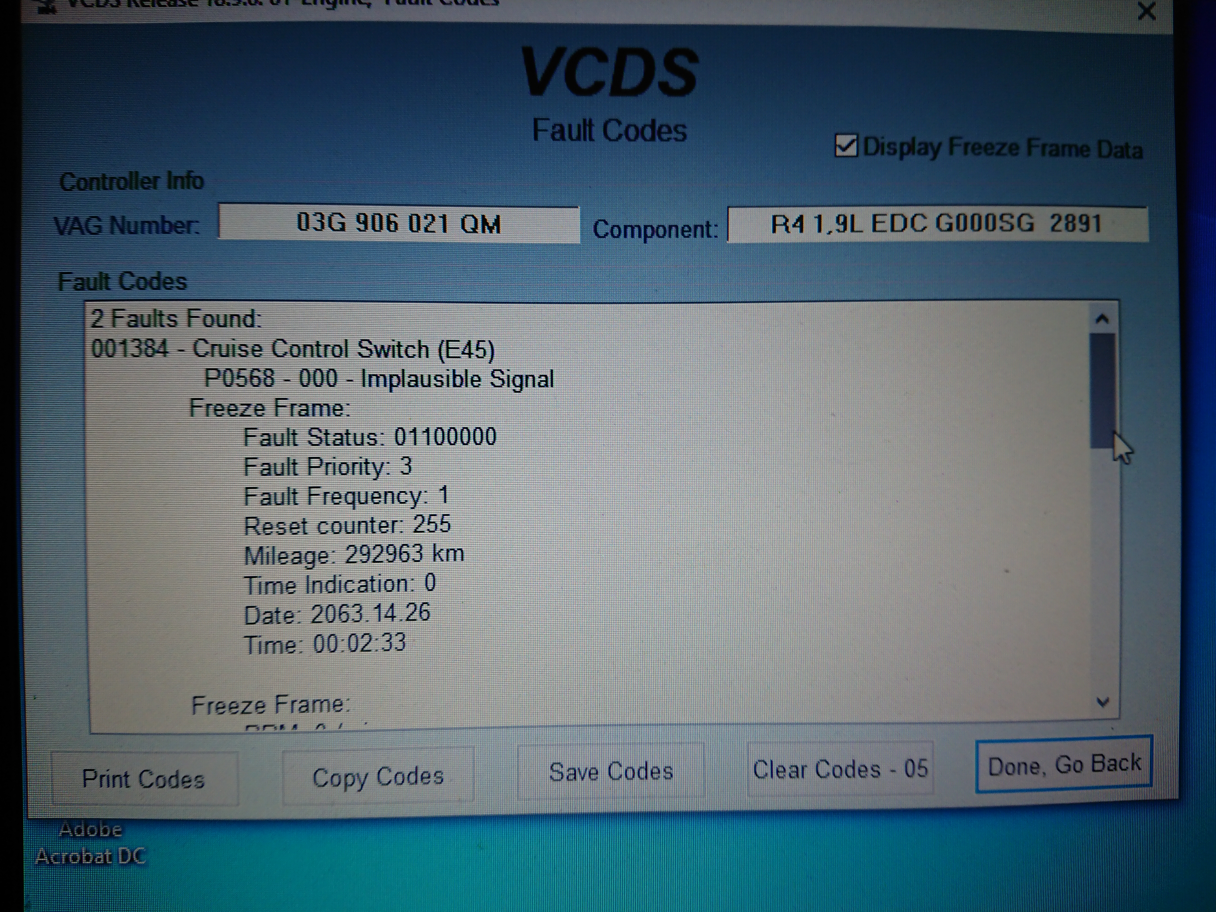

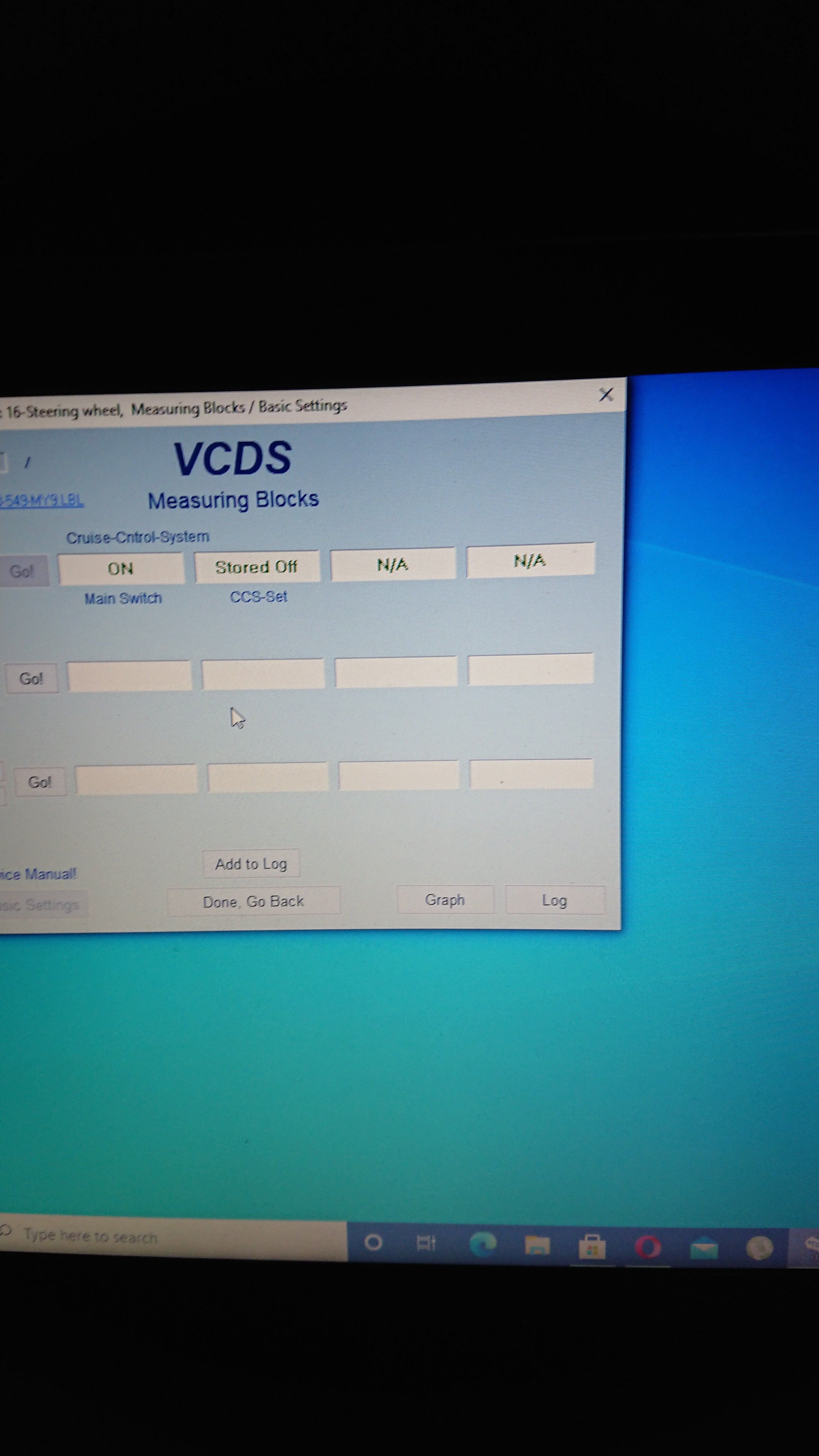

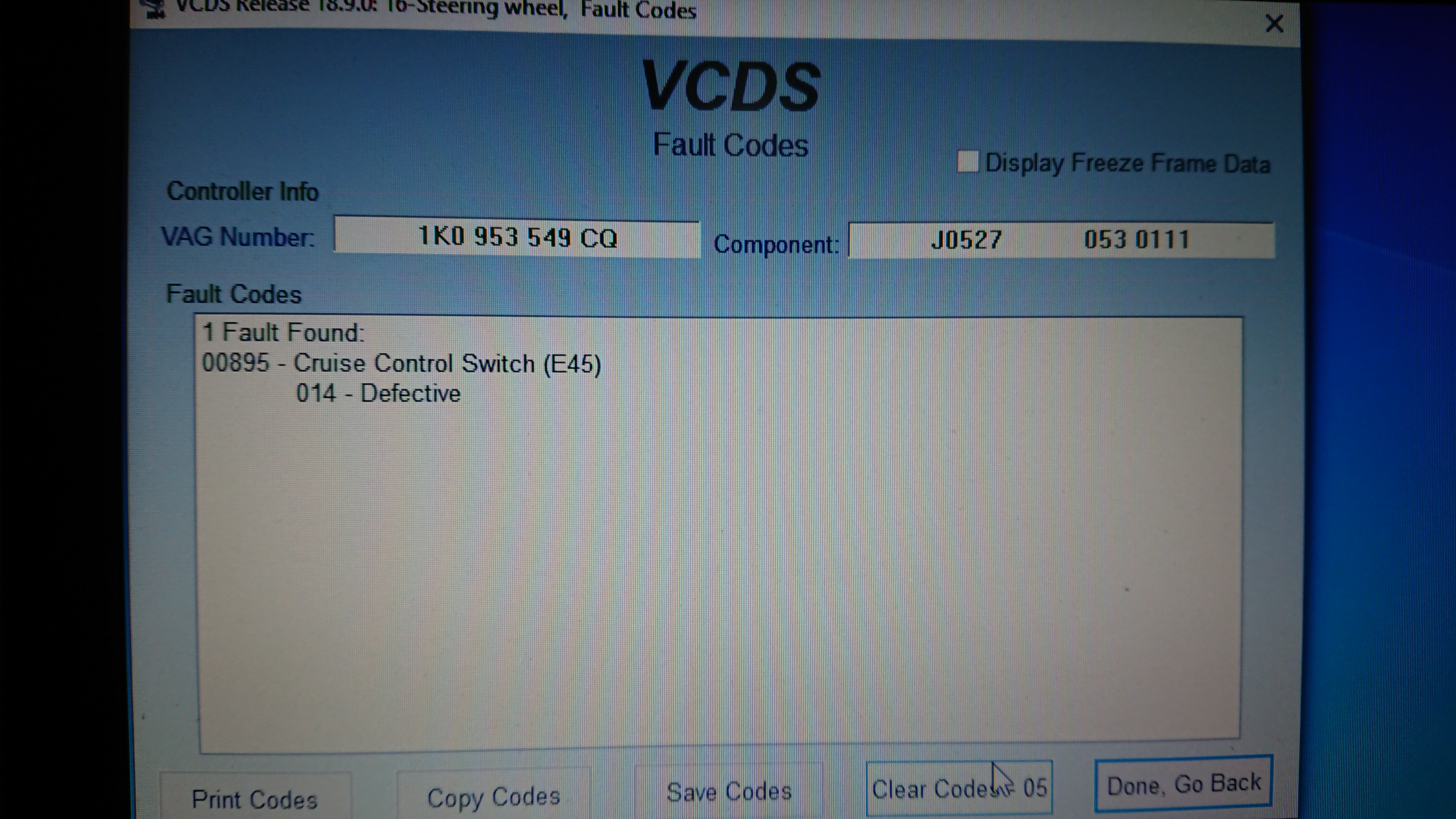

Hi all, just wanting to run so part numbers by you all, I have vw1k0953549cq with stalk 1k0953513f wire running from pin 13 on the controller to pin 20 on the ECU. Everything's been coded correctly but I'm getting E45 errors, the on, off is working in the measuring blocks but no reset or Accel decel, any ideas iv multi metered out my wiring to the ECU. Perhaps this stalk configuration is not compatible with my steering controller ?

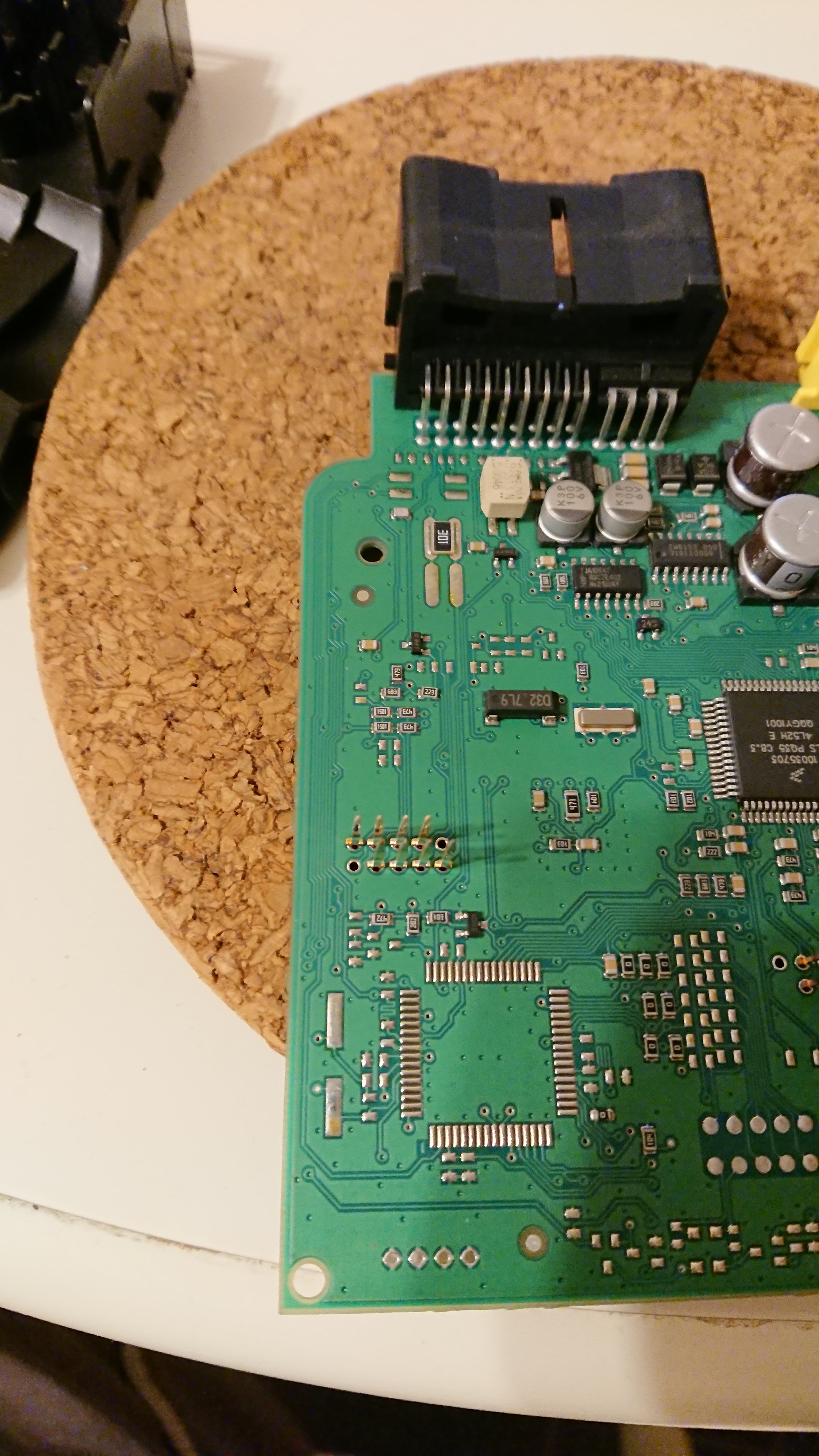

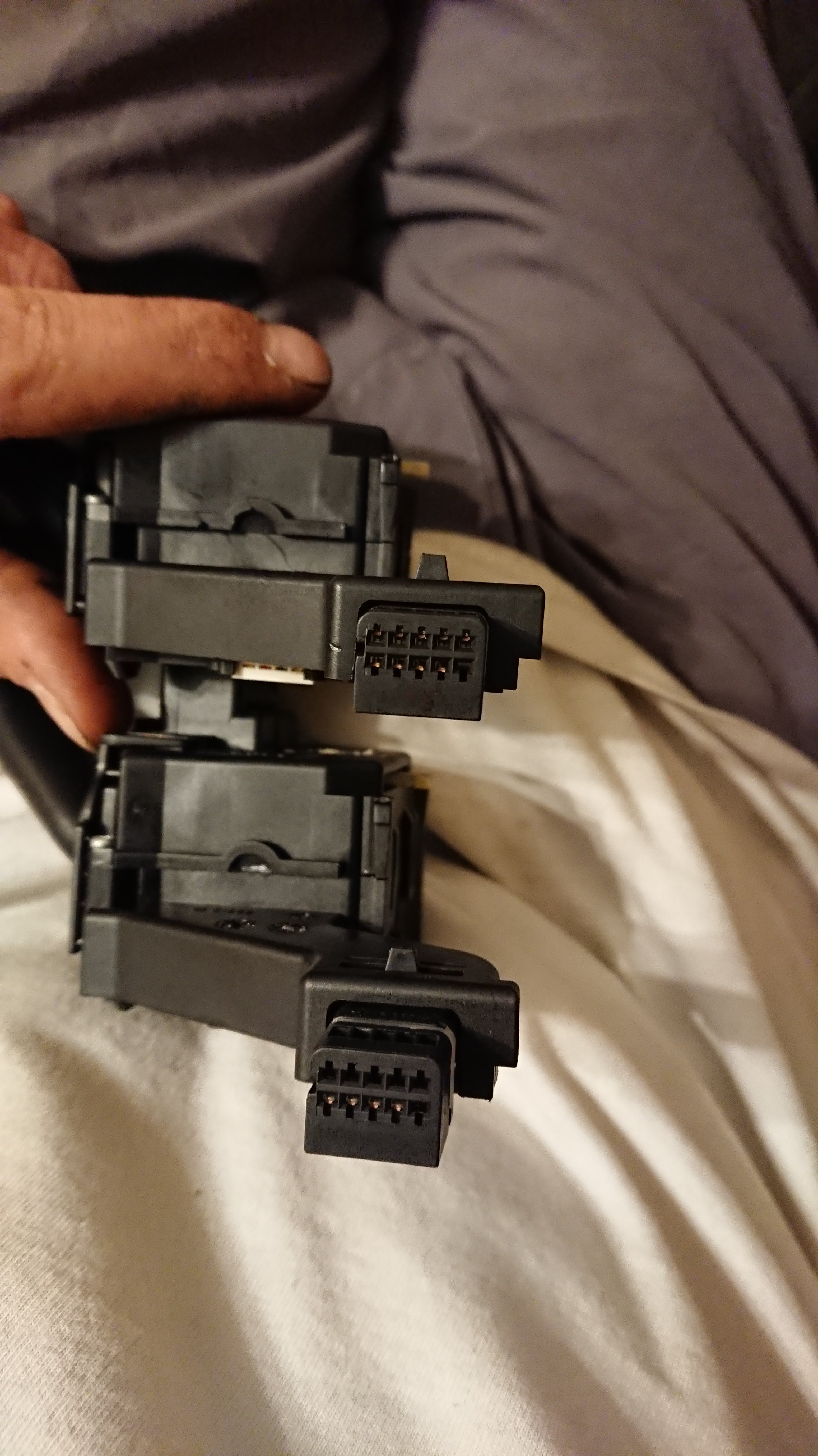

Looks like one pin in the controller is missing for the cruise control for this stalk to work, looks like it's connected to a power regulator MOSFET on the board I suppose only one way to find out if it changes anything....* Update *  1k0953513G has cruise control but with pin 10 missing also like my steering controller *update 2* looks like one pin share power from a single pin
Edited by grizzle245

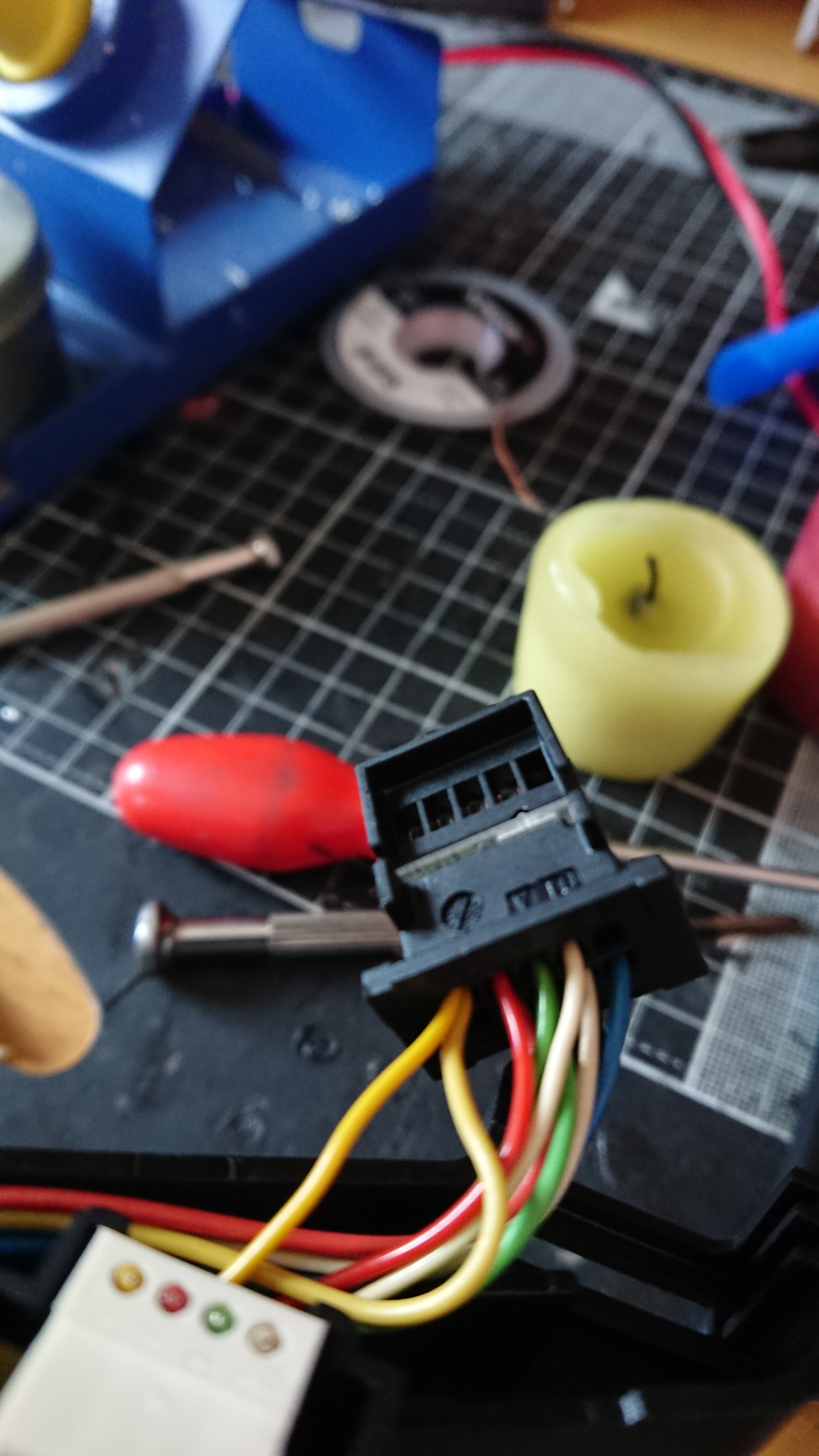

So to save money on one single pin and plug they piggy backed off the signal voltage for the indicator ect. So I soldered the wire to the plug
Sorted
