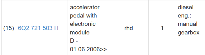

Will a new pedal solve this issue and any ideas on a dealer sourced part cost? Suggestions (guide)?
It does sound like the pedal unit is faulty.
Yep  Fabia 1 VRS 1.9 of turbo
Thanks for that. I will give dealer a call.
