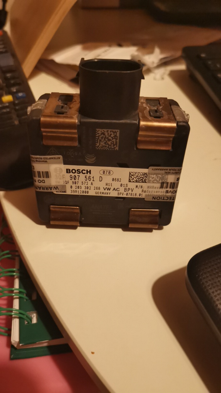

Here's what I bought for an upgraded radar and I will fit this a5 camera, as its the right version for pacc, after I change the windshield for one which supports pacc.
It's possible abs needs some upgrades on some cars which could get messy, although some people say if you already have acc, abs is probably already a good version
Yes this radar will work, I have the same. It will just need SW upgrade maybe.

so if my radar is 3Q0907561D, that is no good for pACC? Can it be changed out for the 3QF one from a Golf for example and except for the calibration, will it need coding or any software swaps?
Exactly, this radar is not suitable for pACC. And yes, it can be changed to 3QF, but I am really not sure, if it is possible to retrieve the previous swaps back, because it is totally different HW. I mean, that you will need after that to add three swaps - for Front Assist version, ACC version and pACC. After that "only" coding and maybe to add the dataset. And of course to remove component protection. With the instruction on the link, you can add the swaps by yourself, with flashing to the 3QF radar corresponding X SW (there is a guide, how to do it).
