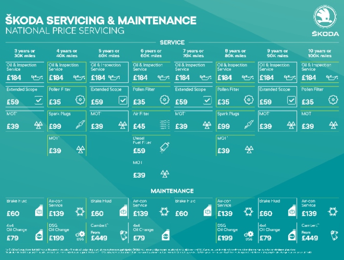

That service pricing chart is really useful.
