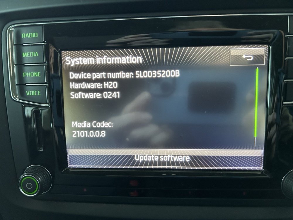

Yeti head unit problems
Just for info here is my System info screen. Are there any firmware files available for download onto a SD card as it might be worth trying an upgrade?
I have the same issue with my Yeti head unit, just appeared yesterday and from what I have read on another Yeti forum there have been several other owners with the same problem. It reads 00:00 and flashes to 06:28 occasionally. Time on the main driver display is correct, and I have not been doing any work at the head unit recently.

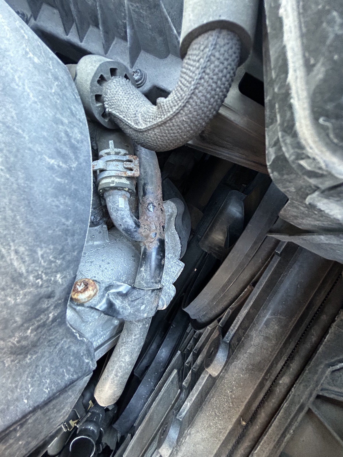

Help Identify corroded pipe
Thanks Pete, I'll take a closer look at the pipe and compare with the diagrams. Alan.
Anyone got any idea?
Can anyone identify this pipe and want it carries e.g. oil, coolant and name of part etc. It's just behind the radiator fans and I am rather worried about the corrosion. Thanks, Alan.
