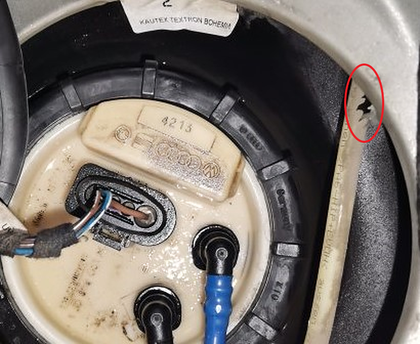

About the fuel leak issue, it just popped up in the past two days. After a trip with my family to the countryside, we noticed a strong fuel smell in the cabin. I went to check the pump under the back, lo and behold, there's fuel pooled inside the top of the fuel pump and to the sides. Testing the pump in-situ didn't yield any obvious results, there aren't any apparent faults while pumping, so it looks like the fuel leaks while the car is moving, as it sloshes around or something. Is it common with these fuel delivery units to leak at the top? Fuel lines seem intact and everything is tight. The whole pump assembly was replaced two years ago for a genuine unit.

Is that white pipe fractured?....
Not that I could feel. That's just a bit of paint flake.
OK. I presume you've checked that the big plastic retaining ring is tight? If so, you might have to remove the pump and check the rubber seal.
Yes, I've checked it and it's quite tight. You're correct, rubber seal is next, plus a general inspection on the pump. Otherwise I'll have to drop the tank and filler neck I guess.

Turns out I was wrong.
The pump gasket was indeed knackered, but it isn't the source of the leak. The pump inlets look healthy, so I guess the clips securing the lines to the pump itself are faulty. Since I have no means of dropping the tank or testing the lines or the clips to rule them out, I'll have to take the car to a shop and solve that problem.
Fuel leak solved. A very small crack in the return inlet was responsible for the pooling of fuel over the pump. A bit of epoxy resin did the trick, as I'm not in the mood for shelling out (again) the near £300 they are asking for a new genuine pump where I live.
