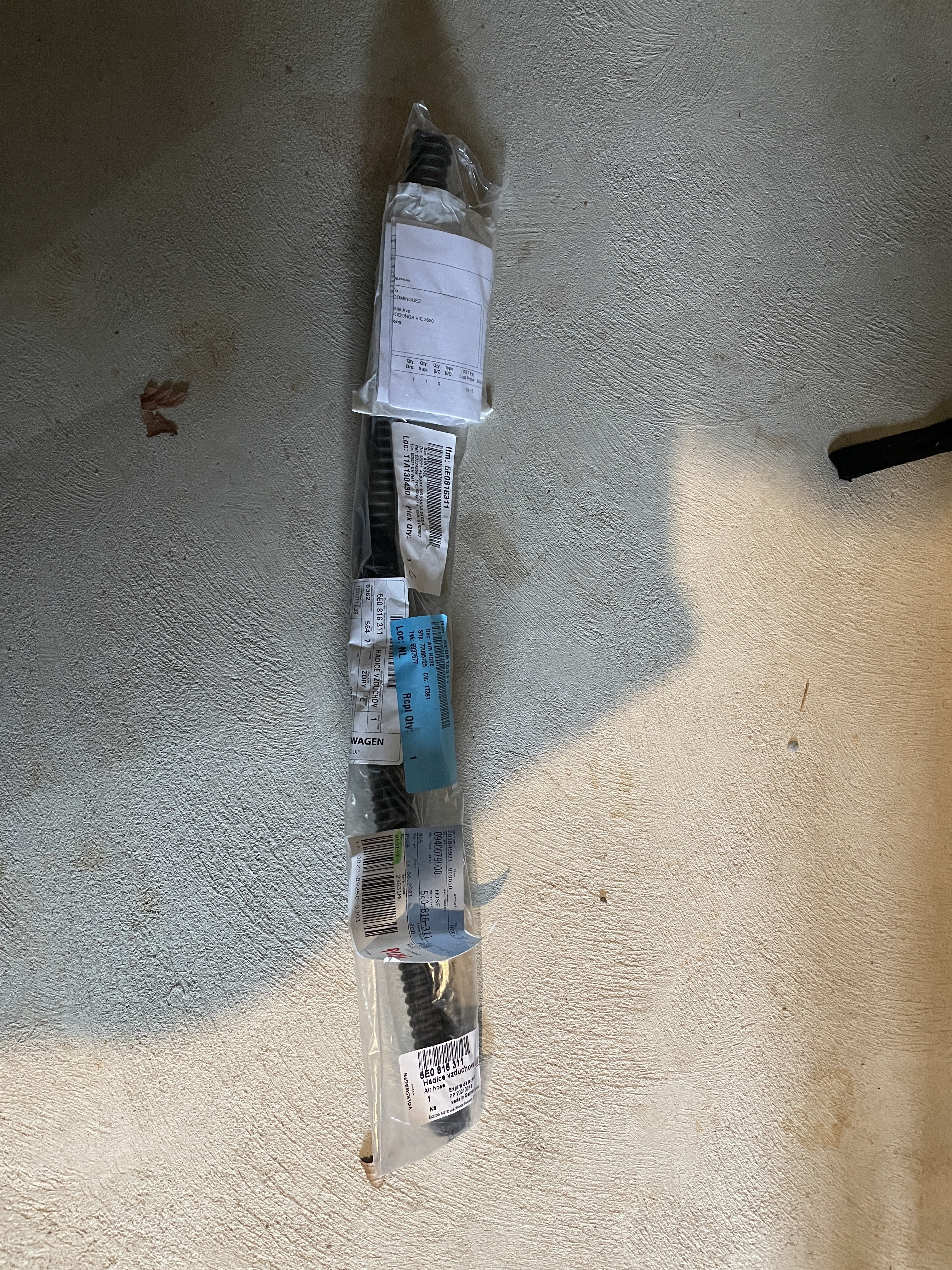

  • Cooled Glovebox Pipe (Air pipe) #5E0816311. (Picture 1A)
  • Cooled Glovebox Valve #5E0816355. (Picture 1B)

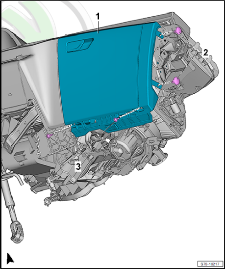

1. Remove side dash panel cover
2. Remove plastic rivet x2 (picture 2 item 2)
3. Remove screws x2 (picture 2 item 3)
4. Open glove box.

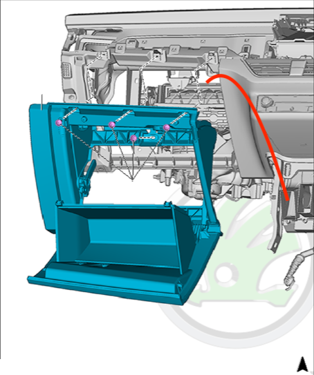

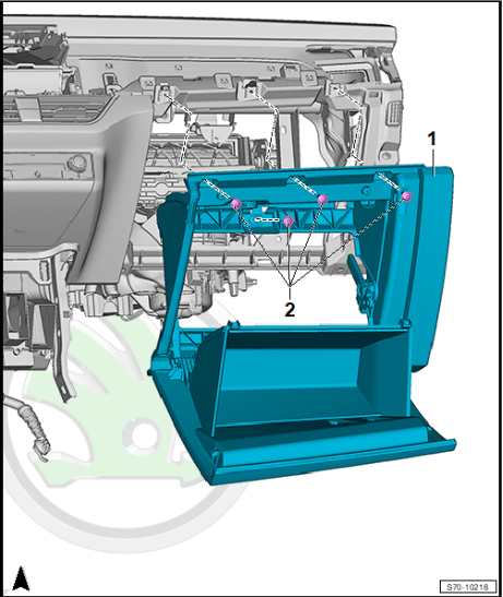

5. Detach the glove compartment from the dash panel (picture 5).
  • Release two tabs, the glove compartment will fall out.

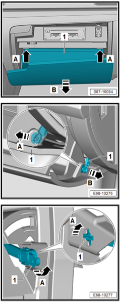

  • NOTE: the “brake element” will likely fall out, be sure to keep an eye out for the inner cog (picture 4 item 1).
6. Remove screws x3 (picture 3, item 1)
7. Detach the plug from the glove compartment light.
  • Pinch and remove.
8. Disconnect other plugs, if applicable (depending upon vehicle equipment [e.g. foot well light and brake element/light switch]).
9. Remove glove compartment from vehicle.

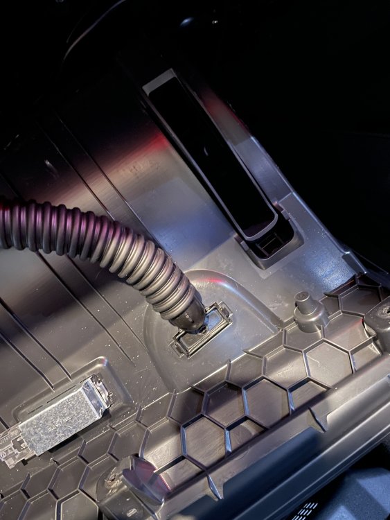

  1. Remove the capped off of the air conditioning outlet. Unfortunately, this is not easily found or photographed. In a right hand drive vehicle, this is best located by placing you hand between the thin foam insulation in the footwell feeling for some metal pipes near the centre console, (WARNING: if you have used the heating recently these will be warm to hot) near those pipes will be a rubber cap facing outwards towards the passenger door (picture 5), pull it off.

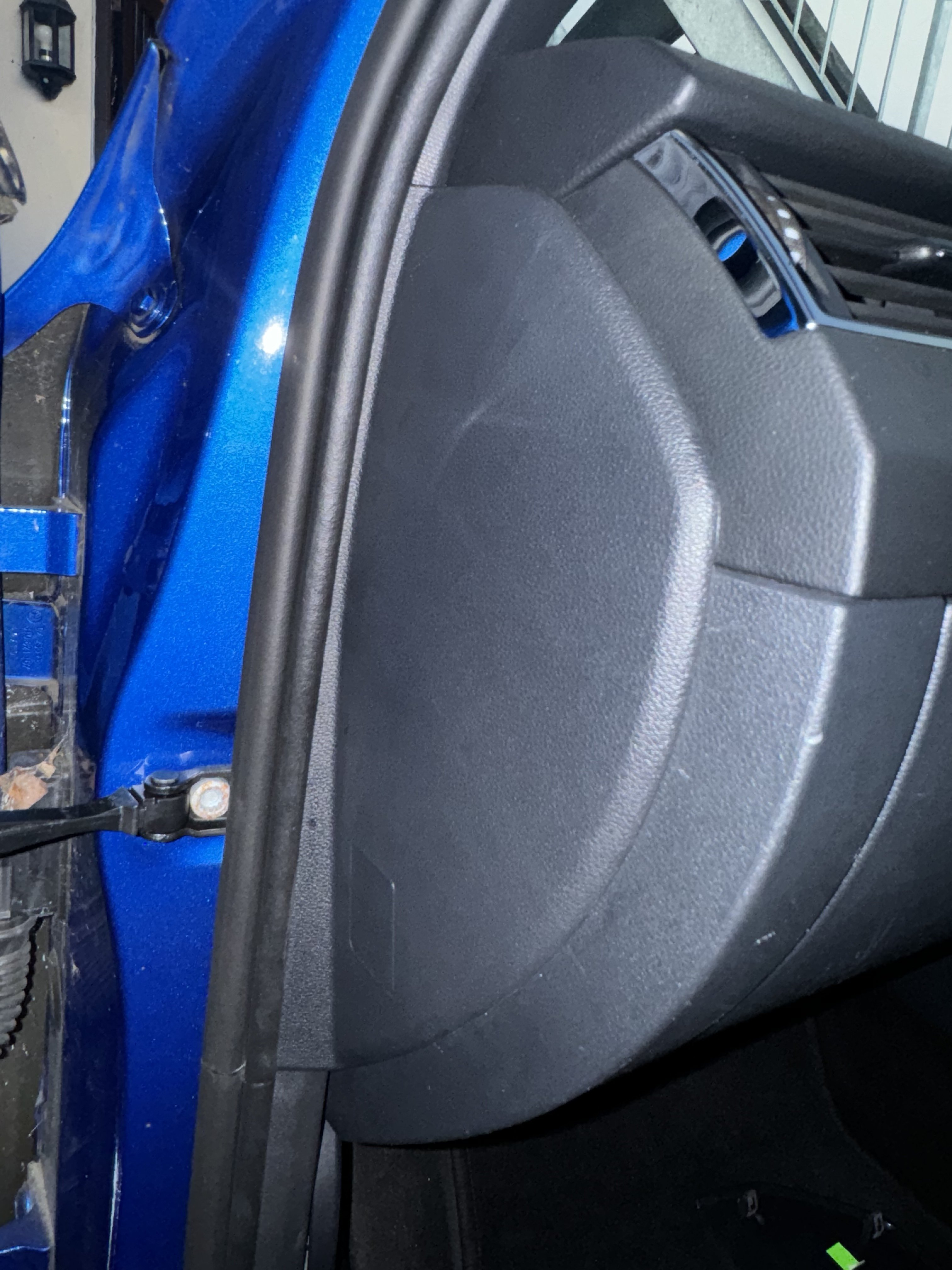

  2. Before feeding the pipe down, spray a small amount of white lithium grease (or similar), it will help to attach the hose. Feed the air pipe down behind the left side, in the gap just above the cabin filter. (Picture 6).
  3. Install the cooled glovebox valve into the top of the glovebox by pressing the valve up and into the gap, not from above.
  4. Attach the air hose to the cooled glovebox valve (picture 7) and reassemble (following the glovebox removal instructions in reverse order).
Note picture 1A and 1B are the last two images.

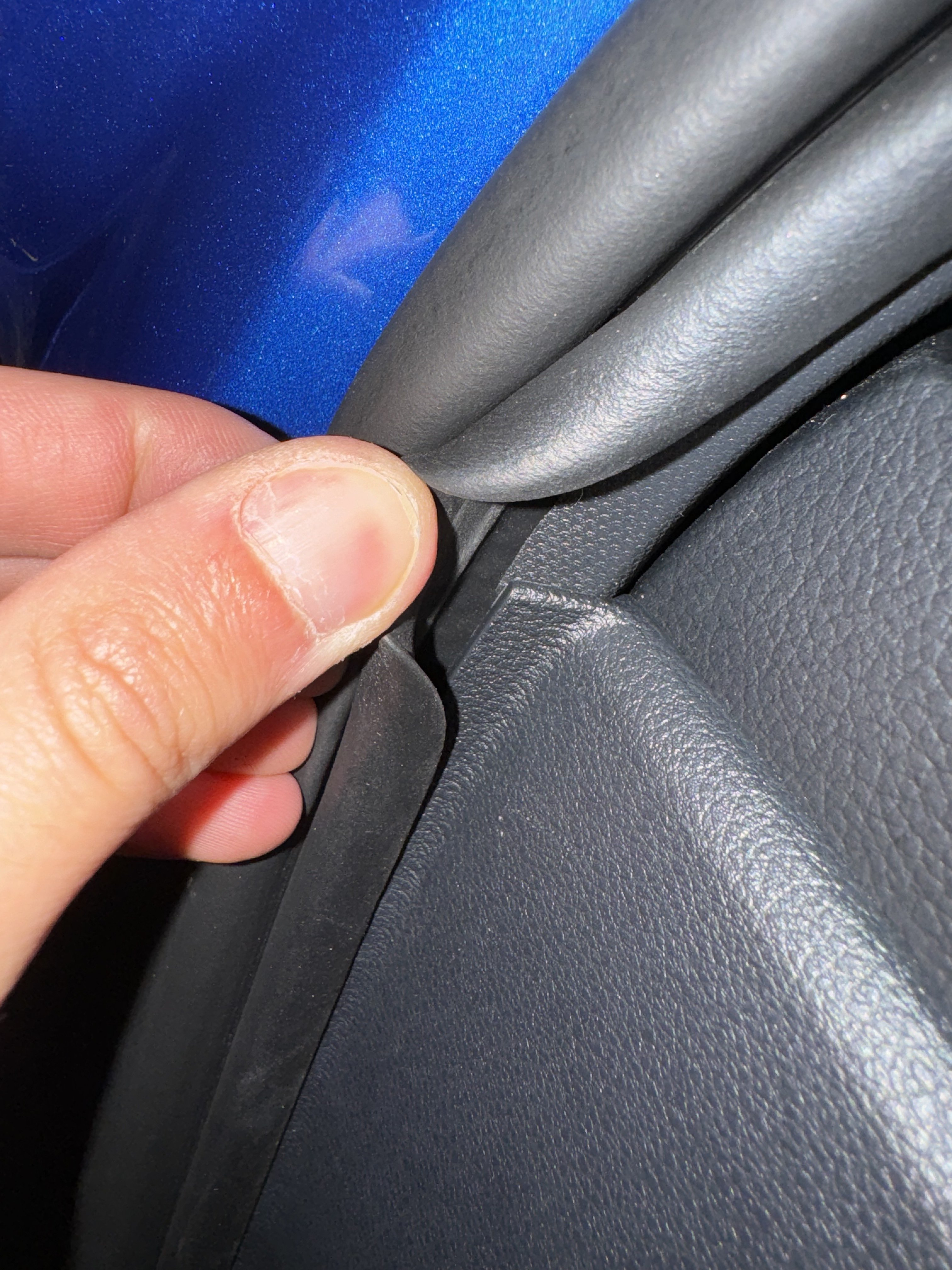

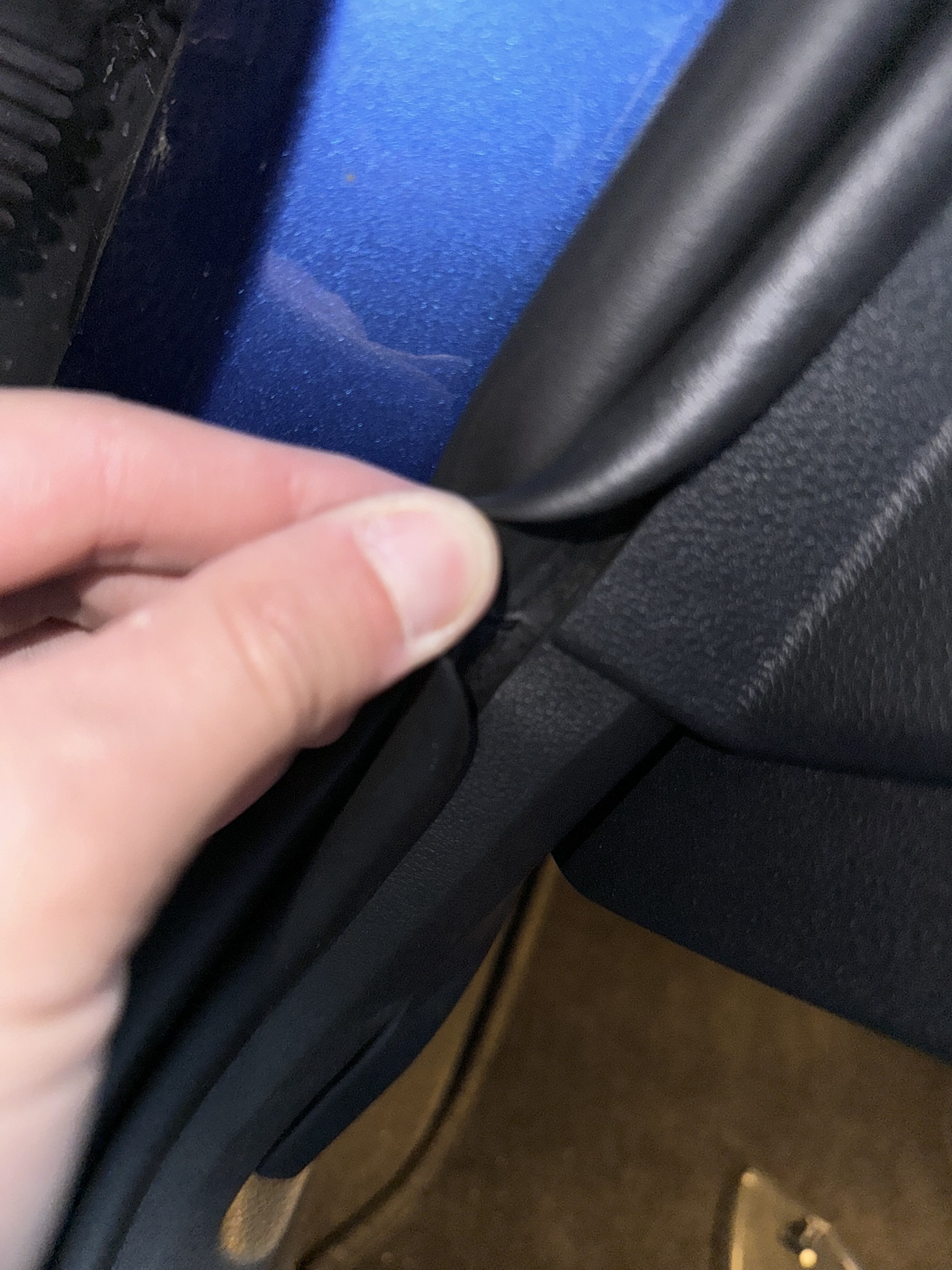

@skylex95 @XTad @aaaaplay sorry to come back to this a few months later.
That side panel, can I just confirm 100% that while it sits underneath the seal, it sits on top of the sill trim and the pillar trim? I.E. like in these photos.
Thanks guys :)
