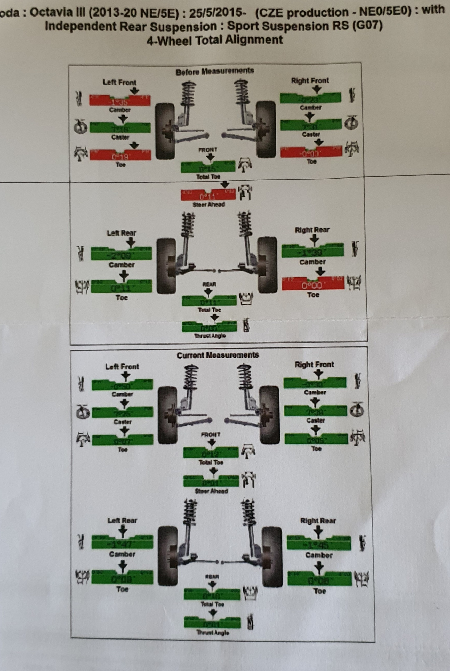

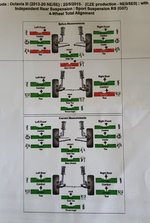

Firstly, the wheel alignment was well out.

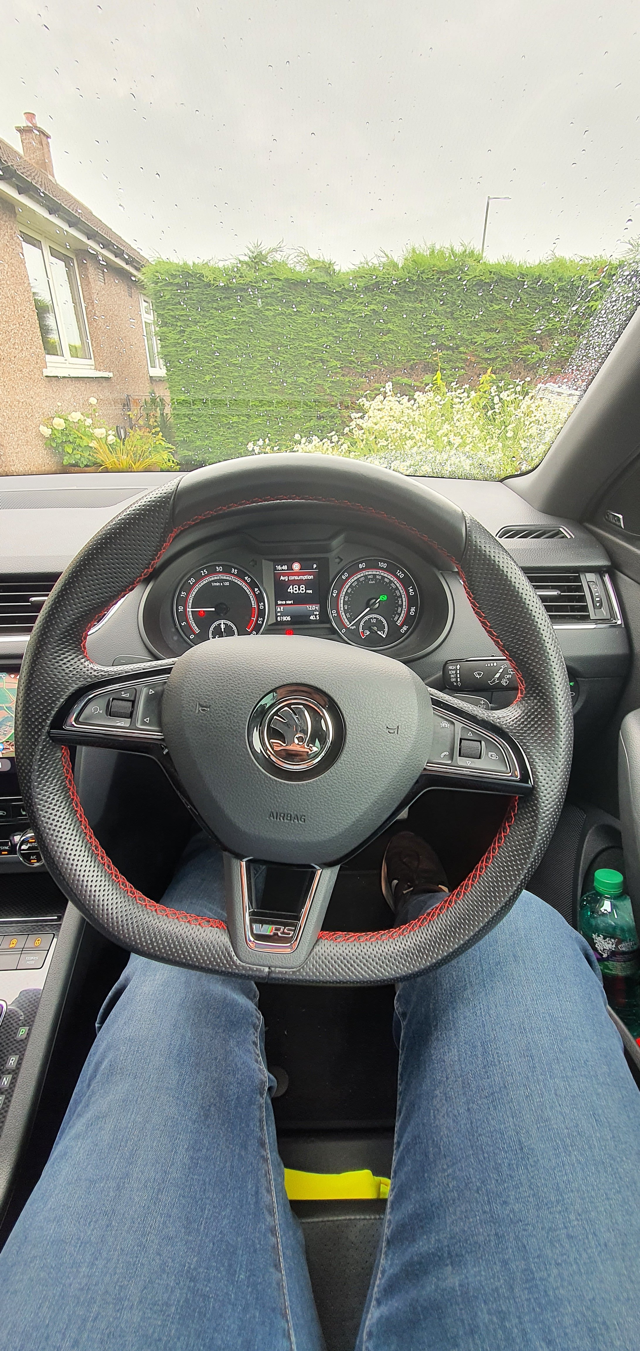

However, the centre wheel alignment wasn't done properly 😤
I am happier to report that in terms of driving the car, it is feeling considerably better.  The car does feel more planted and less like me driving on marbles.  I'm also not fighting the steering.  Looks like the front nearside got cloughted by the previous owner.
There was an earlier comment about handling and the electronics.  This car has XDS+ : in essence stability control.  It means that if the car detects you are in an understeer situation, then it will dab a brake caliper to bring you back into alignment.  This will explain the understeer / oversteer situation.
The other piece of good news is that my MPG seems to have recovered.  I'm now getting high 48-52mpg figures again (yah - cheer).
I'll be visiting WES again to get the centre align of the steering wheel sorted next week.

The car went back to WES for another go at the steering geometry - this is now all sorted.  I have a car that steers straight.
