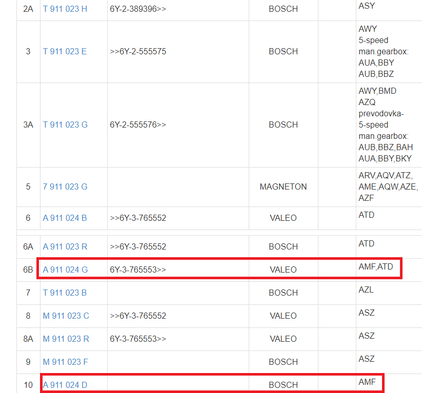

I think it'll be one of the two here:
2055865608_Screenshot2021-07-1016_20_40.thumb.png.f7d54eaadb46c20efeaa24d89d870ff1.png
You'll have to stick 02 in front of the shortened part number as written there, so either 02A 911 024D if the present unit is Bosch made, 02A 911 024G if it's a Valeo one.
I suspect based on the starting chassis number quoted for the suffix-G one, that'll be what you have. Is the 10th digit of your VIN a 4 or 5, rather than a 3?
Thanks -Wino. Digit is 4 . immaterial now as just after I posted it said no and AA had to help me. Gambled on the heavier one from Euro ( 2KW) which fitted , with a lot of help from youngest son, as I'm housebound without car.
