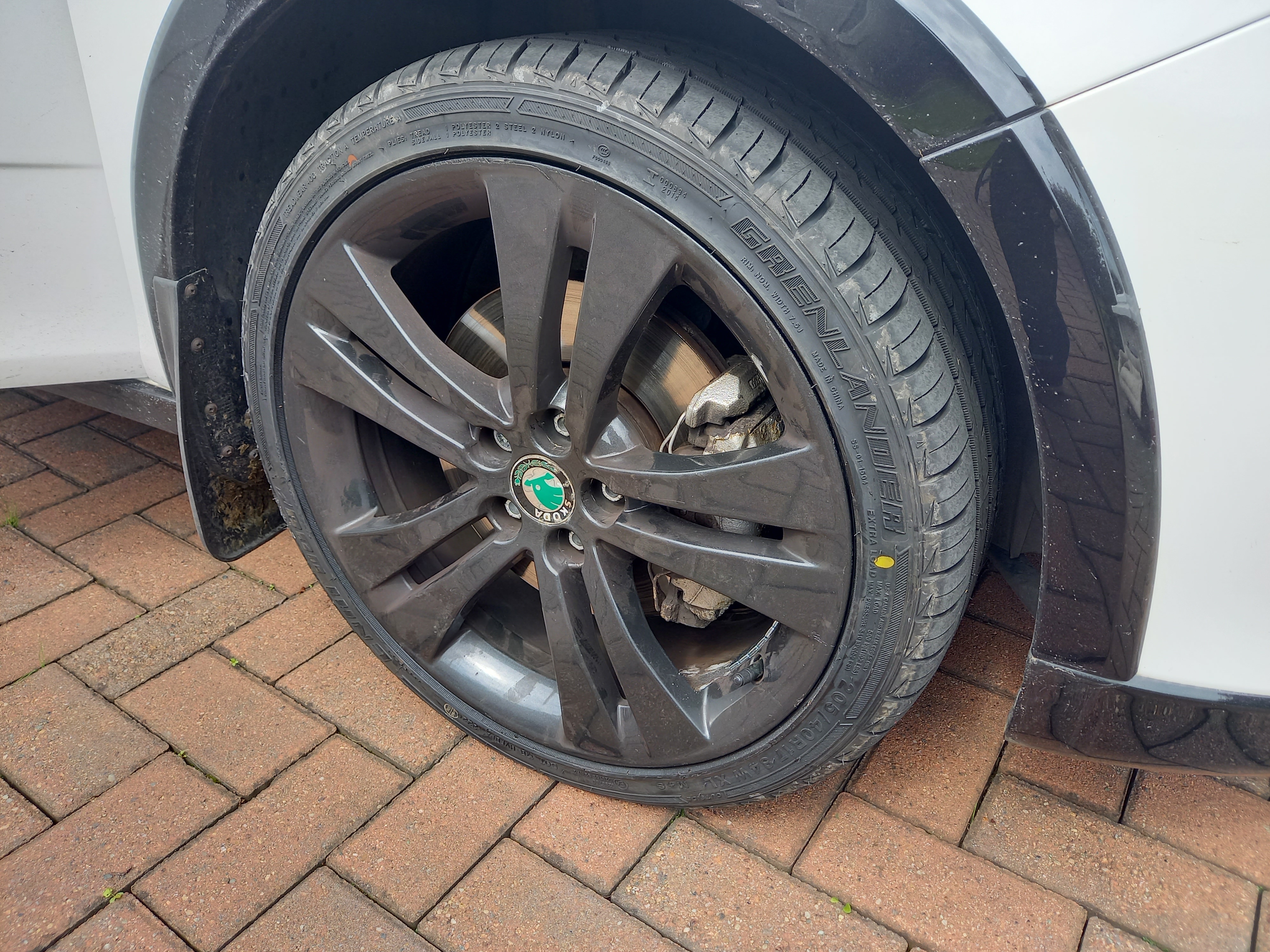

If they look like this they're standard wheels.
I think 205/40 R17 is the standard size, but people have run 205/45 and 215/40 before.
Exactly, its those wheels. I thought maybe it could be my tyres but I changed them last year (all 4) and it only made a minor difference. Maybe it's worth spending the money on some contis (have Maxxis something or another atm), but I'm not convinced this is the issue in my case, given the steering wheel also wobbles a bit when the winter tyres are fitted
