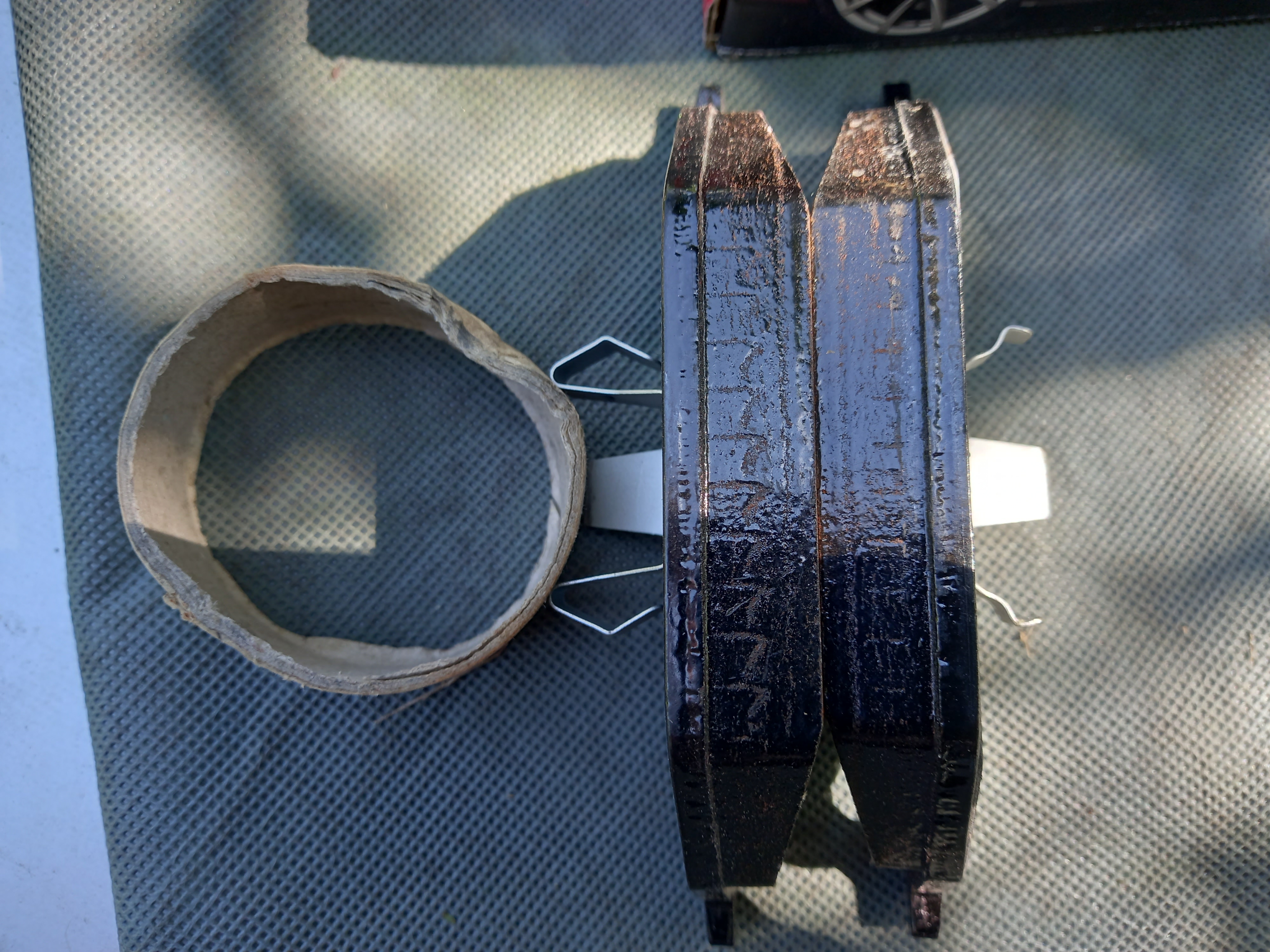

Note: Not sure what disc size you have, but on our bog standard Octavia with 280mm discs, (FSIII) the 4 pads may look at first glance identical, but are in fact two sets of 2. The spring clips on the backing plates are slightly different depending on whether its fitted on the piston side or the outer side. Get them the right way round otherwise ime you'll find your brakes develop an annoying squeel!
In the pic below the one on the left with the curved clips on all 3 prongs is the piston side.

^ Nice bit of info on the difference between retaining clips, here's a photo showing the inner pad on the left, outer on right, from an angle which makes it easy to see.
