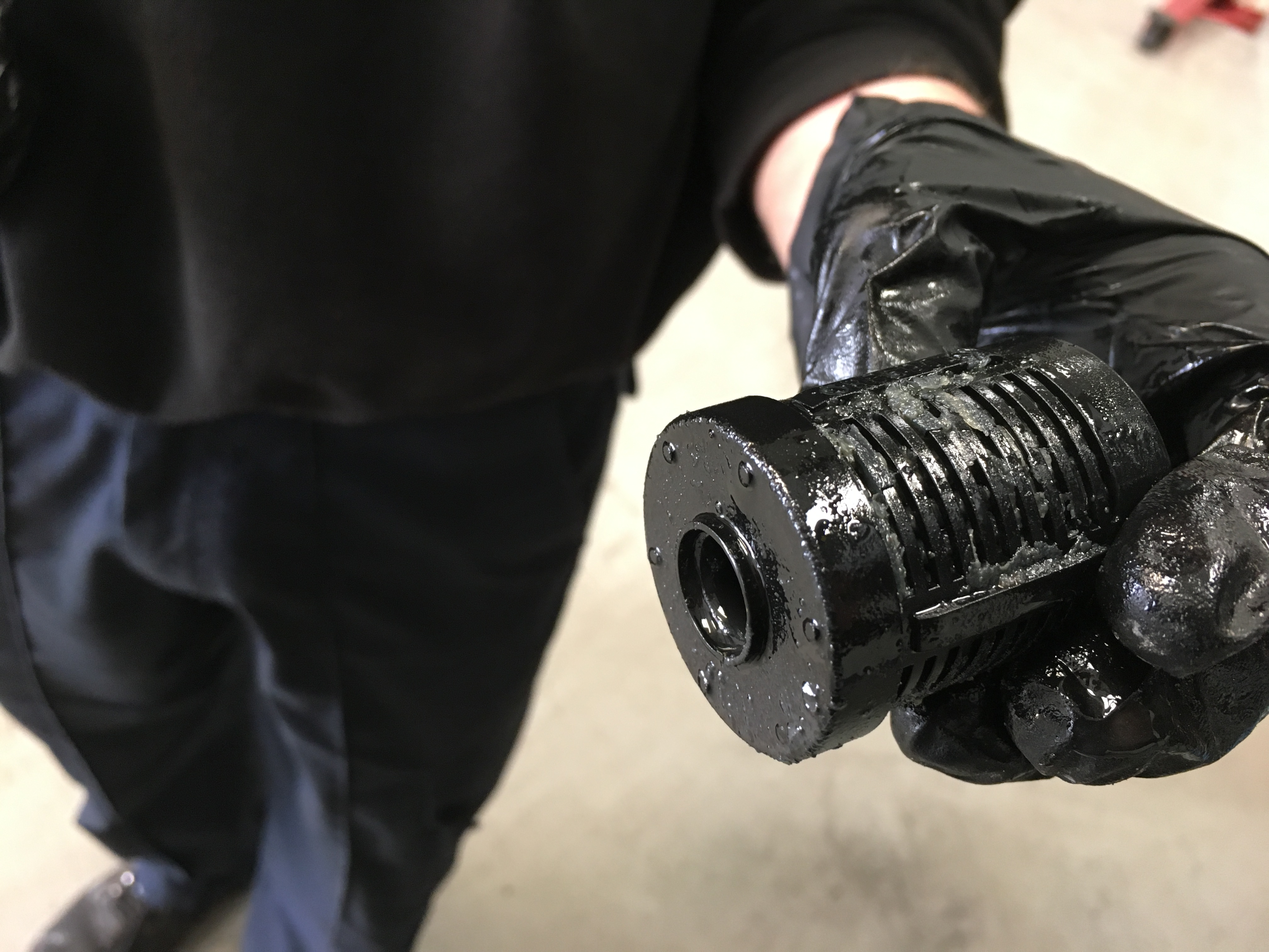

If it’s a gen4 Haldex make sure the hidden filter (not shown on Skoda’s parts diagram) has been changed.
This was mine after 8 years and only 33k miles.
@mustang86
By a 3 year service regime on the Haldex it should have been properly serviced 3 times.   By a 30,000 mile interval we have no idea.
At least 2 services carried out on the Haldex would have been nice.
You need to find out the state of the Haldex and if working, if serviced or needing serviced or more than that.
