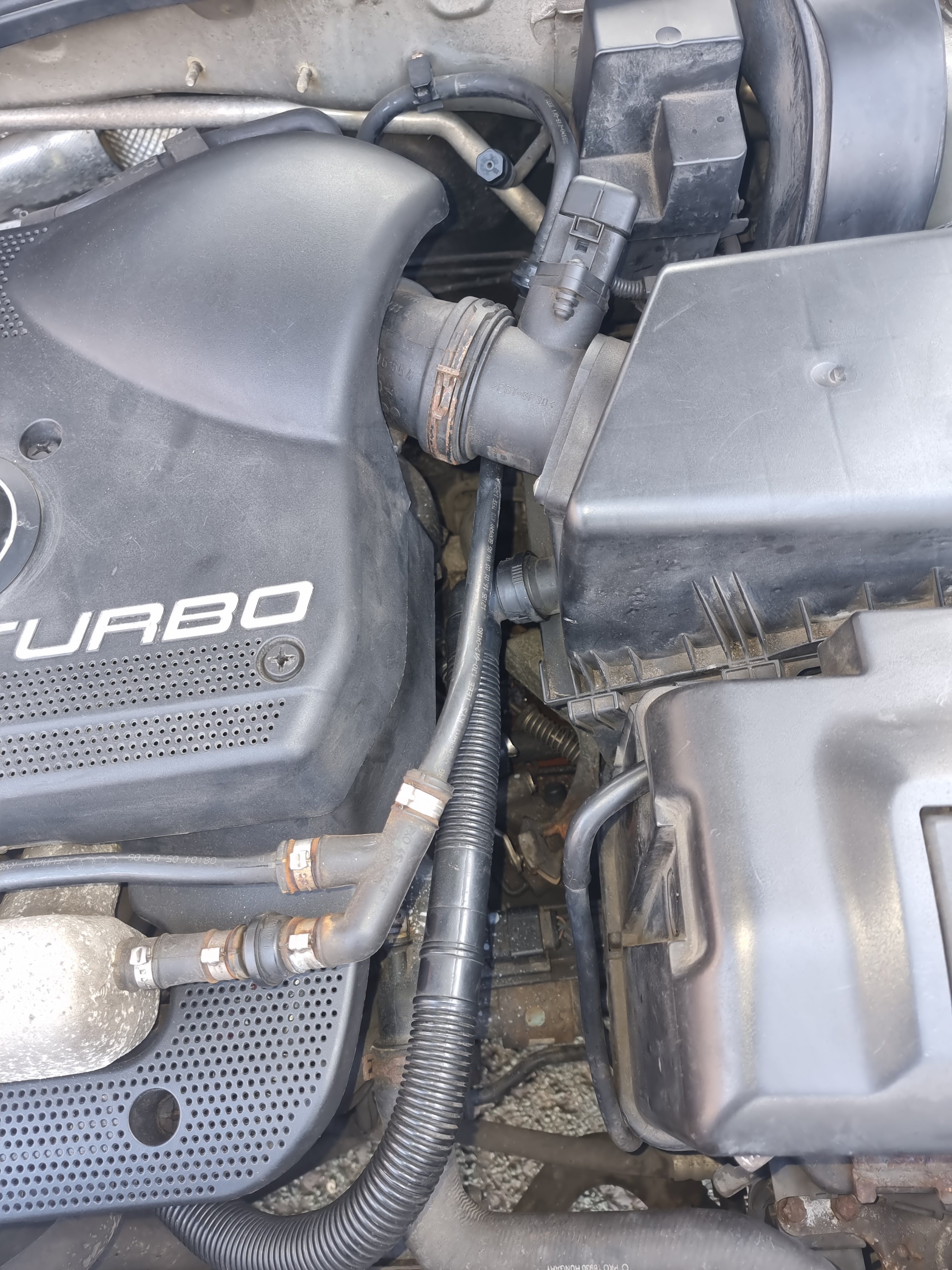

Phil beat me to the punch. For the passenger side I would say the CTS housing.
Example of mine-
Thanks Phil... that's something I never thought of and yeh hopefully the pressure test pin points the issue 🤞🤞
And thanks Dean for pics... that does seem like a likely suspect !!.. fingers crossed its as easy fix🤞... il update you guys Monday when I know more 👍

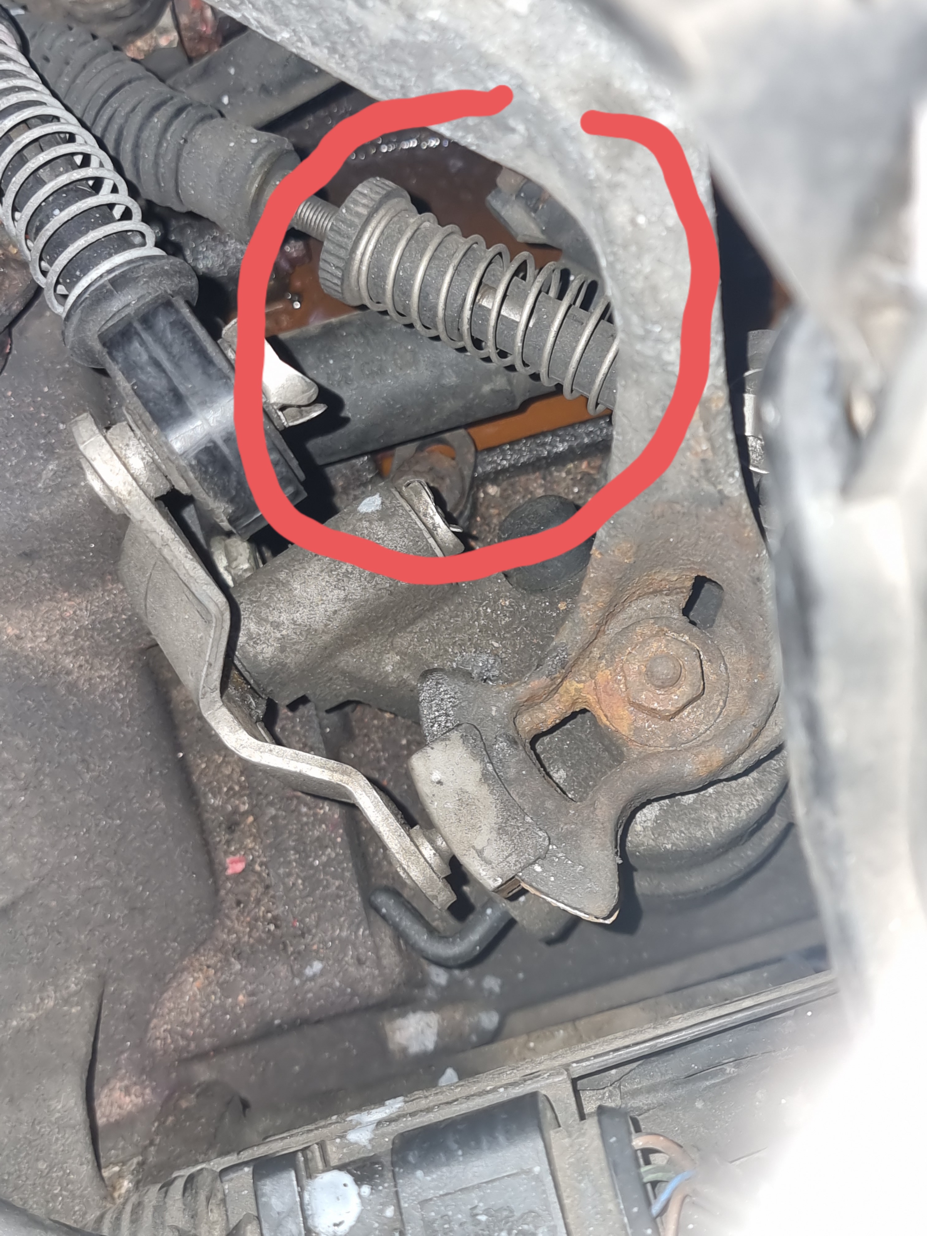

You can see where the water is accumulating...

Same place mine was. So it’s going to being around the housing somewhere.
That puts my mind at rest a bit..  thanks Dean 👍
Yep, I'll second Dean on that one.
Mine did the same, had a crack nearly 8 mm long in the casing
