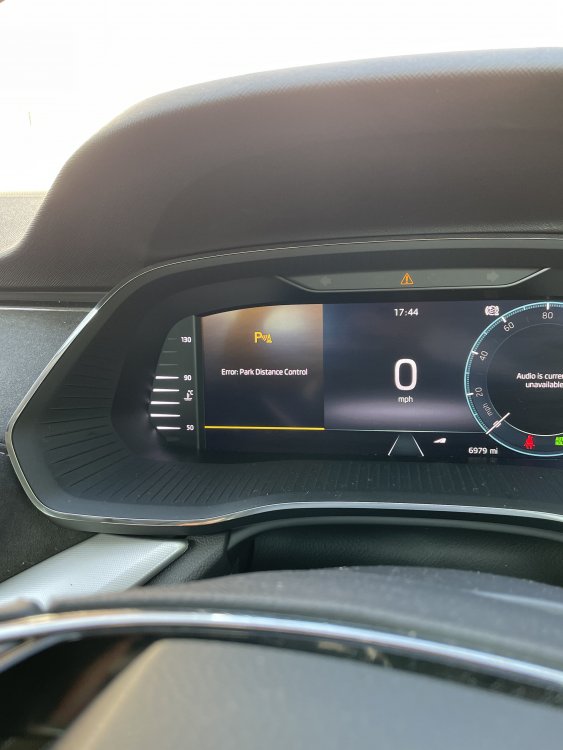

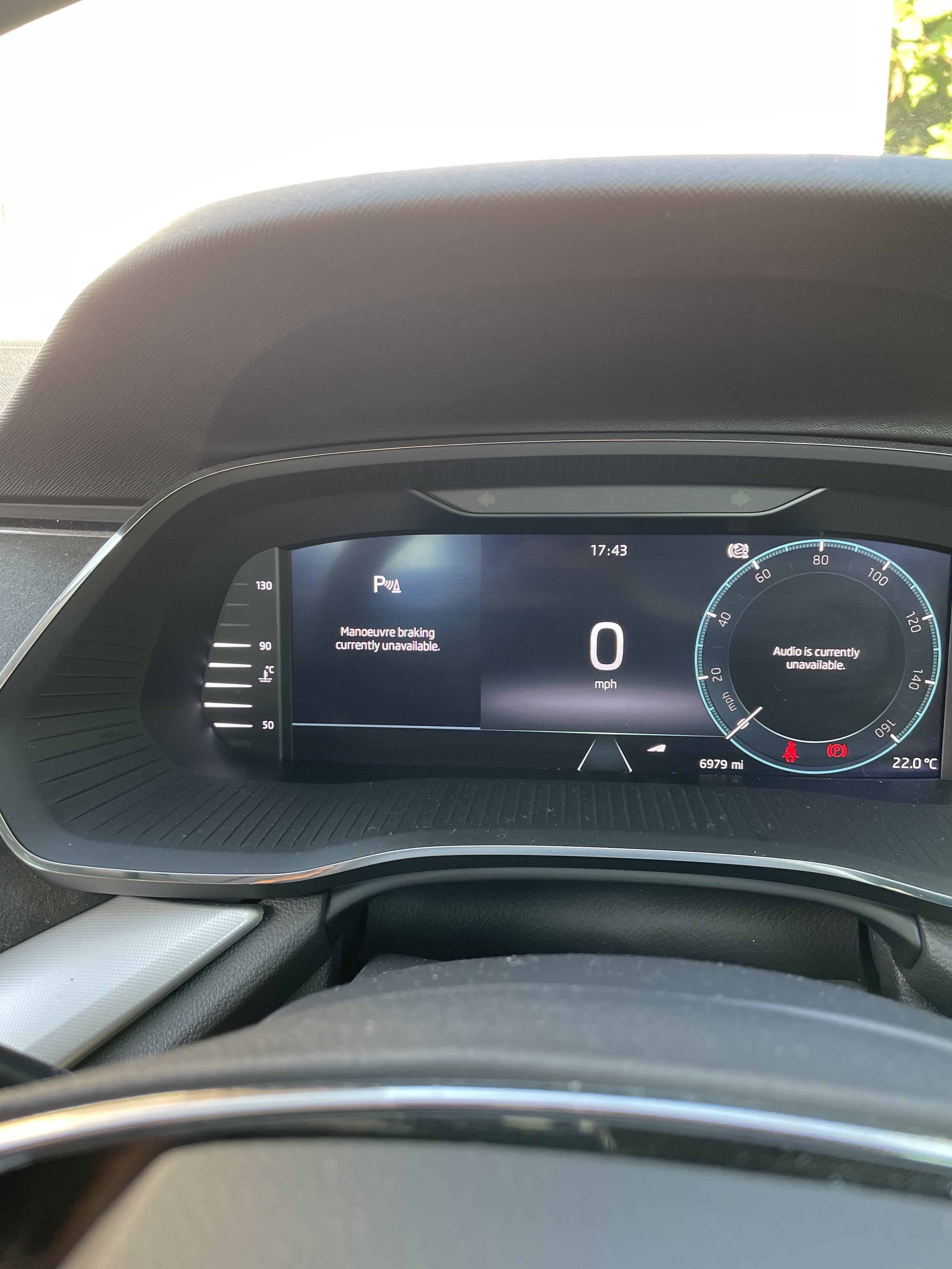

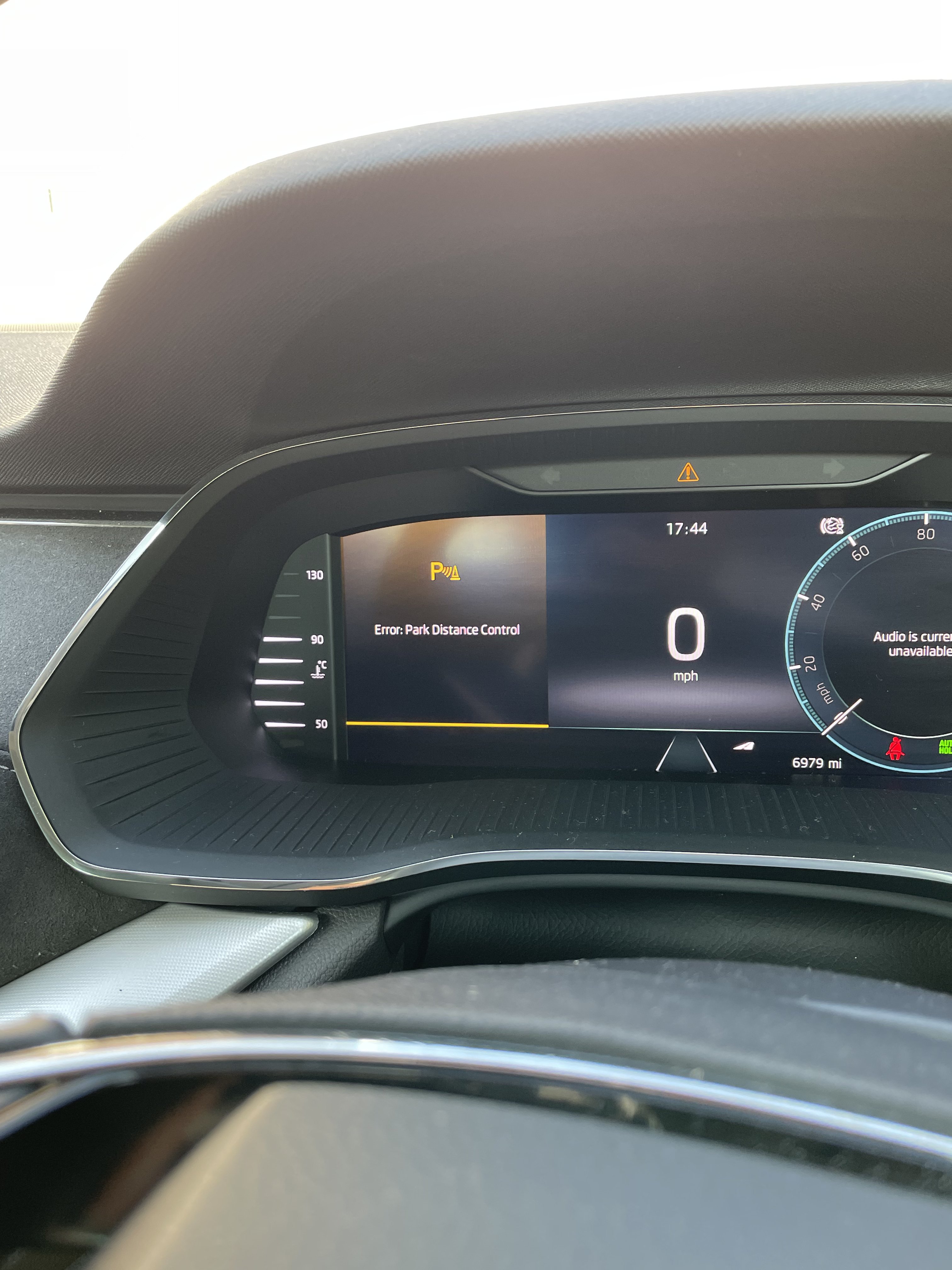

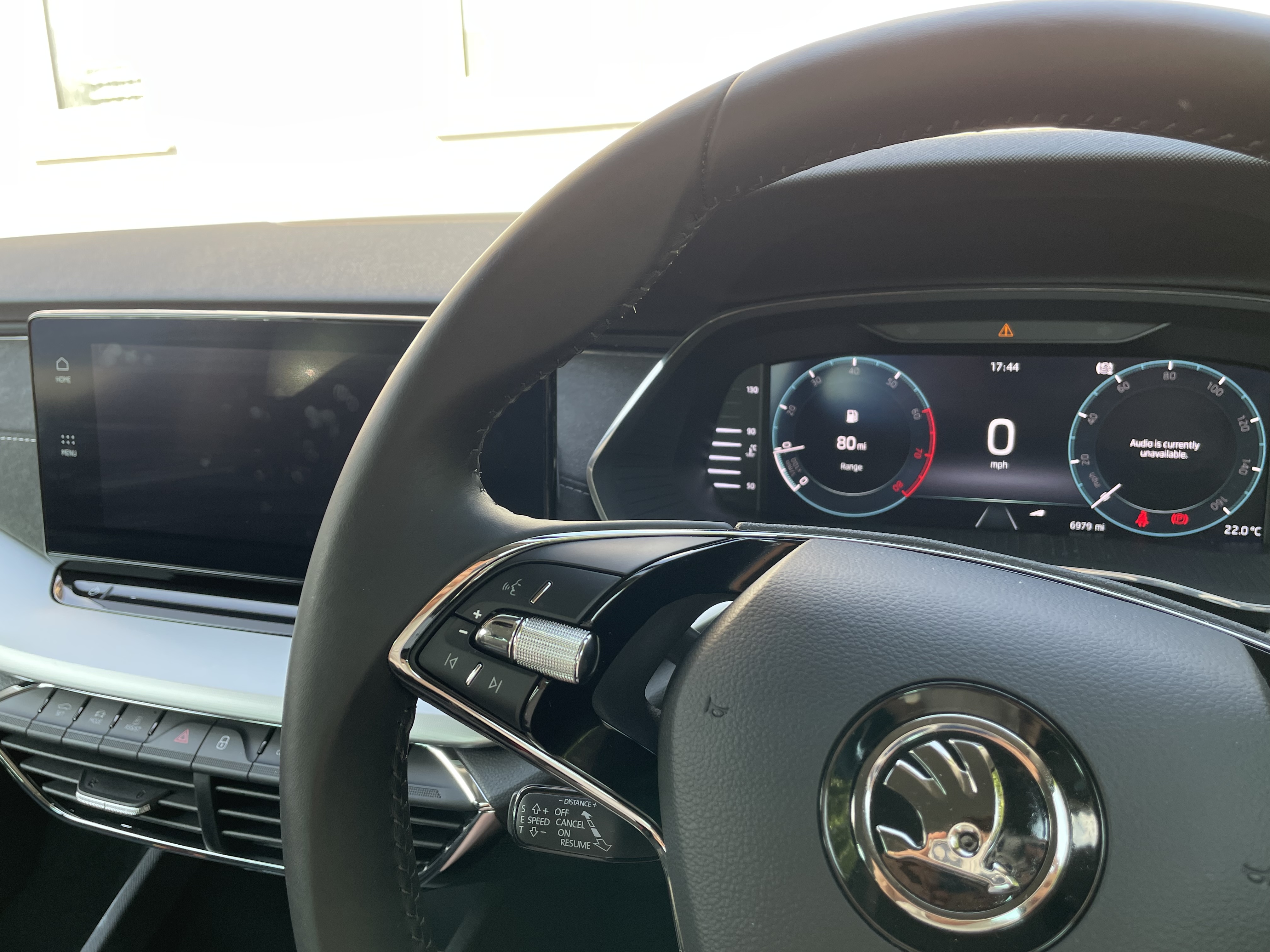

Today i fire the car up and I get plenty of parking sensor issues (photos below) but most depressingly nothing at all of the infotainment screen. Dead.
It drove fine (with exception of parking sensors) but ACC was working ok.
I’ve tried swapping a few fuses around head unit and parking sensors with my working rear usb fuse but nothing changed.
any ideas or am I off to the dealer? Can I try and force a restart of the unit?

You can hold down the power button on the head unit to reboot it, otherwise take it to the dealer. A few people on here have had new head units under warranty

yep that didn’t work either. Off to the dealer I go… joys!
