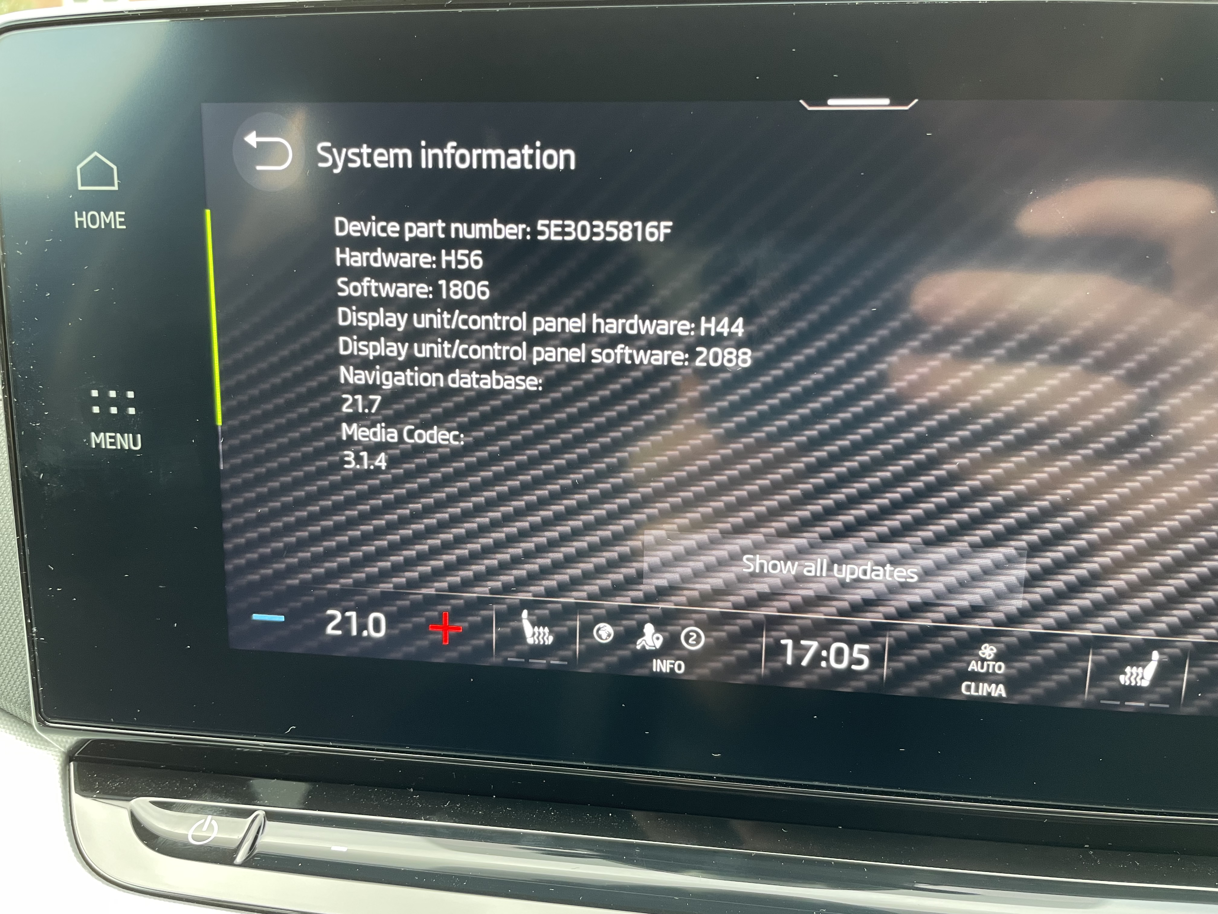

  2. I’ve just had my SOS unit replaced and I’m now on hardware version F and software 1806. I can confirm that on Apple CarPlay I now have turn by turn navigation directions on the speedo screen which I didn’t have previously.

  6. Sure thing. The update reset all settings so I’ll take a look when getting everything back to normal tomorrow .

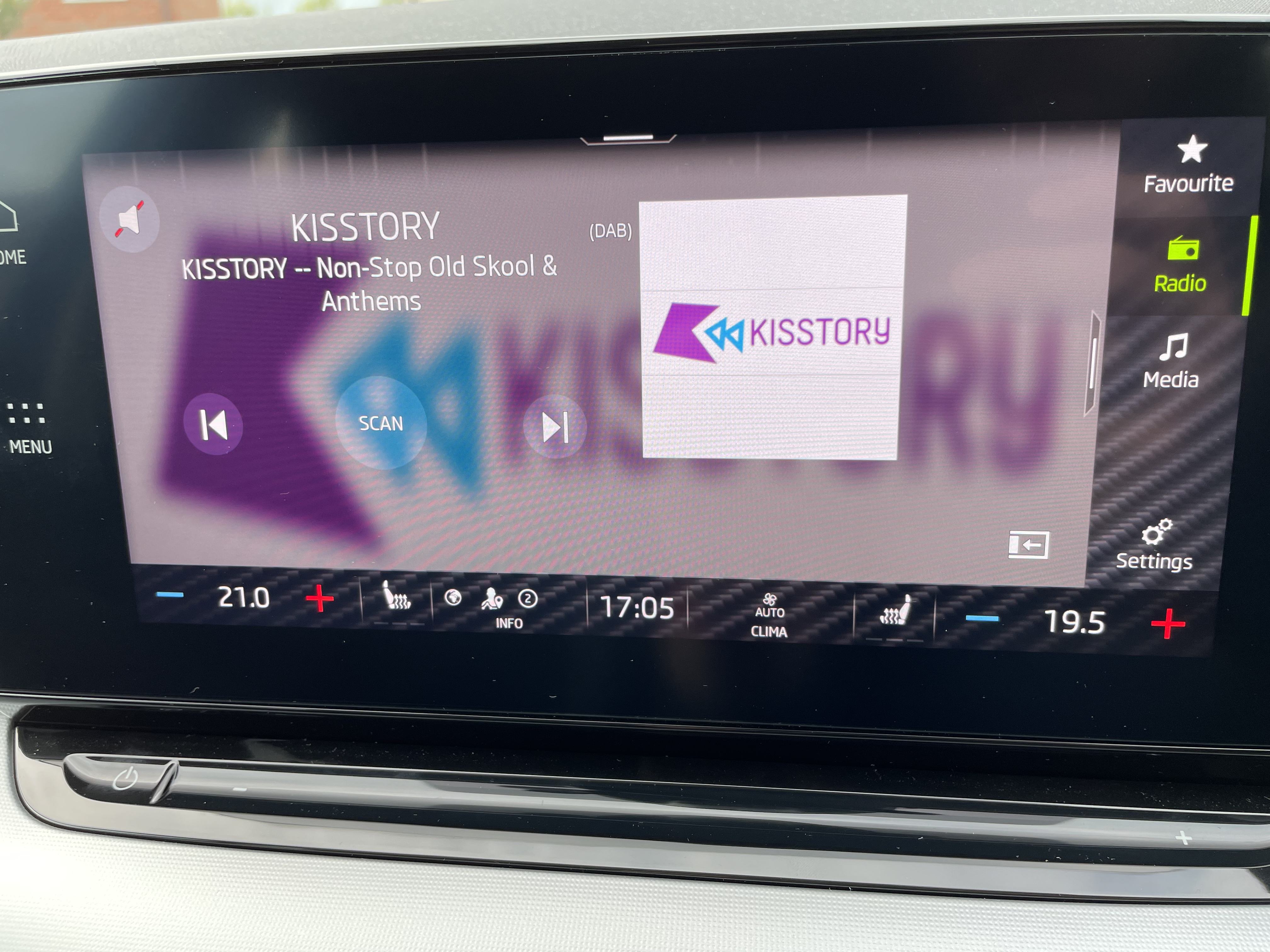

  8. My car was in for an SOS unit replacement today. I’ve been lucky and this is the only recurring issue I’ve had (1.0 e-tec se-tec). The garage informed they had carried out a software update and I’m now on 1806 from 1688, oddly the hardware has gone from B to F as well ive not had time to try much out but the radio logos are more snazzy. There’s also a hint to the pop out window on that screen too. Some text is smaller and sharper
