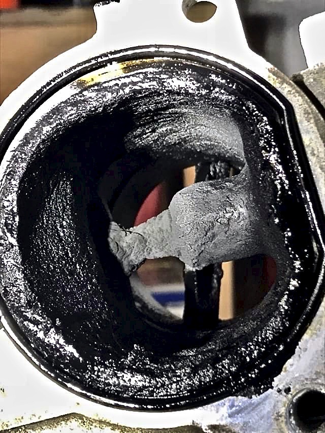

BMN you say...?   Does it have the original inlet manifold with swirl flaps?  If so, at that age it's most likely well and truly knackered.  The flaps stick and break up.  In extremis, they get sucked into the inlet with disastrous results.  Also, the spindle bushes at each end of the manifold wear and leak oil and boost pressure.
The cure is to replace the manifold with a BKD one, without the flaps.   You can either source one from a breaker and get the required gasket and bolts or buy the complete kit from Darkside Developments.   https://www.darksidedevelopments.co.uk/products/ppd170-used-bkd-aluminium-inlet-manifold-conversion-kit.html

In the process, it'd be wise to clean the EGR and ASV.  I know the feeling about getting older and more infirm.  At 68, I gave up lying under cars and poking under bonnets a good few years ago.

Can I get a terraclean (or similar) to do that for me?
I recently ish did inlet and egr cleans on a passat and golf 4 (both pd130s) and hated it.
The passat was a little more fun since I used fire to burn all the rubbish out (and who doesn't like playing with fire eh?)
She's in her 40s (ex mechanic) with back and hip issues, I'm mid 50s with a knackered elbow and back problems..
I was thinking of getting a decent creeper, see if that would help..
I don't think Terraclean or CarbonClean would look at it.  This was the state of my Golf 170 TDI  at 9 years old and c. 75K hard driven miles.
