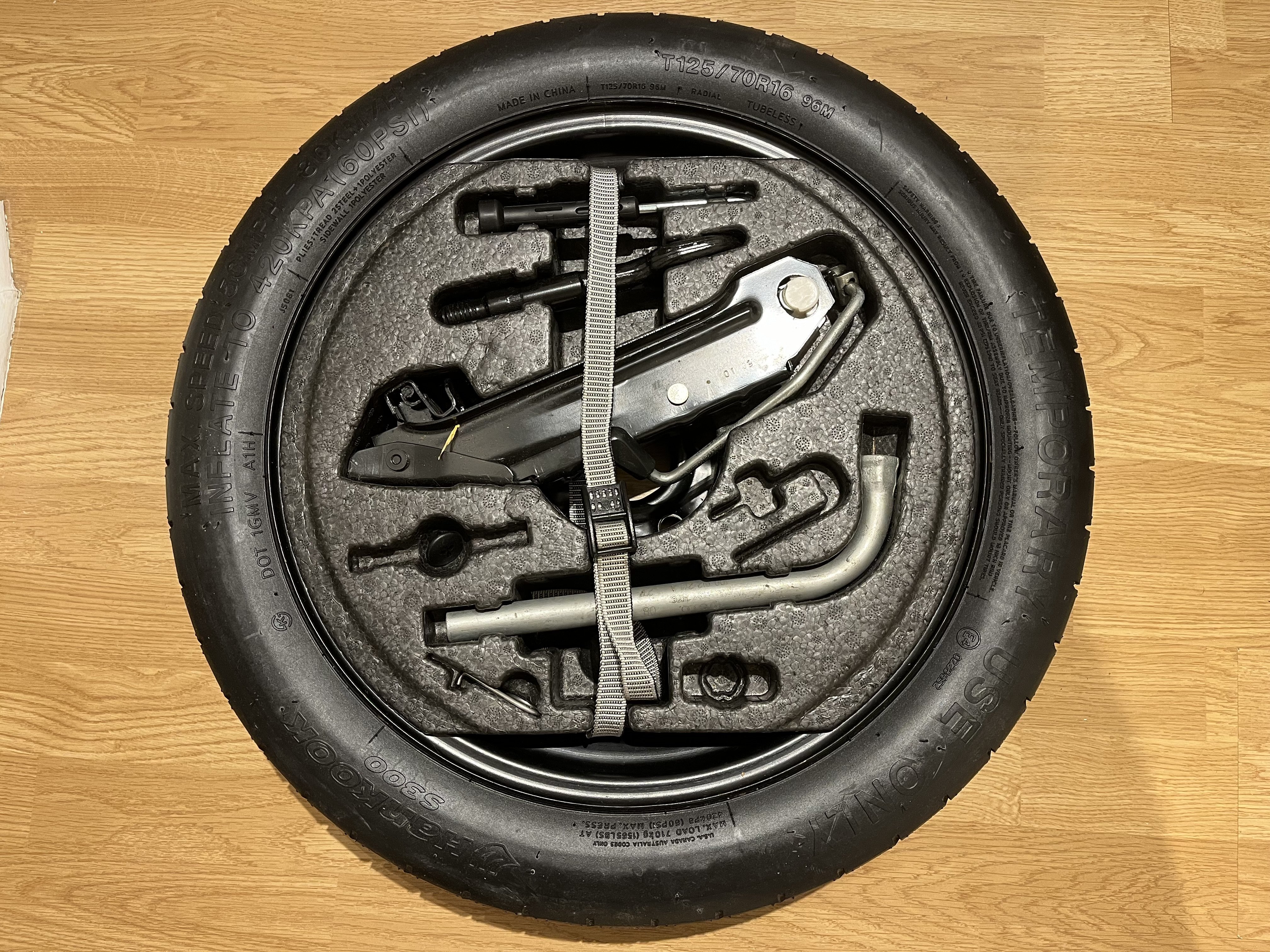

I have a space saver from my Seat Leon mk3.5, T125/70 R16. Wondering if this would fit my 1.5TSI eTec. Any idea?
Also, if it's the space saver do I need the foam on top? Is the foam and jack kit 5E3093860B for this?
Should I even bother or just sell it and get the Skoda kit?
Thanks

1 hour ago, Clodius said:
I have a space saver from my Seat Leon mk3.5, 125/70R16. Wondering if this would fit my 1.5TSI eTec. Any idea?
125/70R16 is tiny. Is it 125/70R18?
If it is 125/70R18, then you could use that because it is the correct size space saver tyre for the Octavia MK4 (even though it has an outside diameter a little bit smaller than the standard Octavia MK4 tyre sizes)...and will be fitted to a 3.5Jx18 ET25.5 5/112 57.1 steel space saver rim.
The kit is all you need (apart from the actual spare wheel) and includes support for the carpet, etc.
Octavia MK4 spare wheel kit 5E3093860B
Sada pro výměnu rezervního kola 18"
Edited by Carlston
10 minutes ago, Carlston said:
Don't you mean 125/70R18, ie. an 18" space saver?
No, I mean the R16. Funny, I had 225/45 R17 on my Leon and that was ok (luckily I never had to use it).
Ok, I guess it’s not worth the hassle. I might as well get the full size wheel and not bother with the foam overlay. I assume the full size doesn’t need it.
As you can see in the chart below, the 125/70R16 tyre size has an outside diameter a whopping 10.9% smaller than the standard 16" Octavia MK4 tyre size. Even a 5% difference would be quite a lot.
