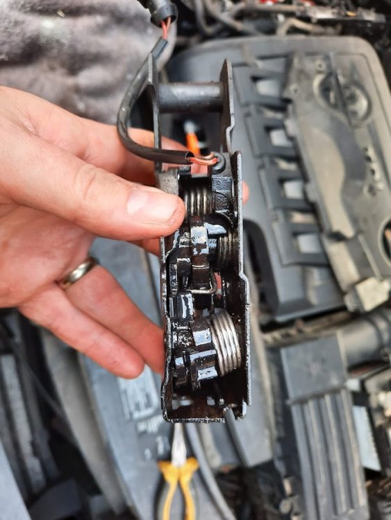

I had exactly the same.
It required a new catch.
Once I had the old one off, I could see it was broken inside.
The pin that runs through and holds one of the springs in place had sheared off. No amount of lubricant would ever solve that
New catch fitted and all was well.
