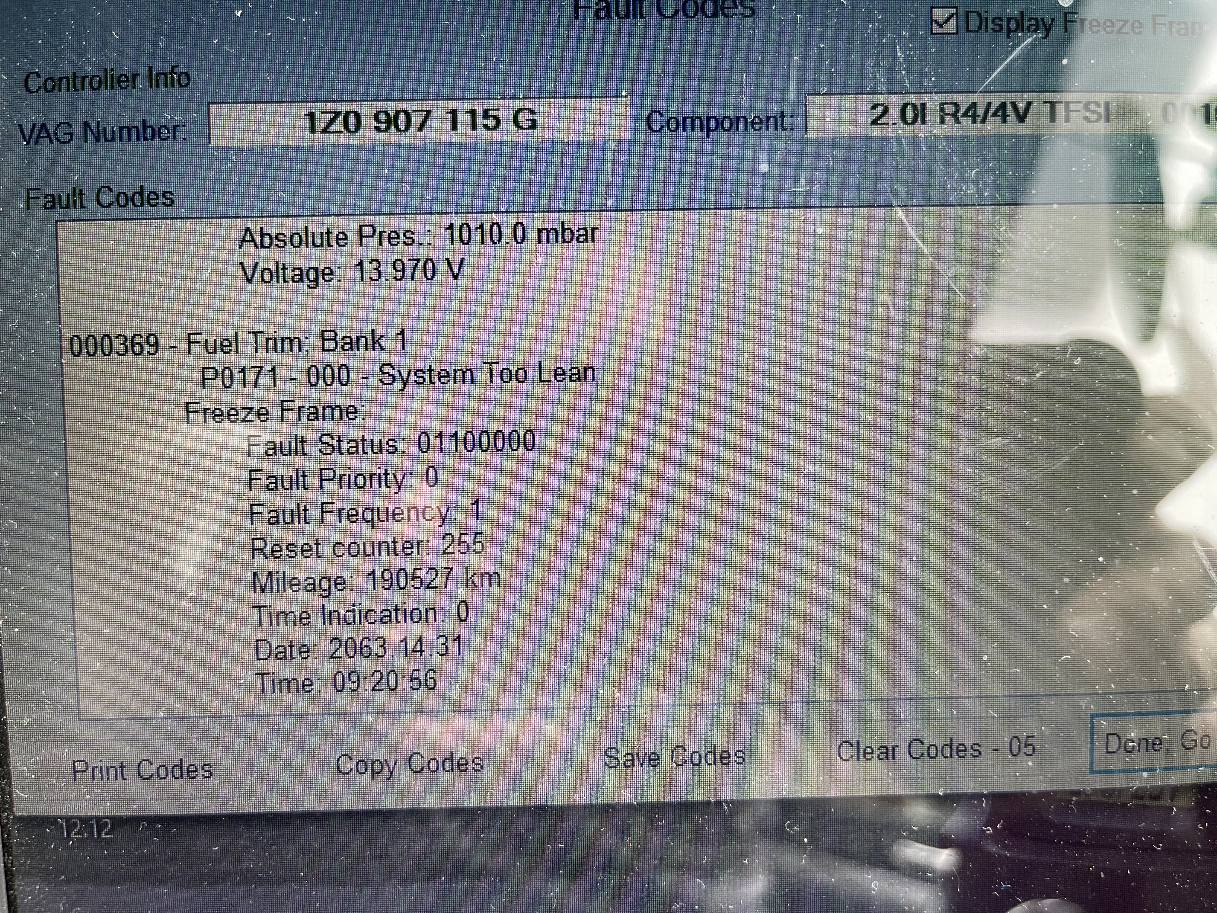

Just an update been using vcds this morning
I can’t post the other fault as says pic is too big
The other shows the other fault of the p0507 that was all
