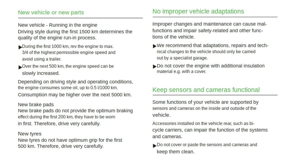

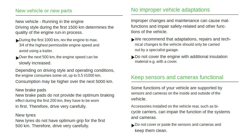

@zetzet  what break in period is this?
Where do you find information as a new owners on 'Driving in' a new vehicle other than in the Owners Manual?
There is the bit about may use more oil in the first 5,000 km that has been in manuals and is about all engines.
EDIT.
Found it in relation to the engine.
