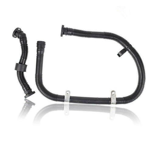

I had this exact same issue not too long ago, but for me it was giving me fault codes such as P0171 and P0411.
Ended up being a combination of the hose going from the PCV check valve (number 8) to the inlet manifold being split (that one is hard to see as it's covered) and the secondary air intake hose that has split.
http://i.ebayimg.com/07/!BysQ2hQB2k~$(KGrHqIOKkYEwPTKcfjNBMS1M7Uzw!~~_12.GIF
I had to replace number 4 to resolve this, along with the SAI hose.
2X Car Secondary Air Injection Pump Hose for Jetta Golf MK4 Bora AUDI-TT A3 B3L9
Hope this helps.
