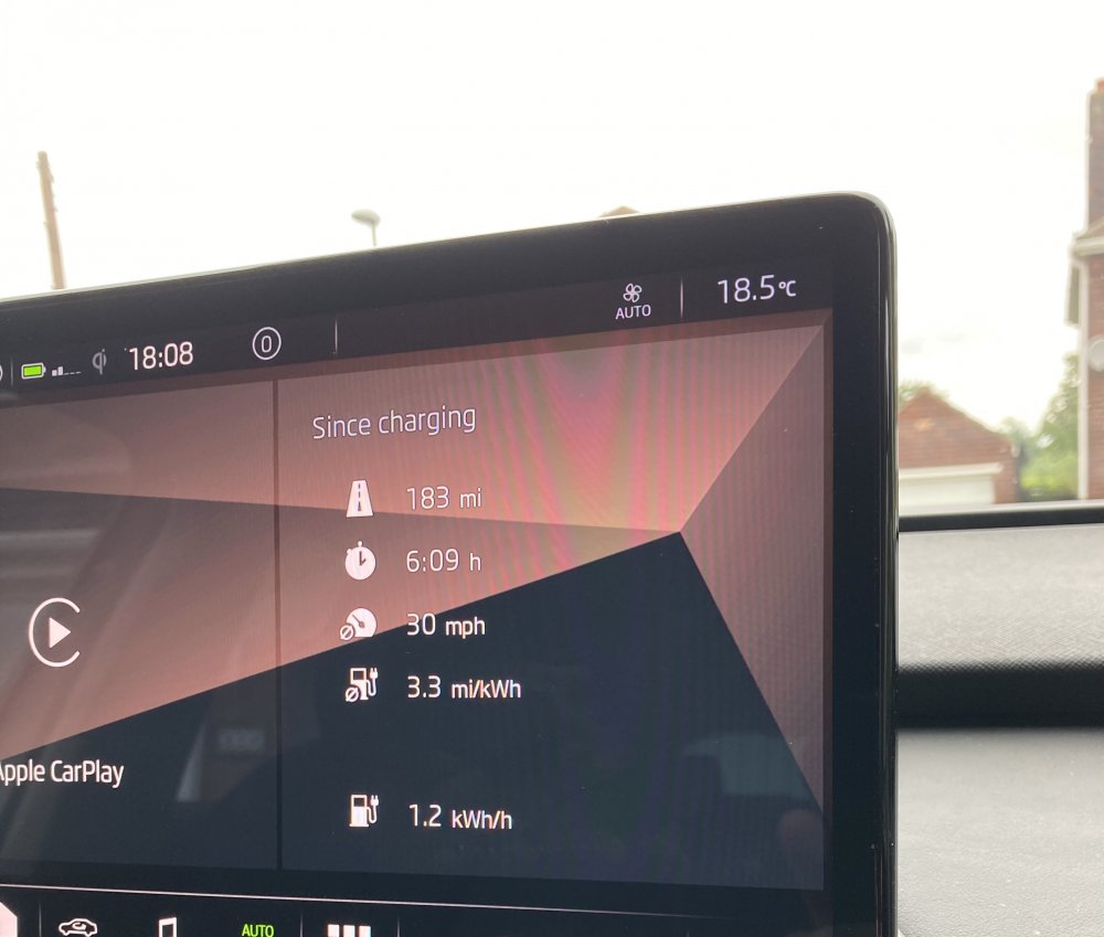

Hi, the longest single journey I’ve done is 183 miles. Started at 100% and an indicated range of 202 miles. Got back home 183 miles later with 8% remaining and an indicated range of 18 miles, so the cars initial estimate was only 1 mile out. That journey was a mix of urban, motorway and rural B roads. I did 70mph on motorways (probably 60 miles of the 183), 2 people on board boot full of stuff. That included 2 hours crawling through a traffic jam.
I have found the range indicator, which everyone seems to call a guessometer, to be very accurate. I think it helps that I am the only driver, It started out wildly optimistic when I first got the car but it soon adapted to how I drive and use the car. I don’t drive it hard, but don’t hang around and I’m definitely not going to be sat at 56 with no heating or aircon, or slipstreaming lorries. I have the climate set to 20 C and just leave it to do its stuff pretty much all year round.
They are definitely way more economical around town in stop start traffic.
