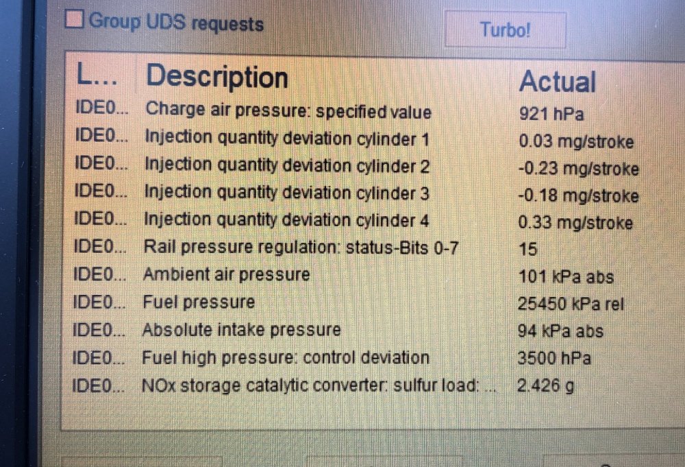

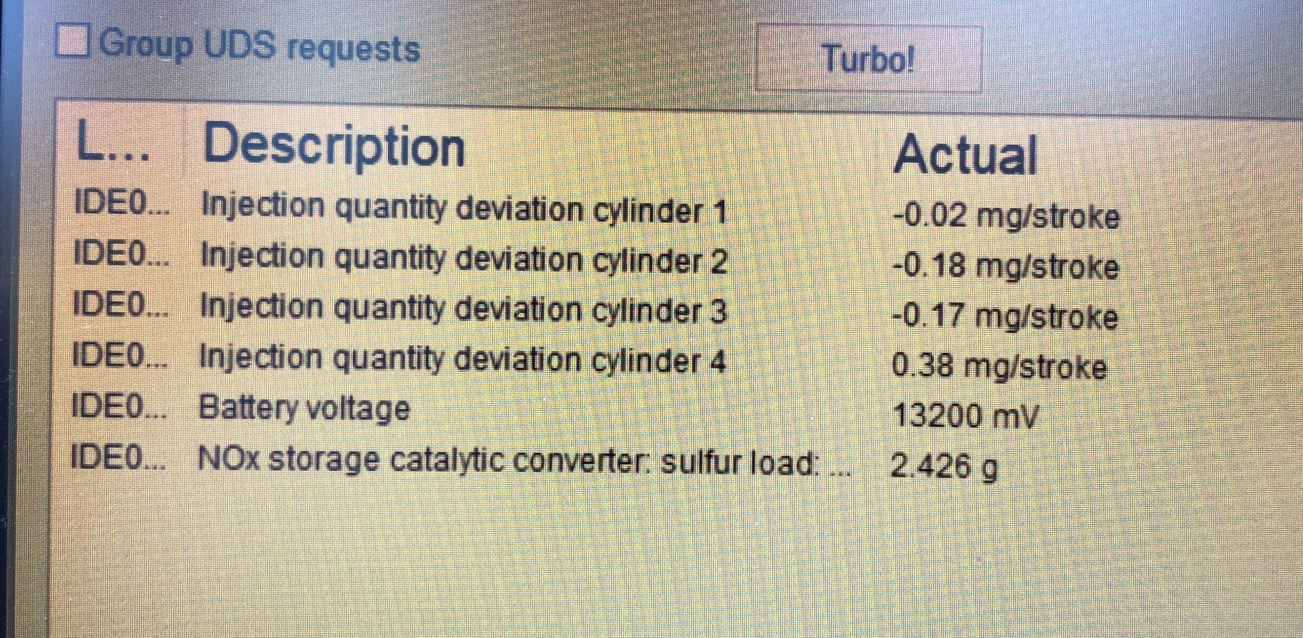

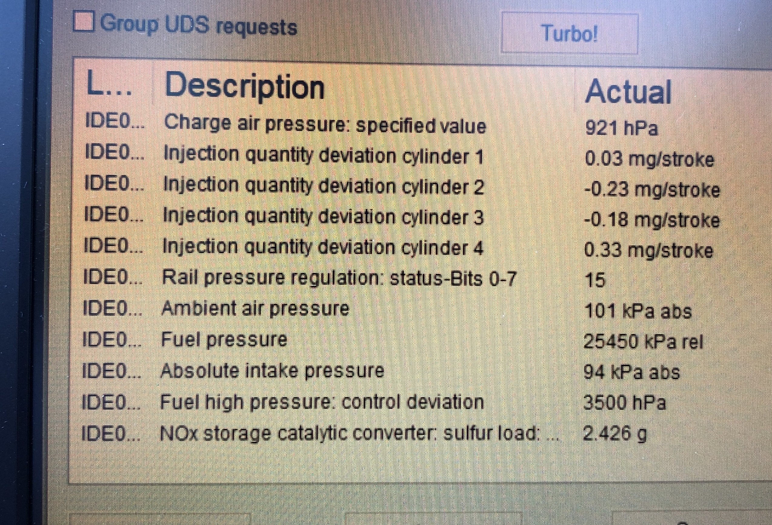

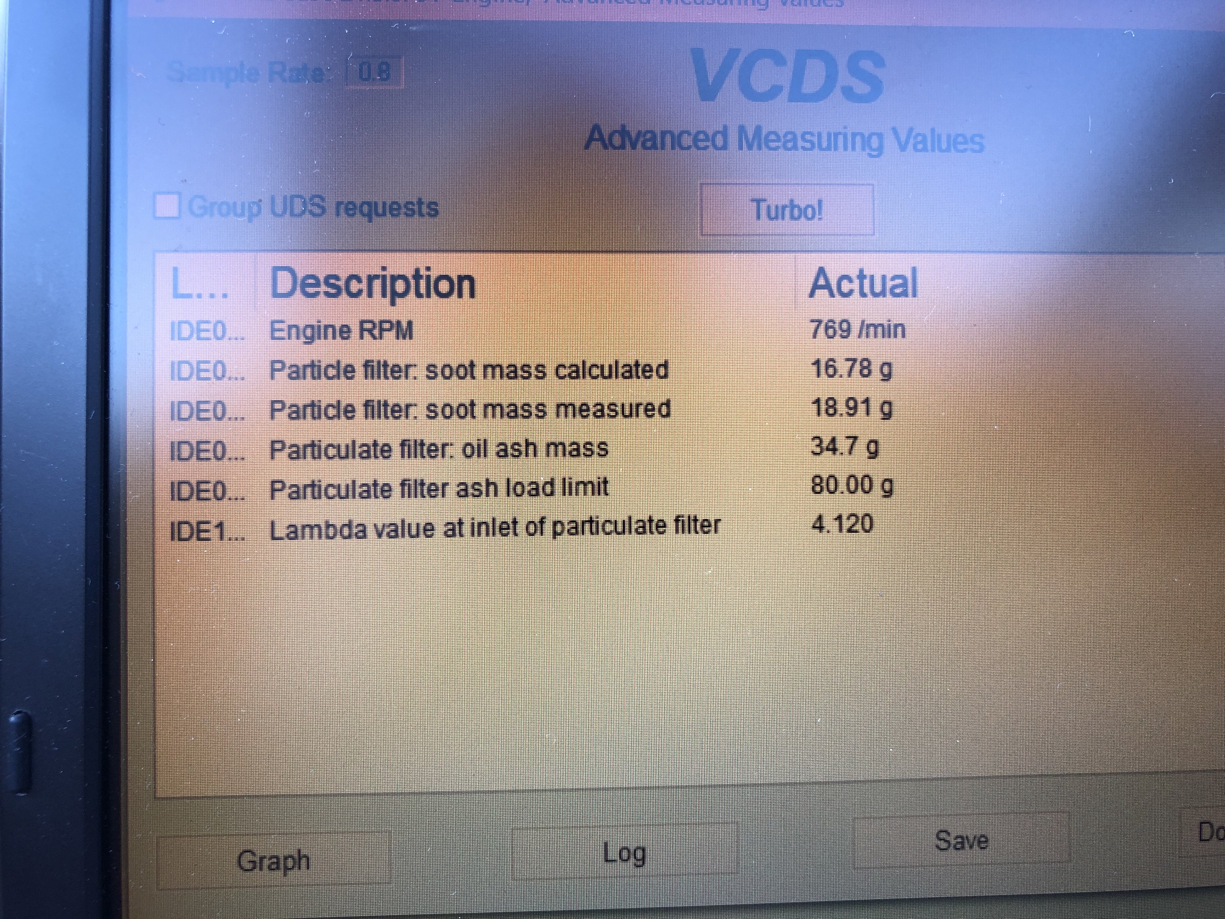

   I am trying to make some sense from the vcds measurements on my recent  purchased octavia 2016 2.0 tdi. If someone knows better what this numbers means please let me know, from what I understand one injector is going bad and oil ash mass a bit high. Car mileage 110000(working properly).  If are other topics similar and I have miss them please link them below. Thank you
I wouldn't have said oil ash mass is a bit high, I'm at 73000 miles and mines on about 26g. 80g is the limit so you're still a way off that.
Regular oil changes and allowing DPF regeneration to happen fully when it wants to, will keep it low, but it's inevitable for the DPF to "eventually" need replacement but at what mileage is impossible to predict.
