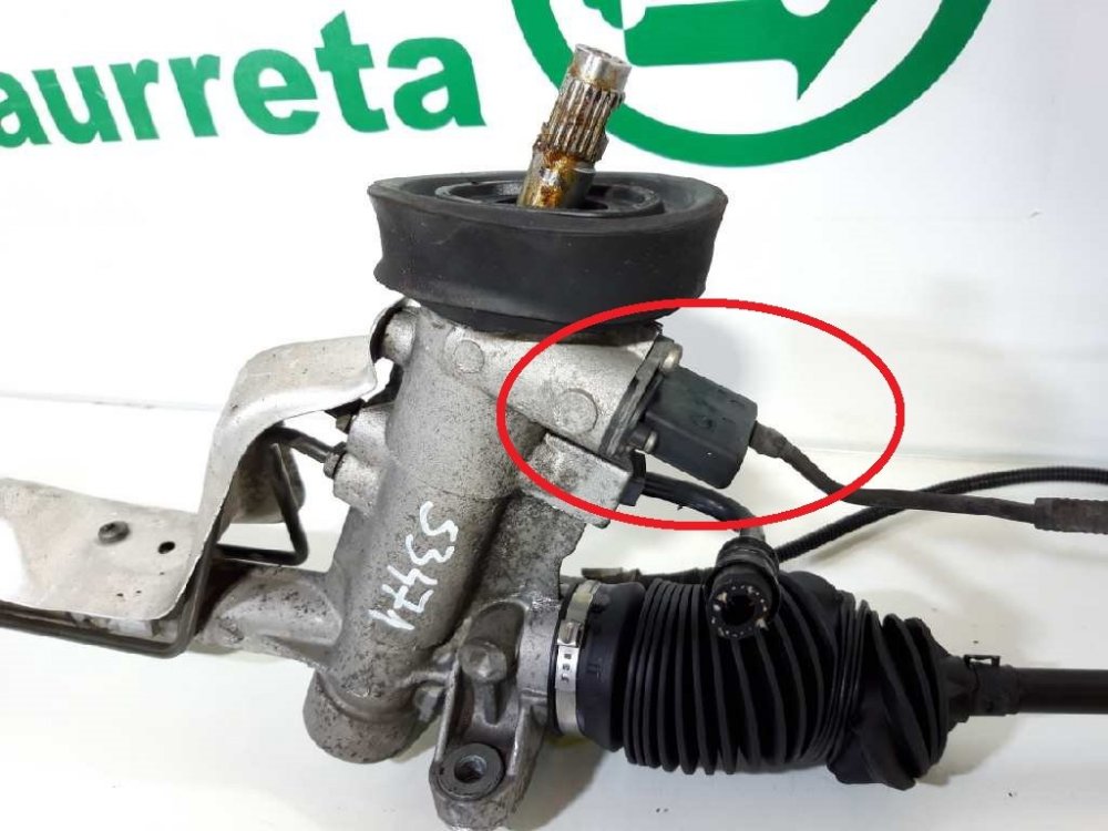

you need to look at where the steering column comes through the bulkhead and connects to the steering rack, thats where the sensor is. You can see it from underneath on the right hand side looking through wheel arch / where the steering rack is.
Below is a picture of where the sensor is (circled) brown ones unplug, the one in the picture is hard wired.
As far as straight replacement, well yes as such, but it does involve dropping down the subframe a little to get the rack out and there is special tools to re-align that when refitting, you could probably get away without them but they do make it easier.
Tool link https://www.ebay.co.uk/itm/222469704639?hash=item33cc3a4bbf:g:RVUAAOSw2gxYwAl7
You also (according to skoda / vw)  need to replace the mounting bolts of the sub frame as they are stretch bolts. You can only really buy these from the dealer/ vw specialists, I'm sure there will be posts added to this where people don't replace the bolts, each to their own on that one, I always have on each rack I have replaced.
additonal you will ideally need new seals for the steering pipes and some new steering fluid offcourse.
