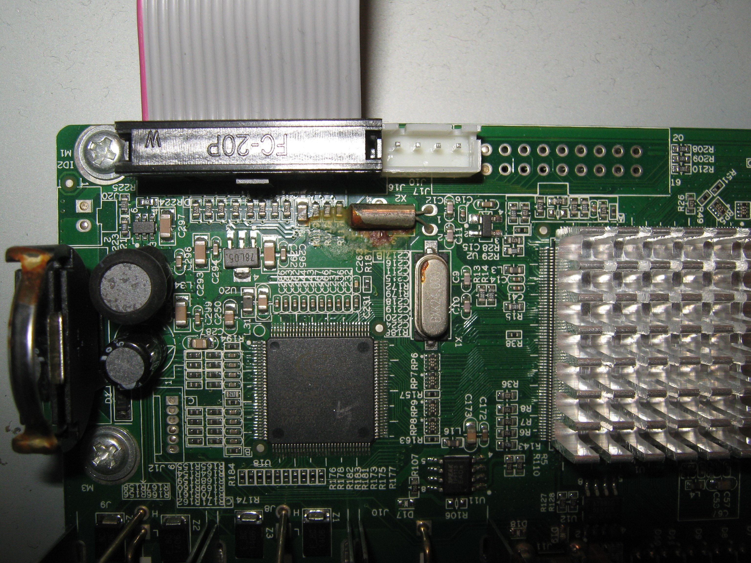

Trying to get it working again.
Unit is showing power light on and cooling fan is running
Cameras (2) are powered up (LEDs lit when dark)
Monitor connected and powered up
New batteries in remote and checked IR signal using camera on laptop
Mouse is lit up
Monitor just shows Home Guard logo - so at least it knows what it is connected to - but I cant get it past this stage.
It's a while since I used it so not sure if it is knackered or if I'm missing a step somewhere along the line.
On line manual makes it look like you just power up and you are into the menus.
Grateful for any suggestions you can offer
I have had a similar issue with another brand a few years back, it turned out to be the hard drive so I swapped that with a cheap one from Amazon.
A few months after that the box would light up but nothing would happen, that was due to the power supply giving up.
The system was about 5 years old at that point so opted to get new equipment as the image quality was far superior.
Edit: Can you get in through the app on your phone and check settings that aren't visible on the monitor?

Should have said, when I first tried to get it going the power supply was dead - tested with a voltmeter - output 0v
Now using a replacement power supply which seems OK
My mobile phone, unfortunately, is not a smartphone. Just about as basic a NOKIA as you can get.
Just noticed although power light comes on and fans start on power up there is no beep - thinking there probably should be.
OK looks like this is the problem - so no easy fix.
Guessing it's a capacitor although no markings.
The button cell is OK - the grotty stuff on it is just something that has been put on to hold it in place
I think it was a capacitor. It is now toast! ;)
Definitely not an easy fix! You can get DVR's relatively cheap and just swap it all over, or use it as an excuse to upgrade ;)
Yes, a cheap new DVR that will use existing cameras and cabling is the plan I'm going with  - just hope they are all OK.
Getting one without a HD and will transfer the one in existing unit across.
Notice some sellers are a bit cheeky the way they don't quite spell out 'no hard drive included' but instead give an option - '+ 1Tb' - left me wondering what I get without the '+ 1Tb'  - Oh I see no storage!  so to my thinking not really a DVR at all. Anyway I'm buying this one in the full knowledge that it will come without a HD
At least that worked and without too much expense or effort. Resolution is poor but it always was. Longer term may go for something a bit better.
