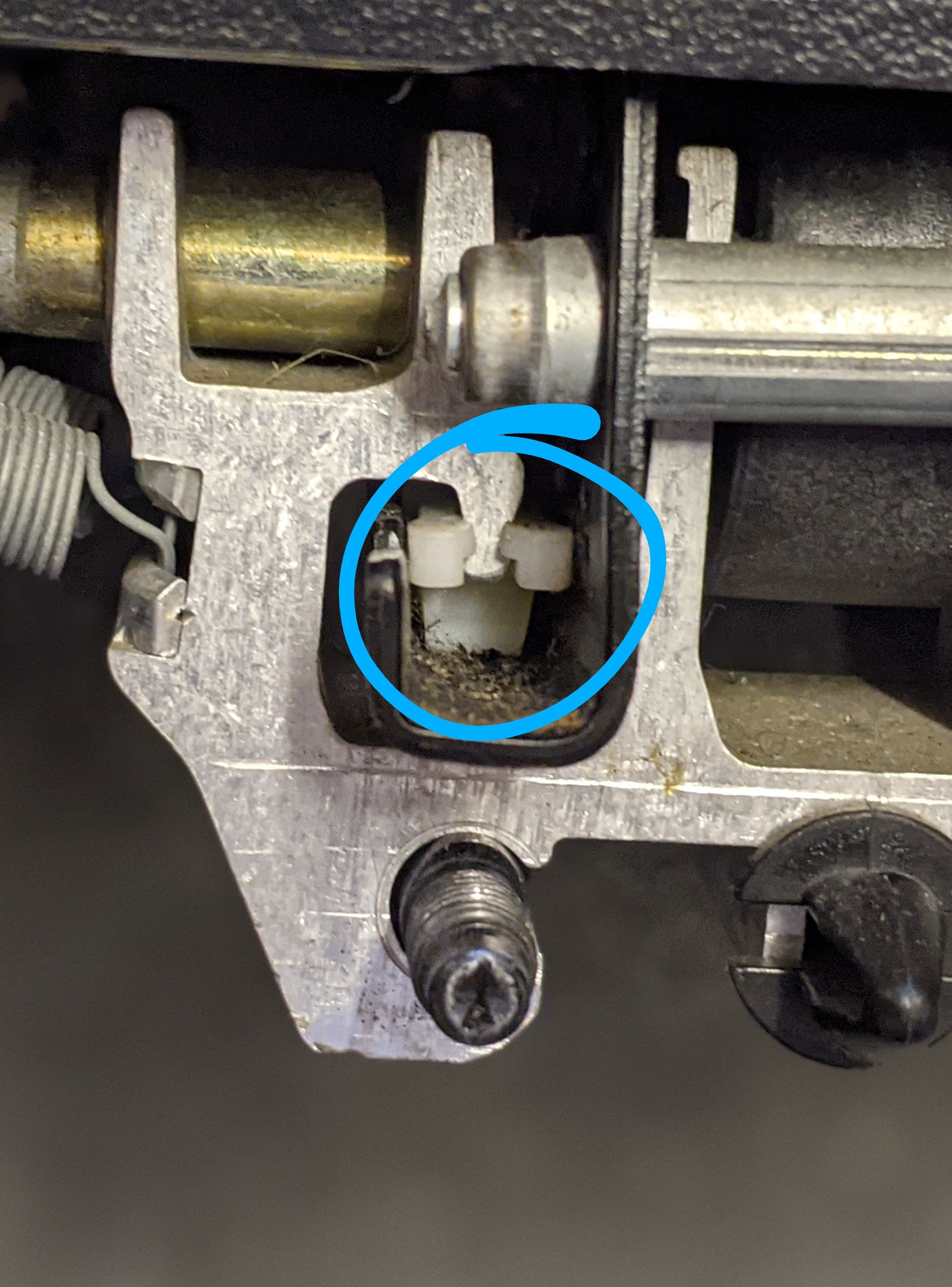

I bought some Recaros for the Octavia yesterday and have found a bit of a problem.  The driver's seat is missing two small plastic parts in the mechanism that allows the seat to move backwards and forwards. This is allowing the seat to rock ever so slightly when you push on the brake or change gear.  It's quite annoying and I wondered if anyone on here could help me with the part number?
I've circled the part on my original Octavia seats as I'm assuming they'll be the same.
Thanks in advance.

I've had a look (after finding my glasses first!) & can't see anything that look like the bits I need.
I've just checked the seat and it looks like there's two different shaped pieces.
I wonder if anyone has a second hand part as it's a shame not to use the seats just because of this.

Is that not part number 8 in the diagram?.
Thanks for the heads up & making me look again.  Having looked more closely and after a bit of Googling, it's looking like part number 16 - 1J0 881 203 A
I'll see if there's a possibility of tracking one down.
Thanks for the help.:thumbup:
