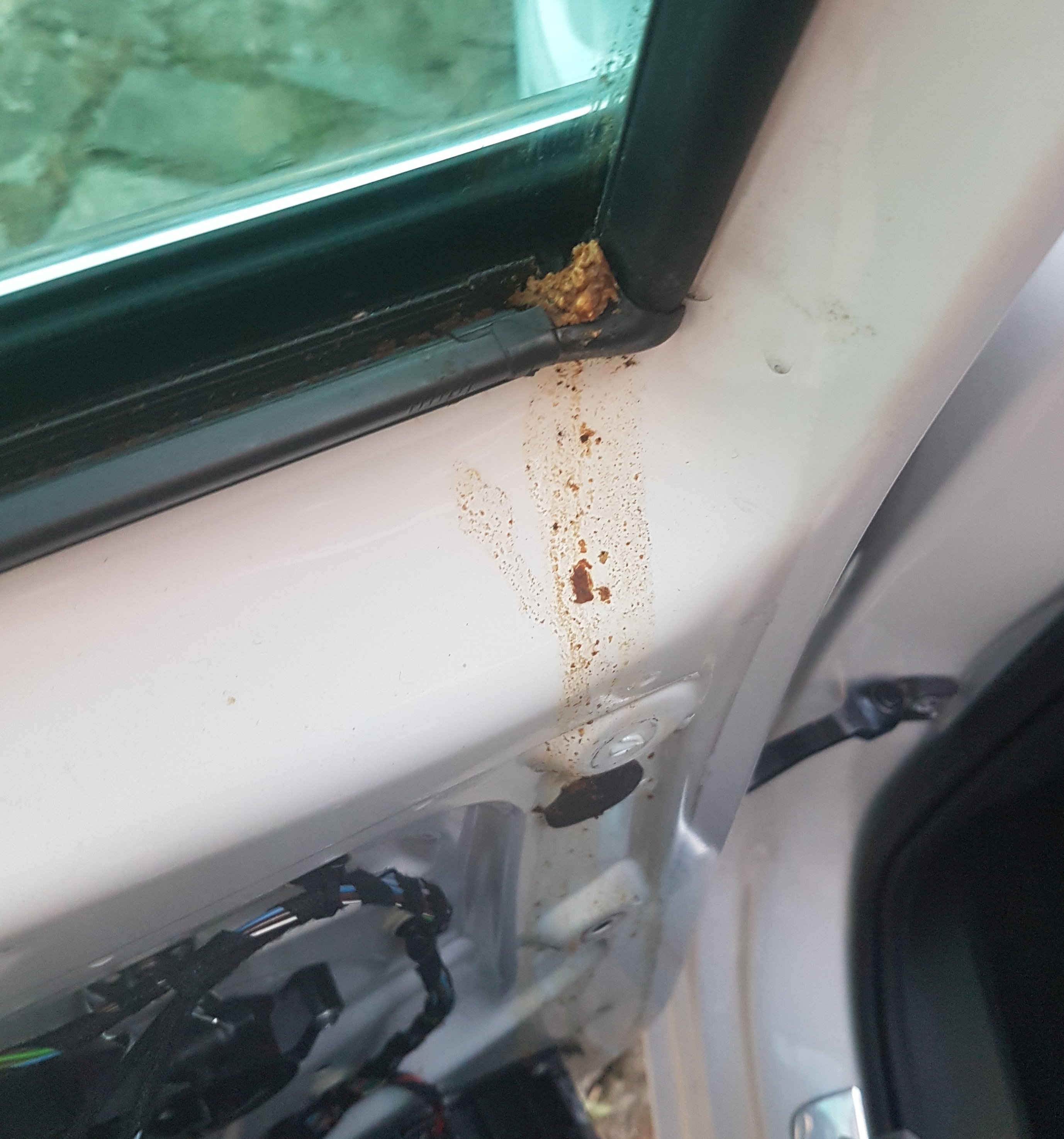

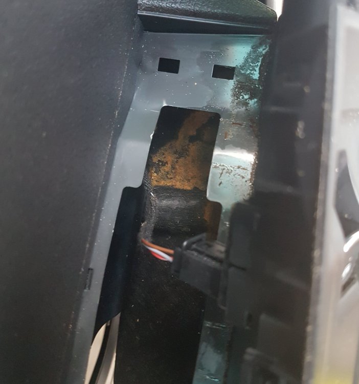

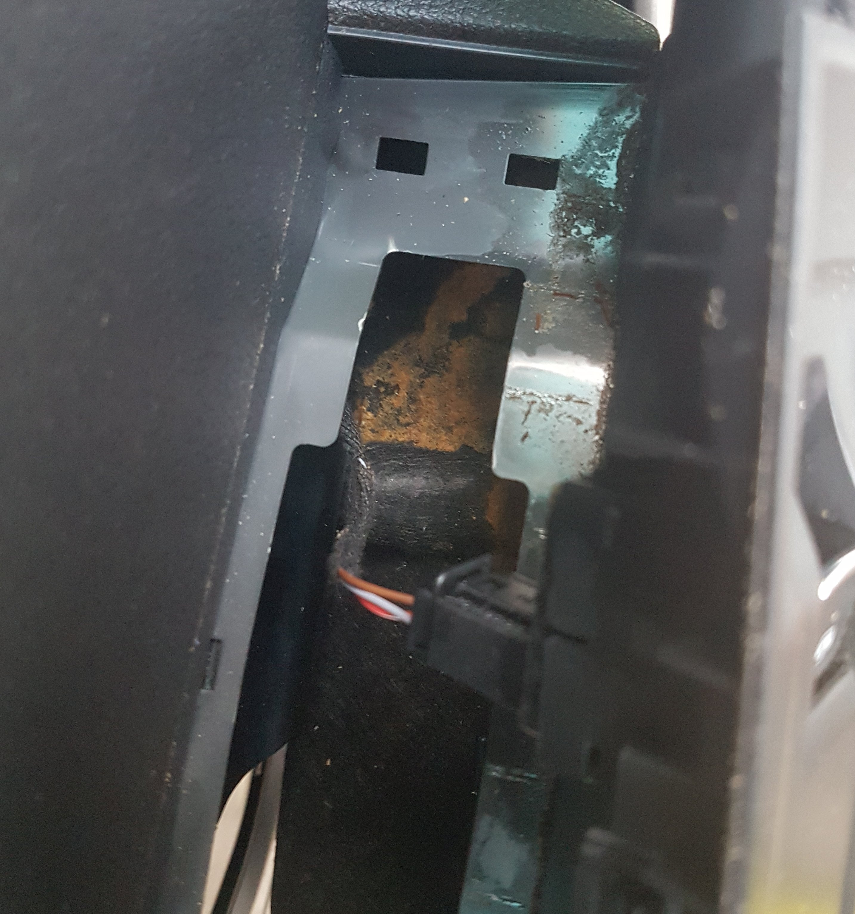

First ride home was a realization moment, to how bad it was. I didn't wasted any time and went straight to work spending next two days deep cleaning whole interior. Removed door trim panels with switches and door cards, front dash vents, all panels around gear knob. Things I found it's not for faint hearted...
So disclaimer: Pics contain gross content 😅 (yeah it's puke)

To my surprise original cigarette smell was all gone completely, but ozone generators leave this quite strong acid/ vinegar like after-smell, which should go away in few days (suggestion would be sufficiently venting it afterwards). Might be that car cleaning products can get rid of it instantly, but I wanted to find out how long it takes to go on it's own.
So 4 days since using ozone generator I can confirm, that it worked 🥳 It got rid original foul smell and apart some vinegar after-smell (very light) car smells like a new. 💪
