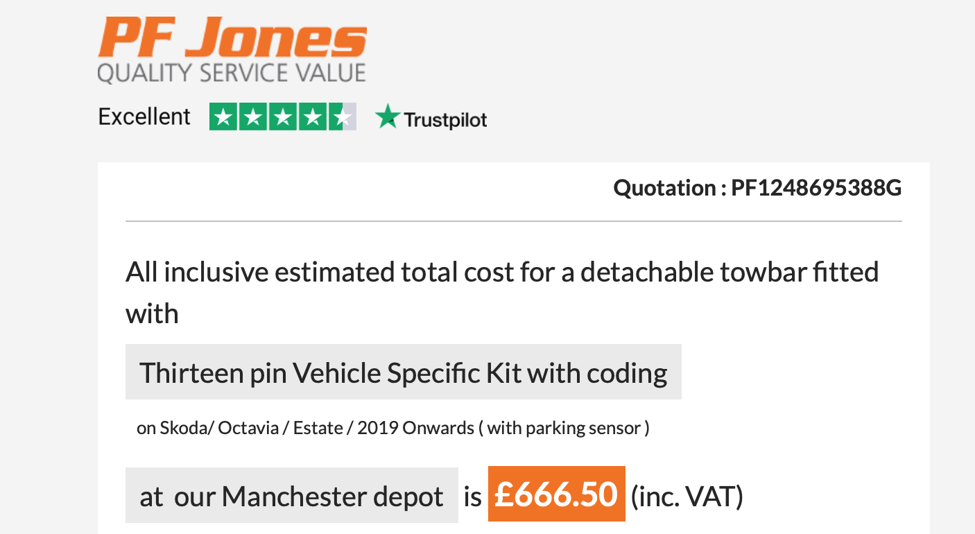

It seems complicated and costly to get a tow bar fitted.   The electric shave to disable the rear sensors and the towbar has to be detachable.   Has anyone had one fitted successfully.?

Ordered my 1.5 SE L TSI Estate on 28 Aug .
Quoted £412 .50 for removable tow bar inc fitting .
Is that from the main dealer or a tow bar fitter?  My Main dealer wanted about £1200

Main Dealer ....I have bought three new Skodas from them .....they know what they are doing...they have supplied my current Octavia and previous Yetis all with tow bars and programmed the electronics and in the case of current Octavia the rear view camera without any problems .
I have just found paperwork for current Octavia ....price of fixed towbar was £329 .17  inc fitting Programming and so on .

Which main dealer was that please?   my main dealer said their rate per hour was £120!
