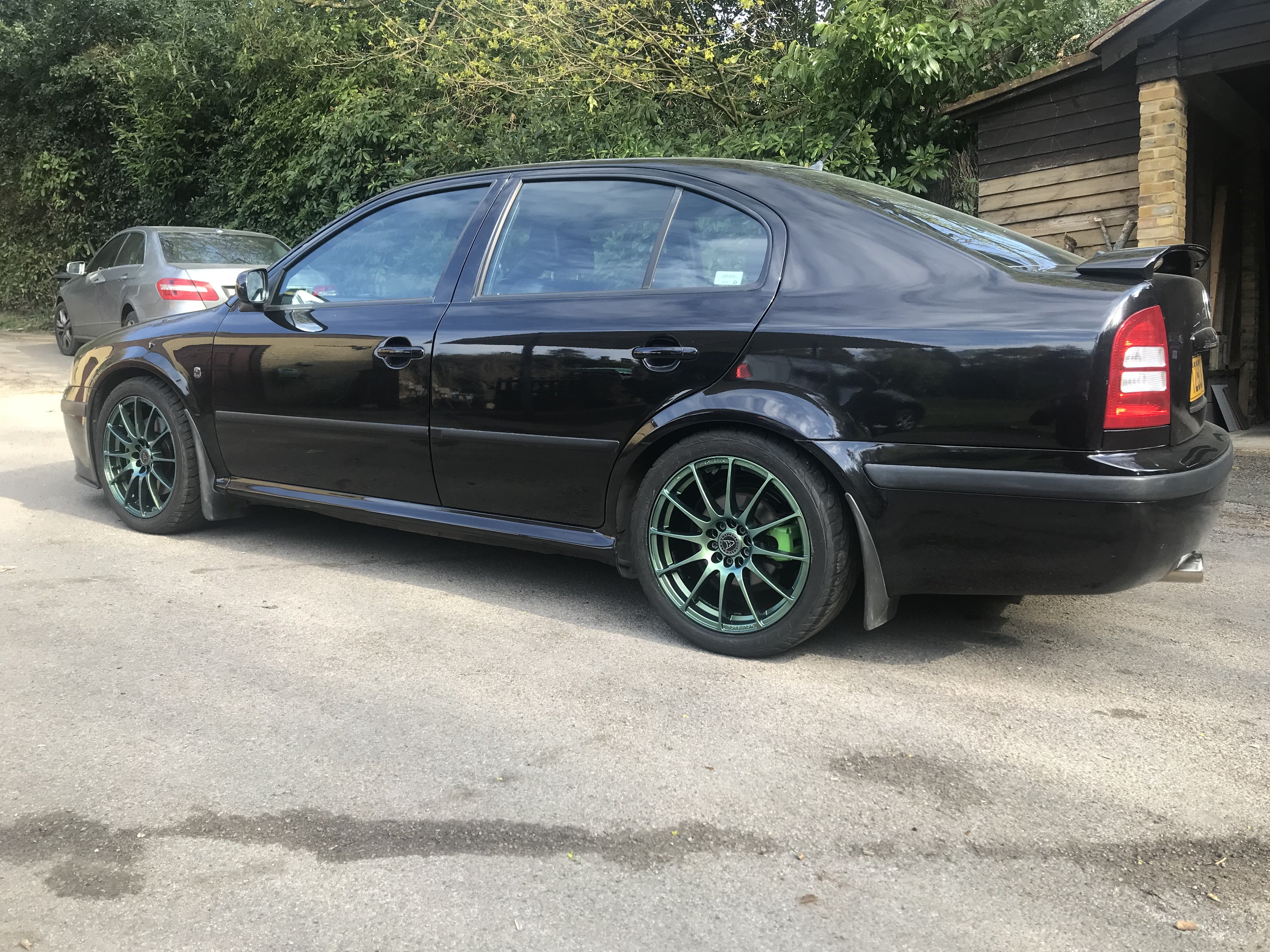

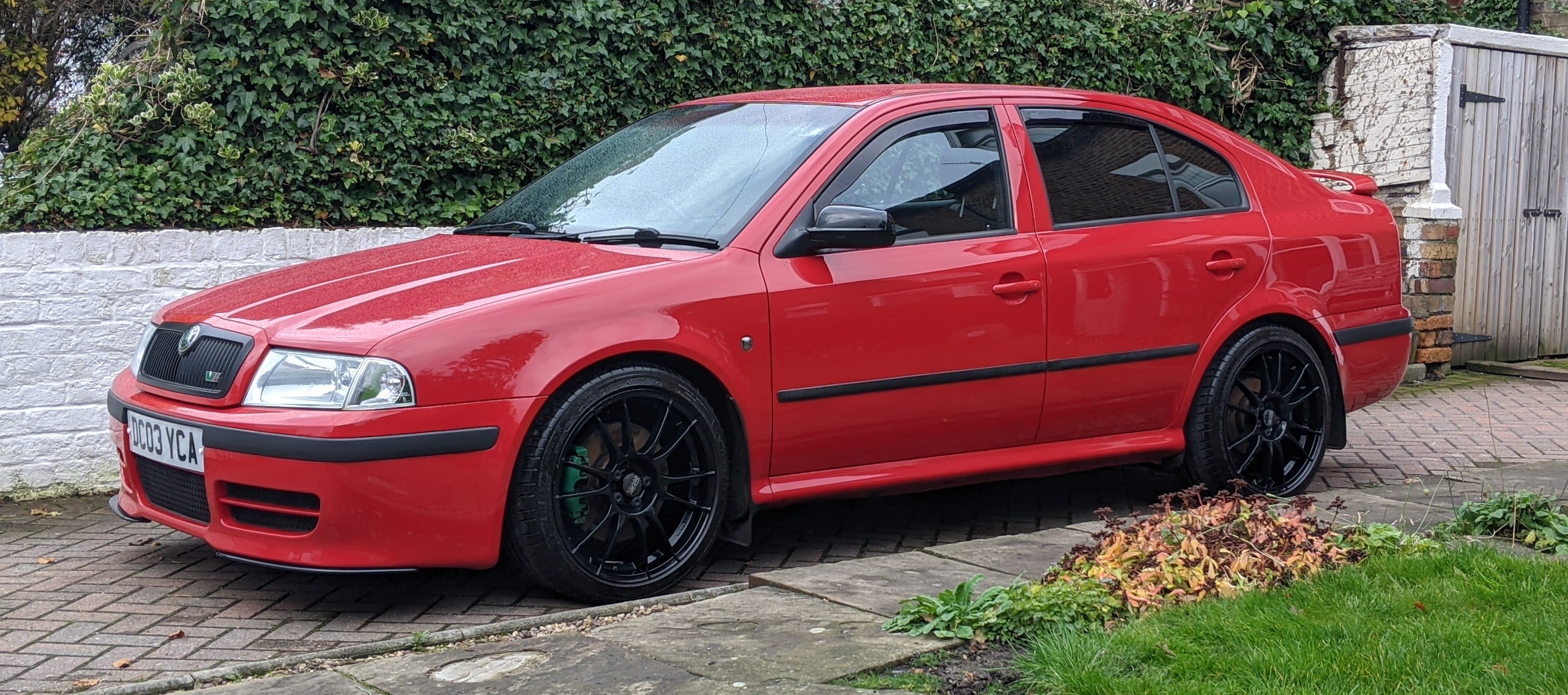

I'm currently on 225 40 18 Michelin PS4s on a set of OZ Ultraleggera for my daily wheels.  They are really light wheels and combined with the PS4s, they are a great combination giving surprising levels of grip.  Admittedly the current cold weather doesn't suit the tyres but for most of the year they are a good all rounder.  I'm pretty sure the OZ wheels are 8j and have an et of 45.  I'm running them on 10mm spacers on the front and 15mm on the rear with no rubbing issues I'm aware of.
I've also got a pretty much mint set of TD pro Race 1.2 up in the spare room with a set of Rainsport 3s on.  They're 17" and again are really light with 225 45 17 tyres.  They weren't run with any spacers on and I always wondered if they needed to be brought out a little.
I only changed to the 18" wheels as they popped up in ebay at a price I couldn't resist.  They aren't cheap but definitely do help with the handling.  The Pro Race 1.2s are also a really nice wheel and I'm tempted to go back to them at some point.
I've put a couple of photos below so you can see how the car sits on both sets.

The wheels with spacers on your car in the second photograph seem to be of similar ET as my Wolfrace wheels.
I am sure spacers are okay for the road but I would not use them on track. Every corner is on the max with huge strain going through the front offside wheel, hub and suspension.

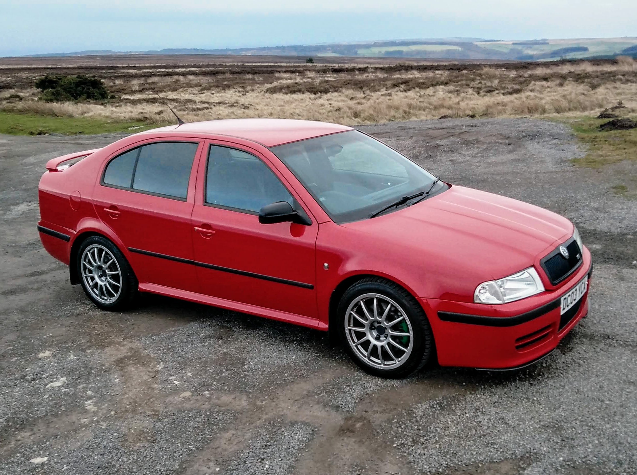

225/45 on your wolfrace, or 225's on your spiders will work just as well, ran 225/45 on my spiders for many track days, spiders are light compared to most other VAG wheels, 9.3KG from memory,
I weighed one of my Wolfrace wheels with an Accelera track tyre and it was 17 kg.
I weighed a Spider with an all seasons Bridgestone tyre fitted and it was 19 kg.
I would guess that the track tyre is heavier as they have much stiffer sidewalls. I guess that is why they call the Wolfrace wheel a Pro-Lite!
