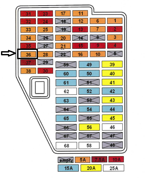

Hi all I hope some one can help me I have a 2006 mk1 Fabia vrs and the speedo back ground doesn’t light up green when lights are on. Either does the heater dials or radio buttons I’ve changed the dimmer switch and light switch and still the same I’ve also checked all the fuses and they are all ok any help ?

Aye they were new parts  and fan heater works and fog lights everything works in car except the speedo back ground lighting up heater dials lighting up and radio buttons but the heater a/c light works and so doe the circulation light

One more question for you: Do your numberplate lights work, and if not, have you checked/changed fuse 36?

Ye checked that fuse and is ok and number plate lights work
All fuses are ok
  • Sponsor
Must be a broken wire coming out of the dimmer then, I think.
