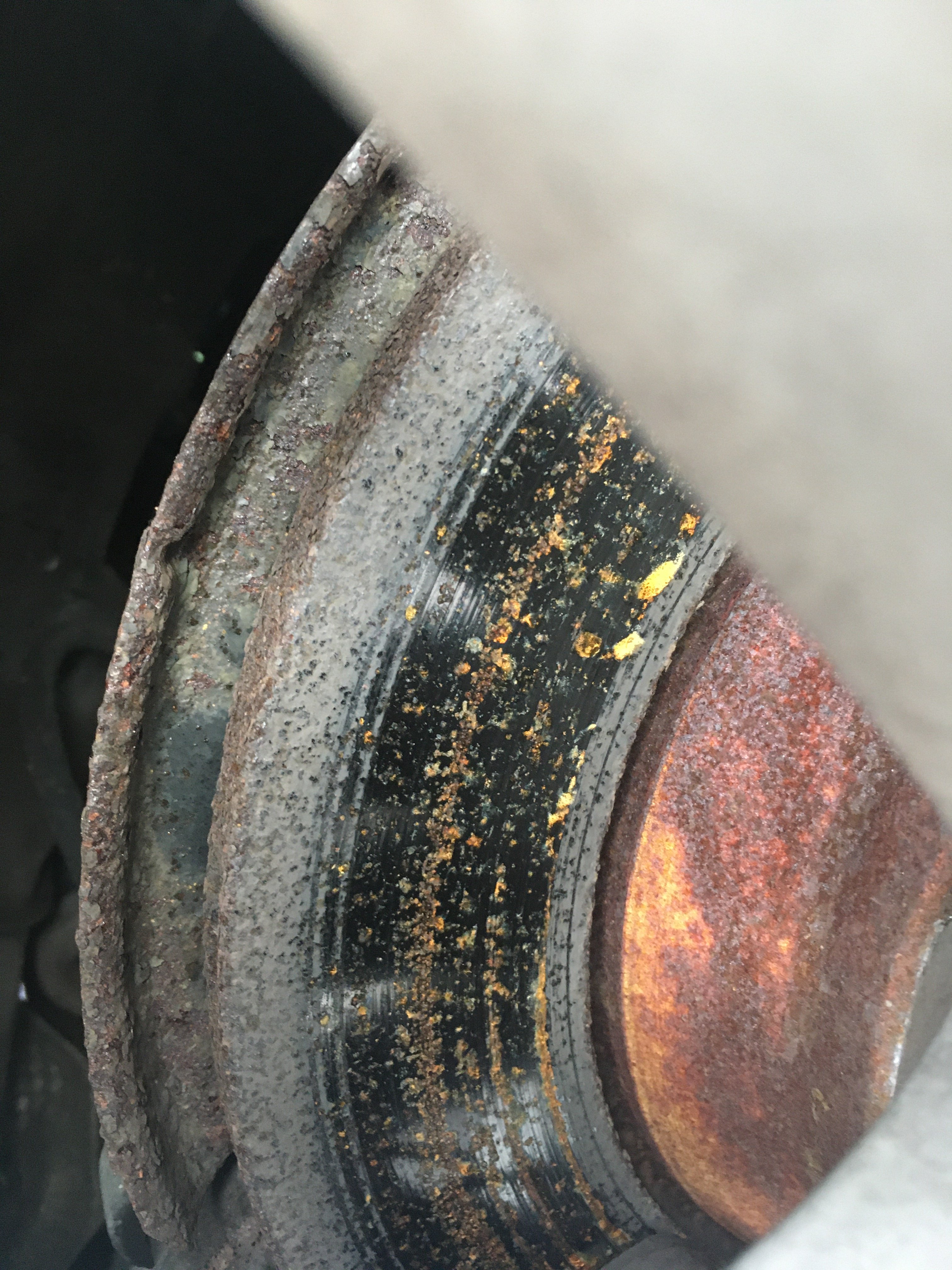

My rear discs and pads need changing as too rusty and pads waffer thin.  I'm thinking of getting Brembo discs (300mm) as they have the painted hubs in black, so no more rusting hubs apprantly. I know some people say go Pagid, but are the hubs painted on those?  I don't mind going Pagid pads with Brembo discs if it's really worth it, or shall I go to Brembo discs and Brembo pads?

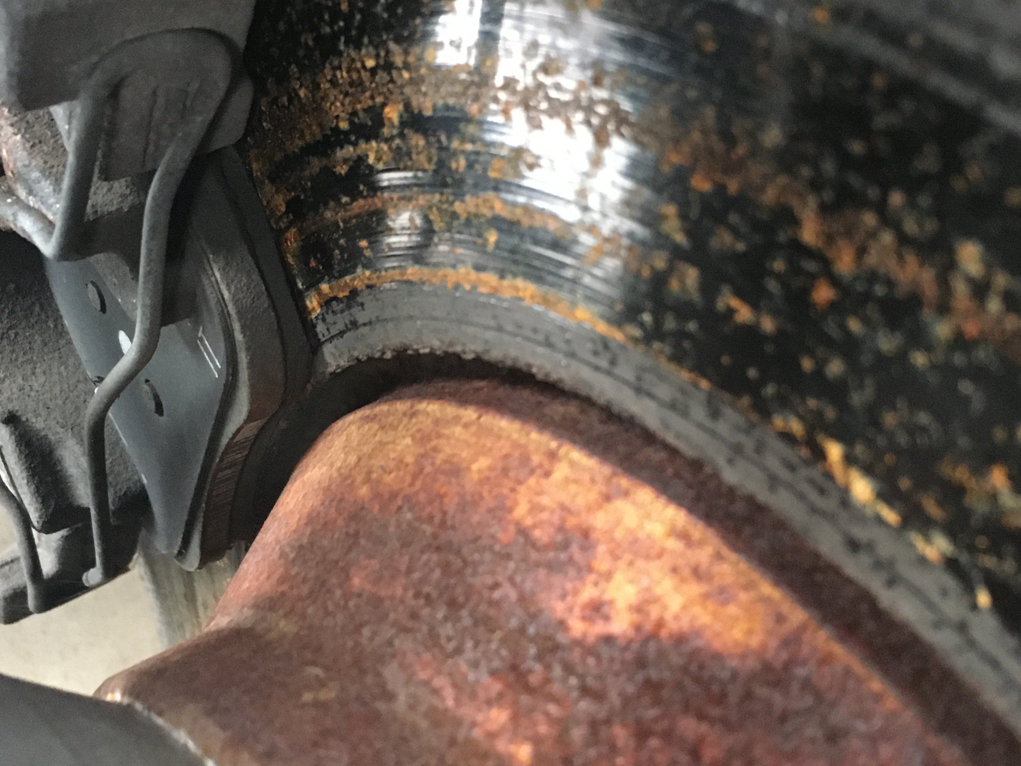

This is the state of mine and how little it actually bites down and pads quite, it’s done around 39k miles.
Hub rust is the worst annoyance as it’s so visual
You said it; there's still a good 10_000 miles on the pads, but with that rust the discs are goosed. Also, from my experience, painted bells won't help after a year or so.

If you look at the pads they don’t look flat in places, it’s odd.

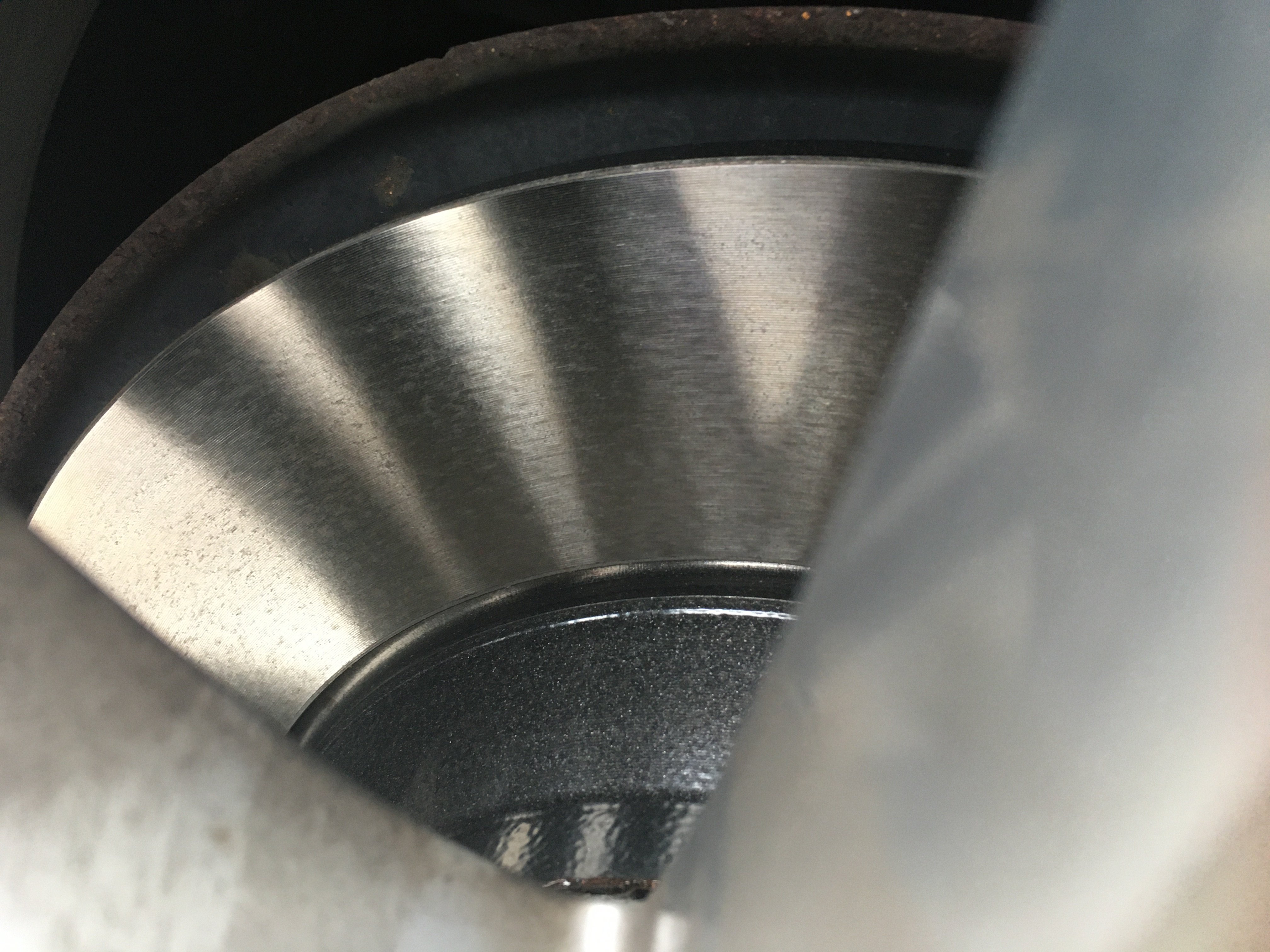

So I’ve gone for Brembo discs (08.C501.11 made in Italy) and genuine pads.
The more I read about pads from other manufacturers the more I got put off from various posts here and elsewhere.
I would have gone ATE rear pads but ECP don’t sell them (they sell fronts)  for some reason nor does many other places where I can pick up locally.
My local dealer will be fitting my supplied discs and genuine pads on Thursday as I really needed it done this end of the year.

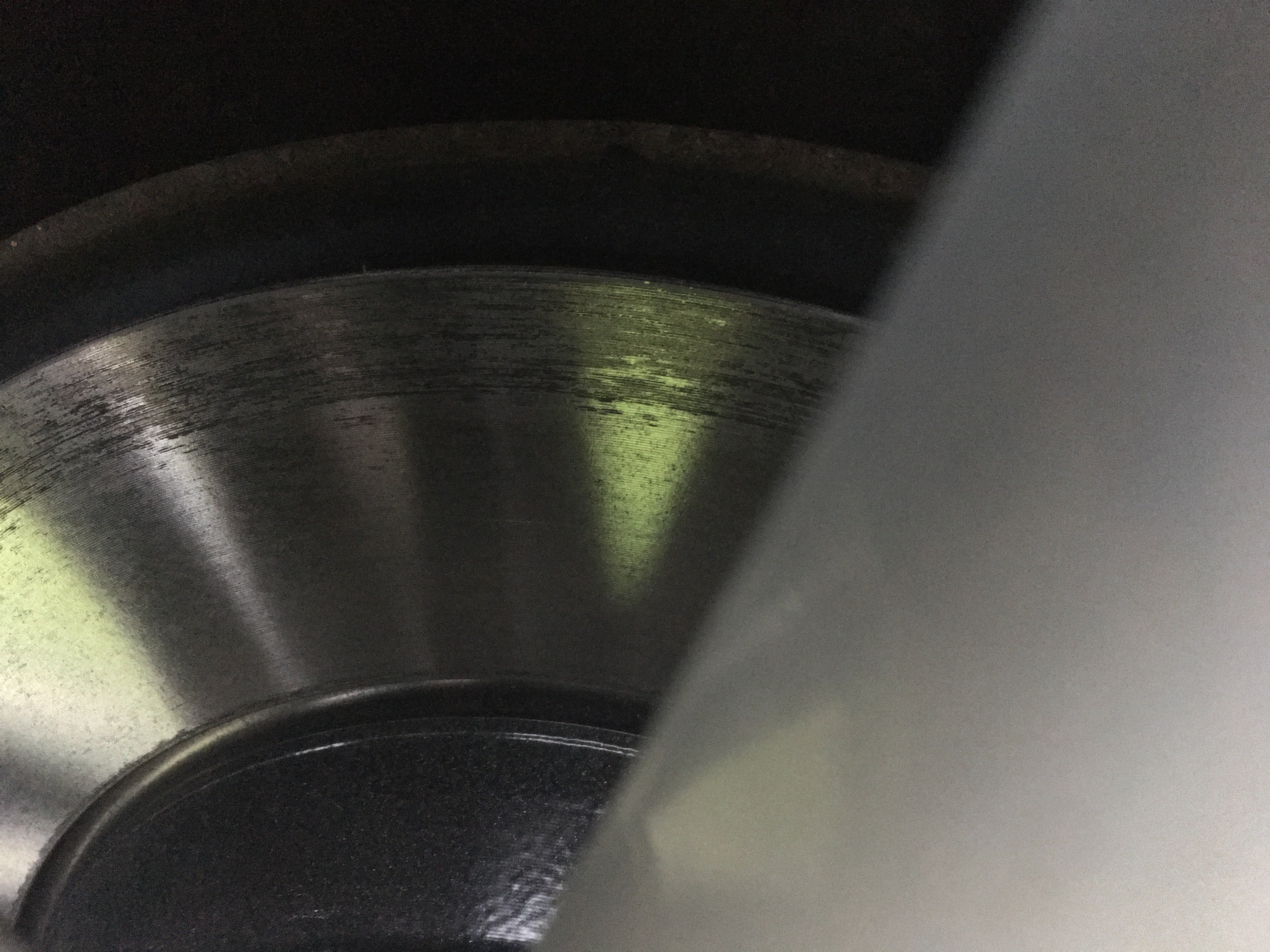

Brembo discs and genuine pads on, now I have good braking all round I’ve noticed the car doesn’t pitch forward and feels so much more stable.
Yesterday when I picked it up I did have some black marking, but I literally drove 3 miles home, which I was somewhat concerned at
So today I went on a longer random jolly, so I put it in eco (DSG) and ACC, seem pretty perfect now, so no idea what the black stuff was
From seeing other brembo discs the coating should last many years instead of rusting up on the hub
