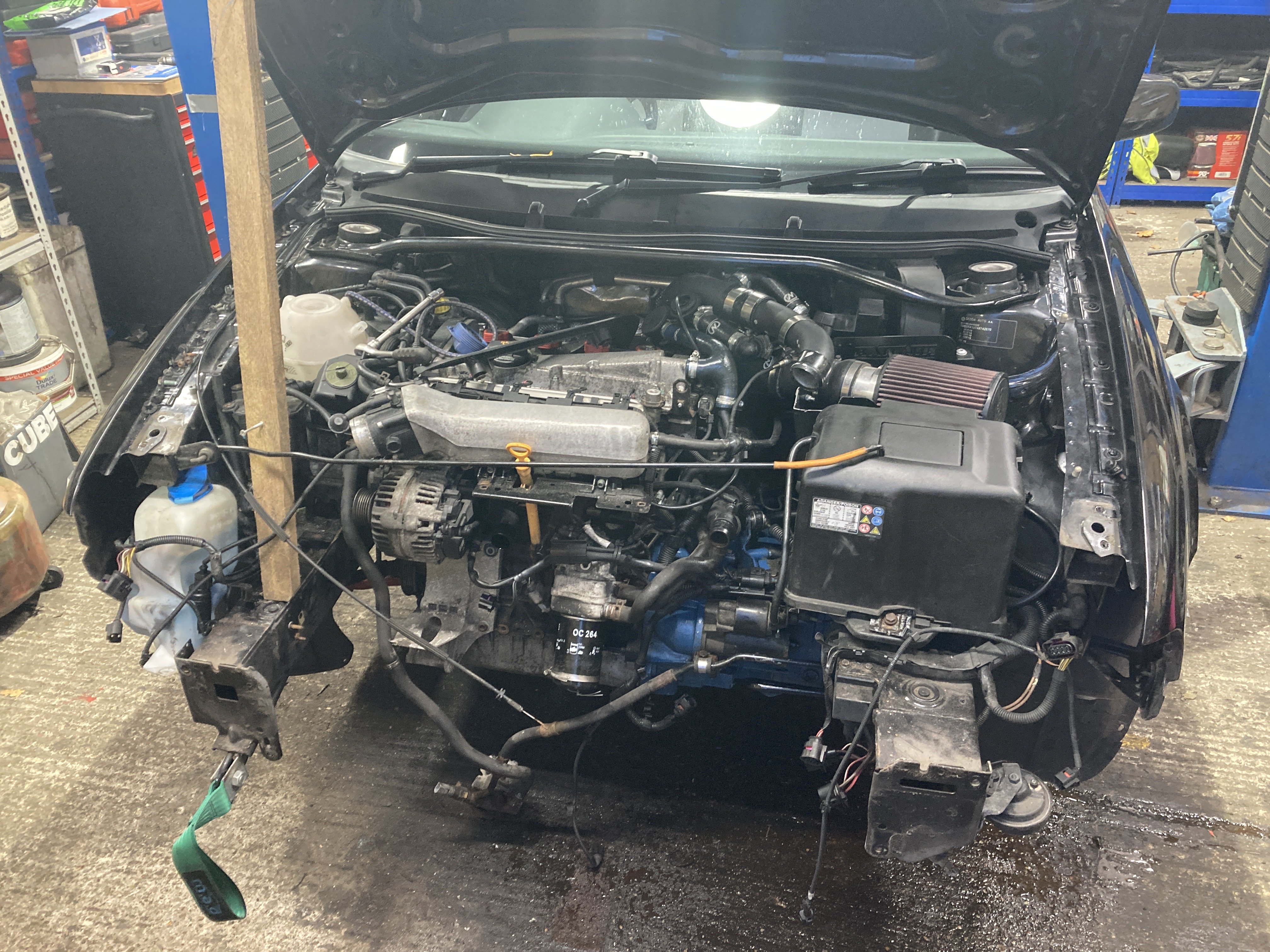

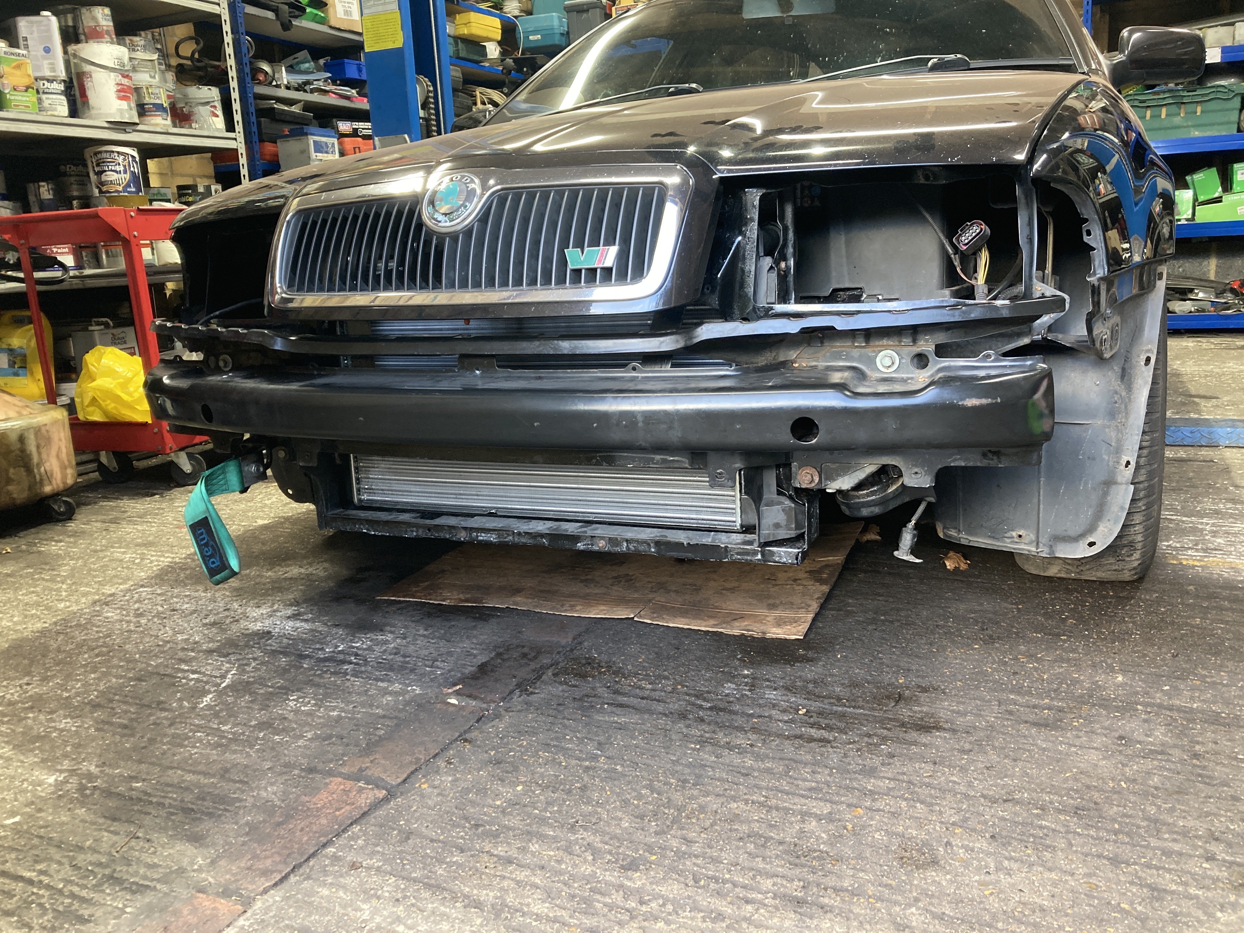

Pictures of before crash bar removal and after prior to clean up and any work. Obvious once centre section is removed, there aint a lot of protection left!

1 or 2mm is not a measure of temperature, do you mean 1 or 2° it seems that you are talking about water temperature with the reference to the radiator, the temperature guage is fiddled to read 90°c over a very wide range of actual coolant temperatures, what you should be concerned with is the oil temperature which is far more important than water temperature unless the engine is boiling over.
Removal of the crash bar will reduce the torsional stiffness that no amount of silly strut braces will replace, if you really want to improve the airflow to the radiator then remove the AC condensor.
drill some holes into the bumper bar around the same size as the 2 that are already on there, got to be better than narrowing the bumper bar
