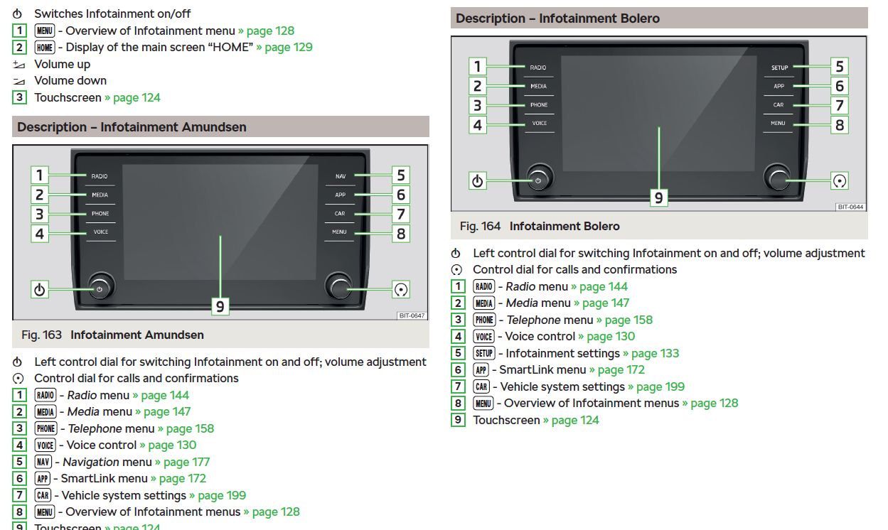

I don't know the model of my head unit but it's either a  "Amundsen" or "Bolero" in the manual they both look the same

Edit: I see the difference, it's an Amundsen

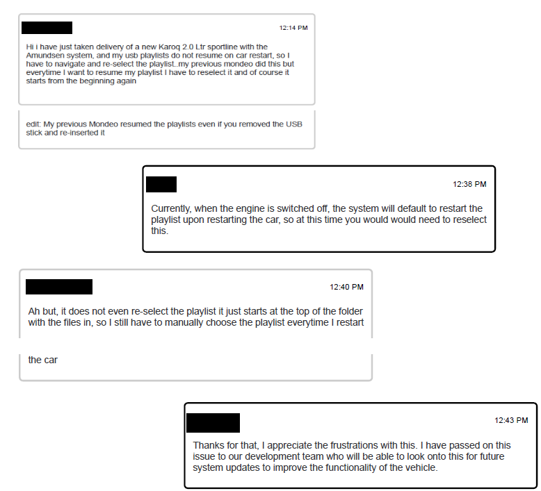

I have just Live Chatted with someone from Skoda Customer services.
And Basically they said that this is the way it currently works, Playlists do not resume on engine restart and you have to reselect every time and they have had a word with the "Development Team" and if they fix it - it will be done in a future update via the dealer .
Here are some edited screen shots, forgive my grammar, and spelling but I was working at the same time
I know it's trivial, but something that is marketed as quality (perhaps) or even "Clever" this is a basic function of every media player.
